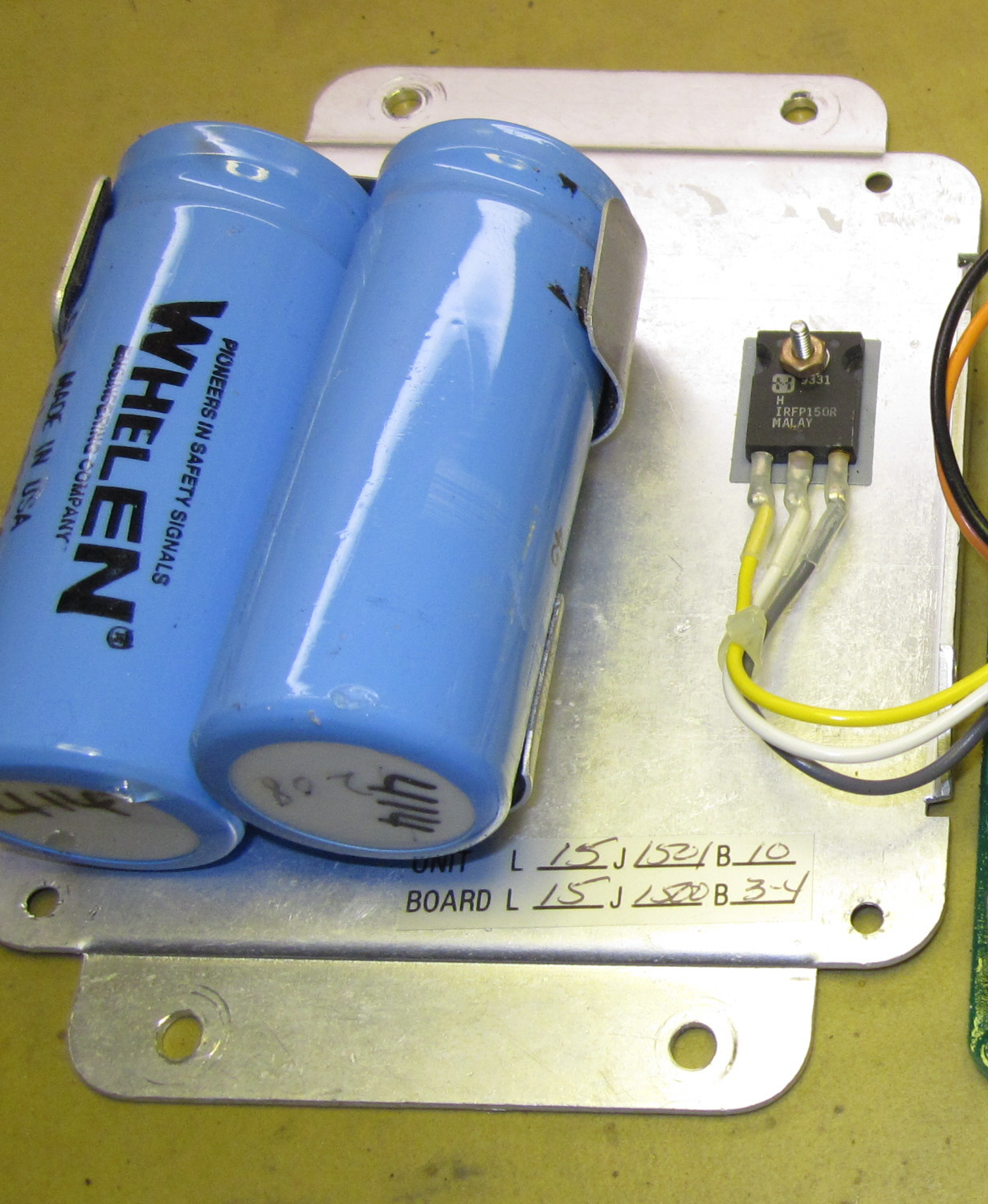

Does anyone have firsthand experience replacing the Whelan 51-3361401-42
capacitor assembly in a strobe power supply? Specifically, can you give me a
DigiKey, Mouser, Allied, etc. part number for a suitable photo flash capacitor
substitute based on firsthand experience?
The Whelan parts (and complete assemblies) are crazy-expensive. It's enough to
make me change out the entire system to LEDs Sad But I'd really rather just
repair the power supply and keep on flying.
Joe
Independence, OR
Independence, OR

Consider patching "non flash rated" capacitors
in. The worst that happens is that they don't
last as long as the original parts. But as long
as you can do the work yourself, the price differences
might make the shorter service life an attractive
alternative.
Can you read capacity and voltage values off
the parts?

There are no markings other than a "Whelen" brand name and part number. But a
web site selling replacement parts gave me a tip when it called them 400uF at
360WVDC. There are two of them in series and I measured 230VDC across each so
that 360 WVDC rating seems reasonable.
I "patched" in a couple of junkbox 470uF/450WVDC capacitors. Alas, the power
supply still does not work. Upon close examination I now see some charred
components and a swelled filter capacitor in the low voltage section. Rather
than make the huge effort to reverse engineer and fix it, I think I'll buy a new
Nova power supply for under $100 and move on.
Thanks for the idea, Bob. I'm attaching a picture of the HV capacitors if for
no other reason than to to satisfy peoples' curiosity.
the power supply still does not work. Upon close examination I now
see some charred components and a swelled filter capacitor in the
low voltage section. Rather than make the huge effort to reverse
engineer and fix it, I think I'll buy a new Nova power supply for
capacitors if for no other reason than to to satisfy peoples' curiosity.
Under the circumstances, probably the most economical
solution. If you have no plans for the carcass I'd
like to have it. I'd pop for the packaging/postage.
I've not had an opportunity to peer into the inner
workings of this product for many moons.
