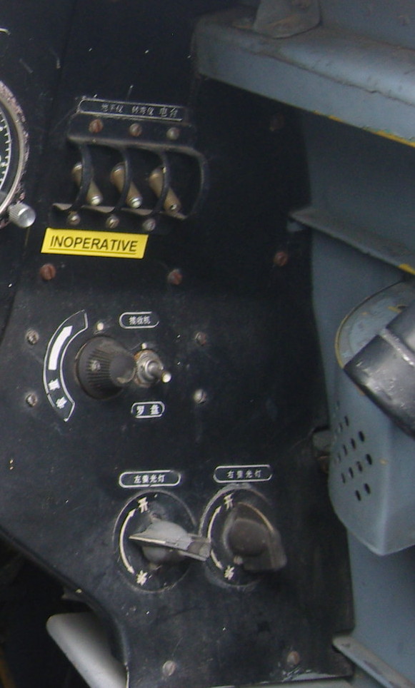

Hello every CJ6A owners,
I have a question regarding the switches and knobs on the back seat cockpit panel: What are they for?
I think the first switch on the left is for the back electric gyro but the gyro don't come in a neutral position.
If the knobs have no action on any thing , can i remove them?
Best ,
Bruno

The 2 lower knobs are for cabin/panel lights. I think they are "black light" so you can only check their function at night.
The other knob looks to be labeled as "volume control" but I need a better picture to read the label to be sure. The switch to its right is labeled "Receiver" on top and "Compass" at the bottom; I guess it is the selector switch to select between radio transceiver and radio compass.
