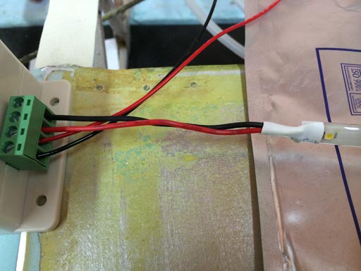

Last month I ordered a 5 meter string of white LEDs ($9.25), a power pack/dimmer unit ($2.97) and a pack of 4 extra connectors ($6.50) on Amazon. Needless to say, they shipped from China and they took about 2 1/2 weeks to arrive here. The LED string is supposed to be weatherproof and it has an adhesive backing with peel-off cover/protector. One end is provided with red/black pigtails for connection to the power pack/dimmer:

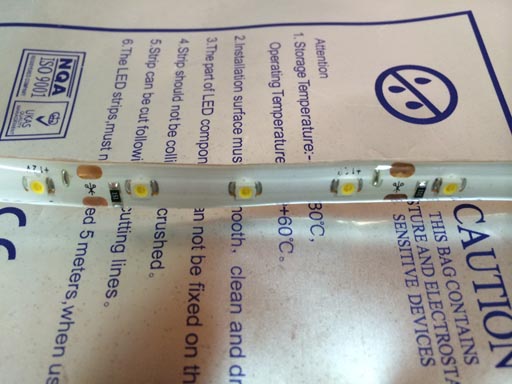

The string may be cut to length every three LEDs. You can see the scissor symbols where cutting is permitted. Also available are connectors to attach to the end of the cut-off section of string to allow them to be used. I have a pack of those connectors on order but they have not arrived yet.

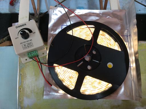

The connection to the power pack/dimmer is simple and I connected the power pack to my power supply for testing. The power pack/dimmer is for use with 12v-28v DC. I set my power supply to 12v to check it out. With the power pack/dimmer set to minimum power there was a surprising output of light with a current draw of 0.1A.

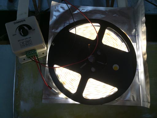

With the dimmer turned to max brightness the light output was impressive and only 1.5A of current draw.
