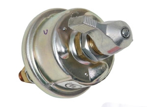

Hi Steve,
It's been a long time since we've chatted.
Consider this item from Summit Racing
[img]cid:7.1.0.9.0.20131209105836.012a10e8(at)aeroelectric.com.0[/img]
It's their SUM-G1432
It's 'rated' with some pretty sedate currents
as a switch . . . but your switching requirements
are benign also. I'd bet this switch will CARRY
the starter currents just fine.
In any case, the price is right (about $20) and
the size is attractive too. There's also a Moroso
74101 that is about the same size and RATED for
much greater currents. A tad more expensive too
at $45 but almost certain to be suited to
the task. See:
http://tinyurl.com/kj5jwba
