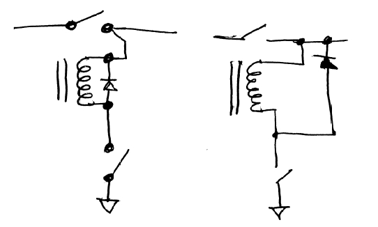

As you evolve your plan for this airplane, consider refining
your drawings to be less like schematics and more like wiring
diagrams. If you study the drawings I've posted you will discover
that they look more like the sketch on the left where the
END of each wire, i.e. the location of each termination is defined
both electrically and physically.
Schematics are entirely suited to describing how a
thing works but its a good idea to include information
on just how it all goes together too.

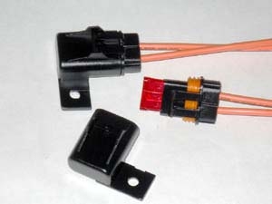

The breaker in the alternator b-lead can be
replaced with an in-line, fuse holder . . .
[img]cid:.1[/img]
and 30A fuse. The b-lead fuse can then
be located right next to the battery's
connection with the battery contactor.
By replaced, do you mean I should add a fuse between the Dynamo and the Voltage regulator? I don’t currently have a fuse on the b-lead, I don’t think.
I’m confused… I thought the b-lead is wire that goes between the dynamo and the voltage regulator. How can it be connected to the battery contactor?

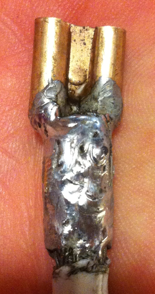

By the way, (this is a followup from a previous thread on contactors), I managed to solder some 4AWG wire onto the 3/8” faston female connectors so that I can connect my battery to the automotive cube relay and use it as a master relay as per the proposed diagram. Attached is a picture of the result…
it’s not the best example of workmanship, but it seems robust enough to me (though this may be difficult to judge from the picture). It will now be covered in shrink tubing for strain relief.
