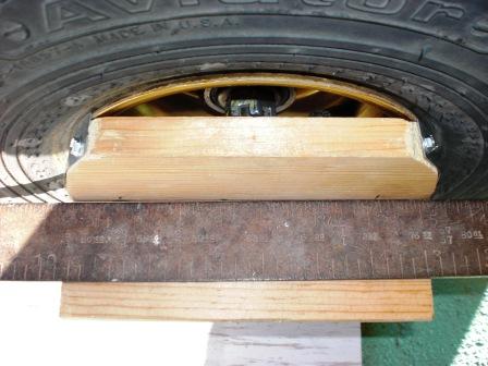

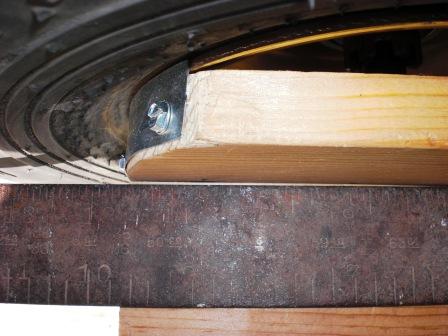

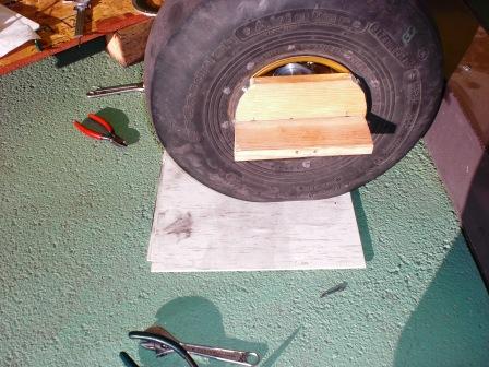

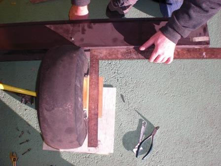

all the measurements were made with the wheels on a grease plate, I was too cheap to buy aluminum plates to put grease in between.... so I used some pieces of floor tile. if I rolled the wheel on the floor tile... sometimes it would break off the edges of the tile... so I had to jack up the wheel and place the floor tile under the wheel. it was amazing how much movement there is in the gear with the wheel on the grease plate. don’t try the adjustments with the wheel on the floor, there is too much friction and it would be extremely hard if not impossible to get where you want to be.
if I was going to install gear again.... I would use the strait edge method with a carpenter square with both wheels on grease plates. to keep the gear from going too far into the gear sockets, I would put in a piece of wood dowel in the gear socket followed by the gear. I would do all this with the engine mounted, and a hundred pound of wheat in both seats.
