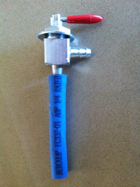

Gidday,I am interested in installing a fuel sight gauge for "PRE-flight" interpretation. I am wondering if there is any recommendation that makes the setup more effective or accurate. I'm also wondering if there is any value in having two small ball valves to be able to isolate it, both in a rollover or to simply turn it off. I am using flexible Aeroquip fuel hose, and will be using a fuel computer as my primary means of knowing my fuel state, PLUS, I have a Fuel tank capacitance gauge. Maybe with the capacitance I don't need a sight gauge at all, but I have the plumbing in my fuel tank outlet fittings, so it seems sensible to use it. Any help much appreciated.
Tony Renshaw
Sydney Aussie
This is a picture of the small valves I "could" use, and the 1/4" ID line I intend to use on a sight gauge setup.
[img]cid:80C4C146-DAAB-4F04-9721-B143BEB18999(at)optusnet.com.au[/img]
 Filesize:  100.31 KB
 Viewed:  6653 Time(s)

On 27 Nov 2013, at 3:36 pm, Tony Renshaw <tonyrenshaw268(at)gmail.com> wrote:
Gidday,
Tony Renshaw
Sydney Aussie
<IMG_6863.jpeg>

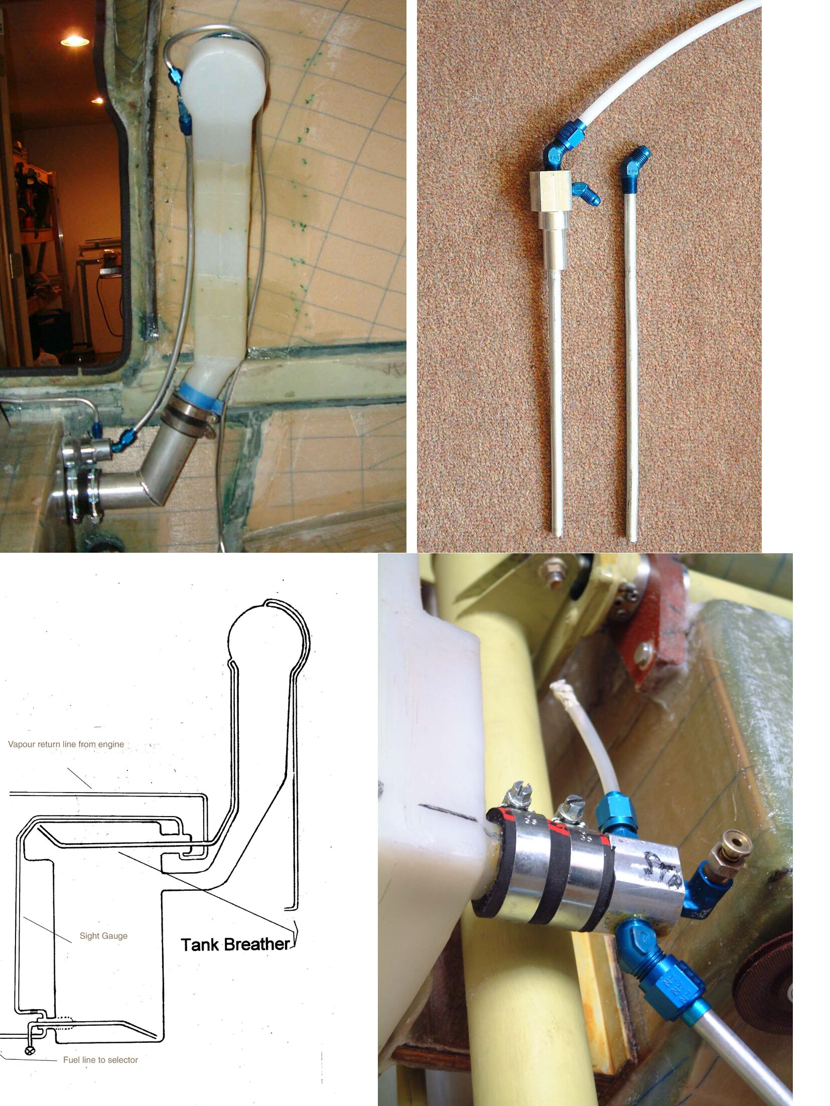

PostPosted: Wed Nov 27, 2013 3:01 am    Post subject: Original Sight Gauge Replication Reply with quote
Tony
have a look at this, works reliably. The large breather pipe helps filling too, the air can get out easier
unlike the standard 1/4" pipe which causes fuel to splutter out of the filler.
Graham
