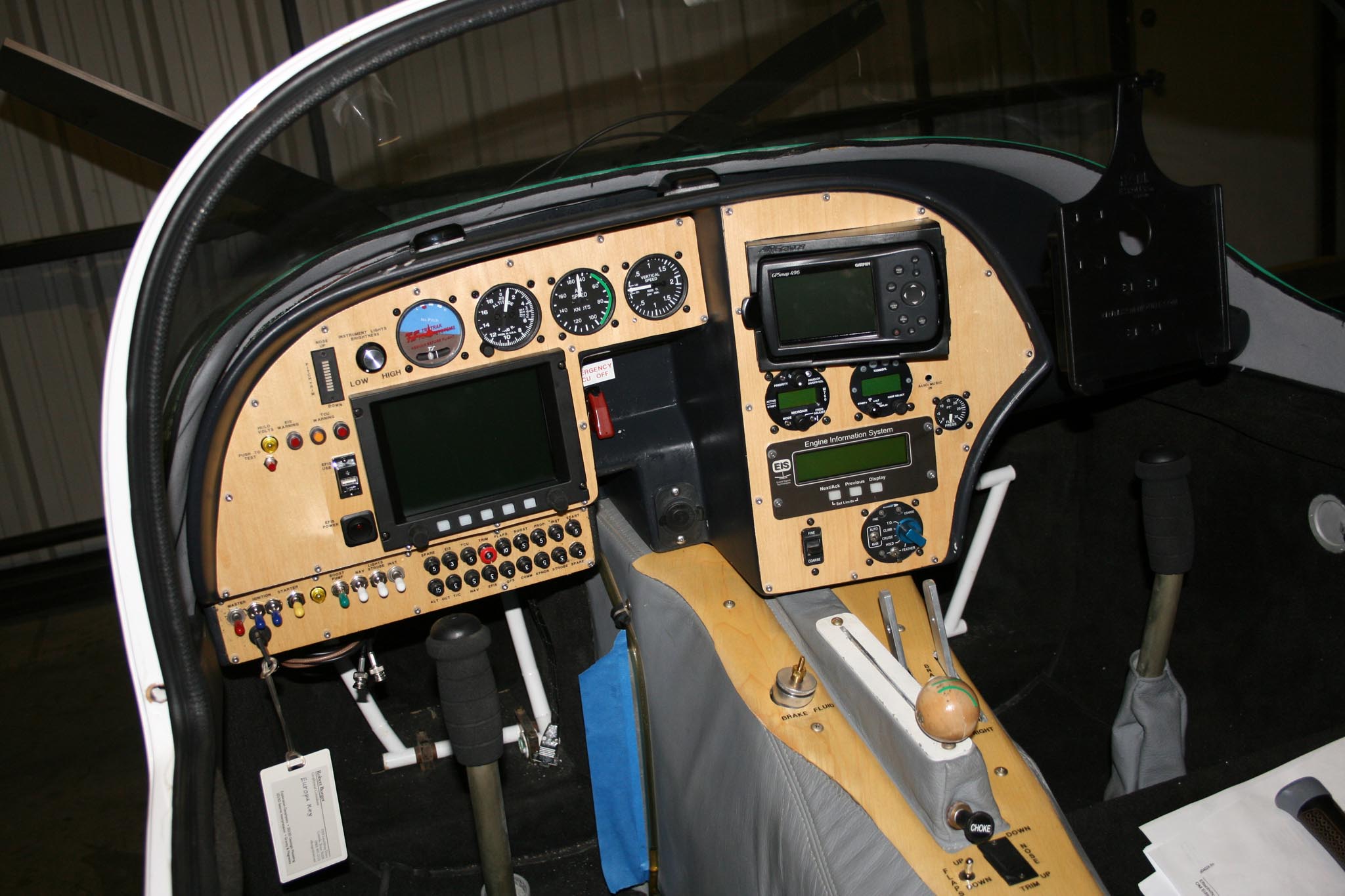

PostPosted: Fri Nov 22, 2013 5:29 am    Post subject: panel colour? Reply with quote
Bill,
You don’t have to do paint. Wood veneer can make a very attractive panel. This is my Europa:
[img]cid:122EAFB0-4769-4AE3-81FC-25FDC220EE13[/img]

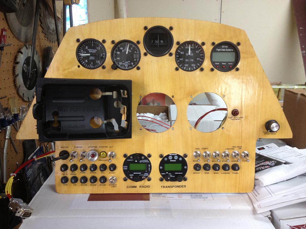

And this is the panel I’m building for my Little Toot Sport Biplane:
[img]cid:CB221A57-561C-4216-9A7E-02751EA81BFA[/img]
These are done in a very plain light wood. Veneers are available in darn near any wood, grain, color you’d like. Rockler Woodworking has an extensive selection ( rockler.com/wood/veneer ). You can also search at Amazon.com for an amazing selection of wood veneers. And there are probably other woodworking and wood supply sites as well. Many are available in adhesive back otherwise they require contact cement for application.
Just an idea for something a little different.

ceengland7(at)gmail.com
PostPosted: Fri Nov 22, 2013 6:42 am    Post subject: panel colour? Reply with quote
If you do wood, be sure it's sealed with some type of UV blocking finish, & use something other than typical contact cement or the peel & stick stuff to attach it. My 22 yr old RV-4 has wood veneer on the panel, & it's in pretty bad shape. The problems had already started when I bought the plane, when it was ~10 yrs old. The wood's dried out & cracking, adhesive is releasing, & pieces are missing.
Charlie

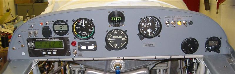

PostPosted: Fri Nov 22, 2013 10:38 am    Post subject: panel colour? Reply with quote
I used flat Polar Grey - a Poly Fiber colour (that's Polar Grey with a flatener in it)
Peter
[img]cid:part1.05090506.00090306(at)sportingaero.com[/img]

PostPosted: Fri Nov 22, 2013 10:56 am    Post subject: panel colour? Reply with quote
Looks good - but where's the Advanced screen?

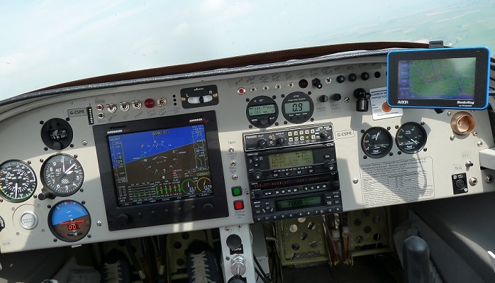

PostPosted: Fri Nov 22, 2013 3:07 pm    Post subject: panel colour? Reply with quote
This is the aeroplane with the Advanced box in it - same panel colour - in fact the other might be a slightly different shade ...
Not a wonderful photo - but gives you an idea of the paint colour under natural light (is definitely Polar Grey)
[img]cid:part1.02080007.01060500(at)sportingaero.com[/img]
