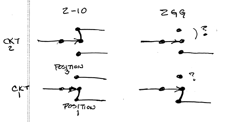

[img]cid:.0[/img]
The isn't clear as to which of the 6 tab positions
on the switch are populated. I'm thinking that a
2GG switch is a 2GH with three of the six tabs simply
left off. Another variation on the theme is the
2GE switch having only 4 tabs . . . two are jumpered
together to fabricate a SP3T operation out of the
box. My guess says you can do any of these three
functions using a GH switch with simple choices
of how the terminals are wired (or not).

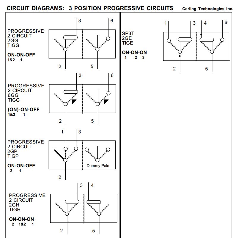

2GH _ _ _ _CIRCUIT 1 ON_ _ _ _2 CIRCUITS ON_ _ _ _ CIRCUIT 2 ON
2GG _ _ _ 2 CIRCUITS ON _ _ _ CIRCUIT 1 ON _ _ _ OFF
The above is quoted from the Carlingswitch data sheet.
I interpret this to mean that 2GH is always on, either circuit 1 or circuit 2 is on, or both are on.
And 2GG is similar to the 2-10 switch. It can be off, or circuit 1 on, or both circuits 1 & 2 on.
It is hard to know for sure without having the switch in hand.

PostPosted: Wed Nov 20, 2013 8:55 am    Post subject: Re: Carling G-Series switch configuration Reply with quote
Hmm.
It looks from the diagram that the 2GE switch is the one with all six terminals.
Does anyone have any of these to confirm the switches are actually what the diagrams show ?
Circuit 1 on, Circuit 2 on are painfully useless descriptions when a two different connections can be made for each pole.
