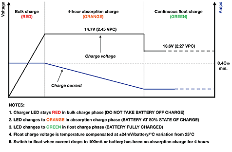

PostPosted: Tue Sep 10, 2013 10:38 am    Post subject: life of the Odyssey Reply with quote
Indeed there is.  I ruined 2  PC-680s using the 'wrong' trickle charger.  A "Battery Tender" brand charger as I recall.
The problem, as I recall, is that certain older types of 'trickle' chargers are unable to fully charge a somewhat discharged AGM (Odyssey type) battery.   If you attempt to use your battery on the  bench and then put it on that type of trickle charger as I did, you will quickly or slowly kill it.
The 'smarter' trickle chargers such as I presume the Batter Minder is, will work okay I guess.
My solution has been to use a 10 amp smart charger from Walmart for all charging of any and all 12 volt batteries.  It has settings for 3 types including AGM batteries.  I charges at a high rate then goes into trickle mode once fully charged.   It costs <$40.  I've considered keeping a 2nd one for convenience.  Don't operate it outside in the rain.
Bill "with all his 12 volt batteries in tip top shape" Watson

I am on my second PC-925 (I think that is the model) and am slightly unhappy. Both batteries seem to have lost about 20% of their capacity. e.g., if I turn on the landing lights, within a few seconds the voltage drops to 12.4 volts. After that, the voltage drop with time is normal. It is as if I lost the top 20% of capacity. Yes, I bought and use the charger recommended and sold by Odyssey.

PostPosted: Tue Sep 10, 2013 11:56 am    Post subject: life of the Odyssey Reply with quote
Bob, when possible can the model trickle-charger be identified so the discussion can morph to "The most effective" make & model?

PostPosted: Tue Sep 10, 2013 12:52 pm    Post subject: Re: life of the Odyssey Reply with quote
My charger is the Odyssey OMAX-12A, recommended for the PC-925.

PostPosted: Tue Sep 10, 2013 1:17 pm    Post subject: life of the Odyssey Reply with quote
Measuring battery capacity by voltage is only valid if there is no load on
the battery. See page 4 of the link:
http://www.odysseybattery.com/documents/US-ODY-OM-011_0213.pdf
The other value of using Odyssey batteries is the exceptionally long shelf
life. In most practical applications this eliminates any need for trickle
charging. If you discharge the battery running the panel or such with no
engine, then any standard charger for a short period of time will bring up
the charge. I never leave a charger on the batteries.
If you beat an Odyssey battery into the ground by leaving a master on for
several days the battery is gone - replace it. You might breathe some life
into it with a charger but the capacity is gone. Use it in a tractor or as

As I have posted before.
A while ago, I spoke with the Odyssey engineer regarding the proper charge voltage during operational usage. The Odyssey batteries like to see a minimum of 14.2 and ideally around 14.5 volts. Most aircraft regulators are set somewhere between 13.8-14.2. I suspect that a lot of the premature failures are caused by improper operational charge voltage, as well as the improper battery charger for this type of battery. The Odyssey charger starts its charge cycle at around 14.7+ volts, depending how dead the battery is. (see below graph) Some brands of external regulators are adjustable and could be set higher. In the case of the Plane Power internally regulated alternators, it's a little more difficult. The only way to increase the output voltage of the Alternator is to create a voltage drop, such as a diode, in the field line. In the PP case, the field line is used as the voltage "sense" input.
Most all modern avionics are capable of regulating down from 30+ volts. Older avionics maximum operational voltage should be verified prior to increasing your bus voltage.
My Plane Power 60A alternator sits at 14.5 volts during normal flight. I have 185 hours on the battery and just about 1 year. I guess we will see what happens, but so far so good.
