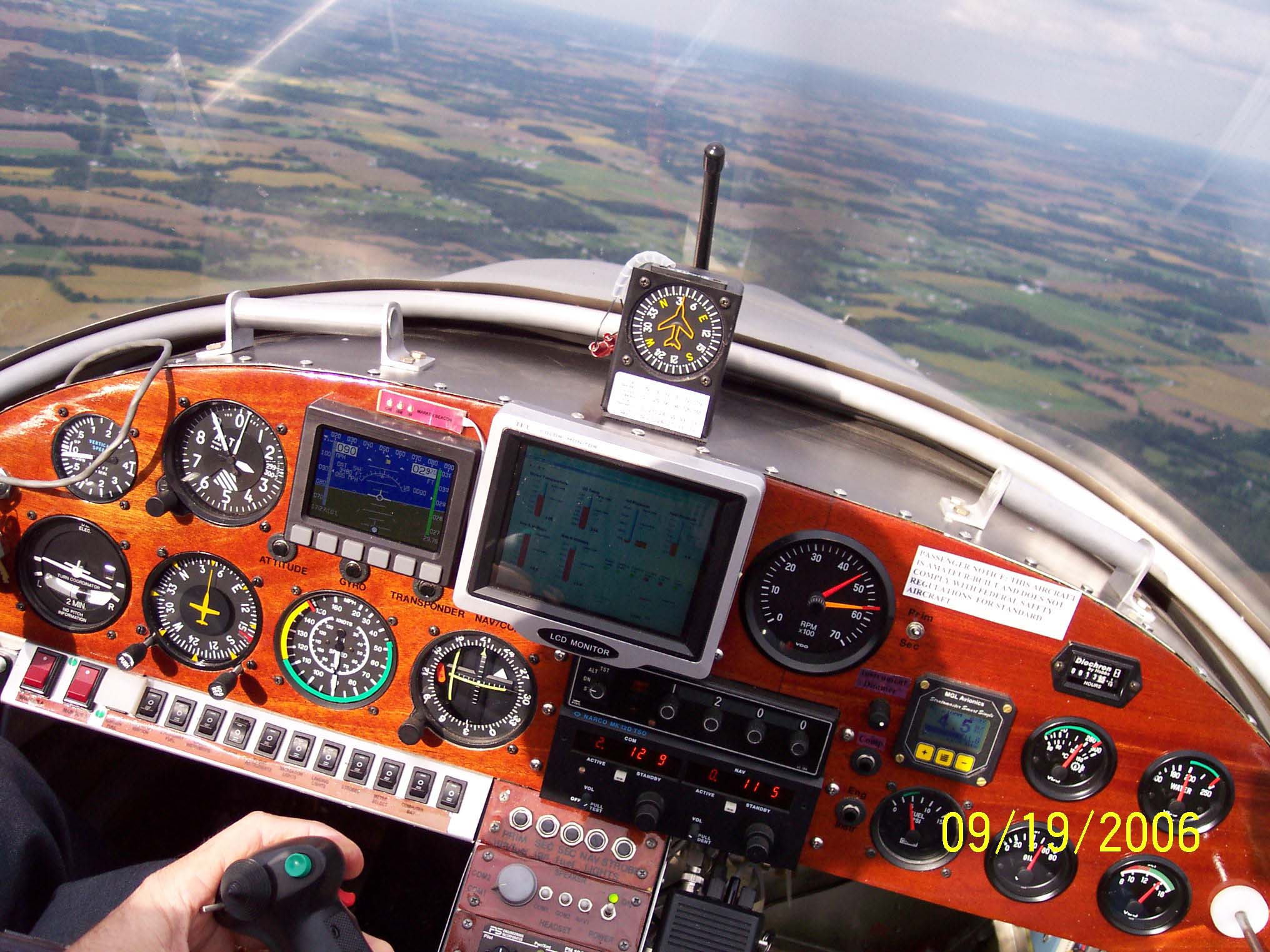

This is real cherry, it is an adhesive laminate. I put a few coats of varnish then any labeling on the panel with rub on letters then a couple of coats of varnish over the rub on's to seal them in. This is an early pictures but the cherry looks the same today.

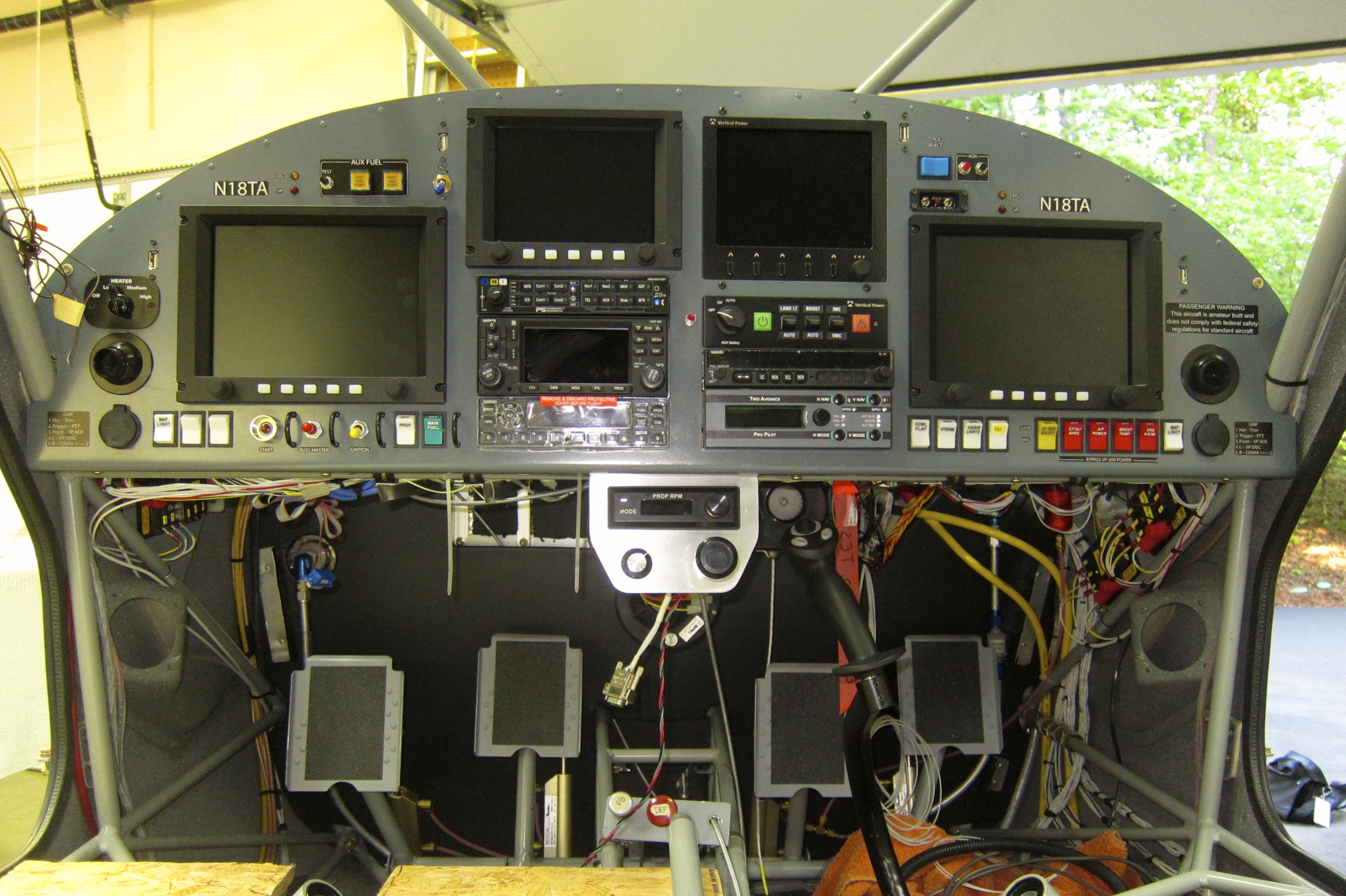

Yes, Bill, sort of blue-grey is what we did in our Sportsman. This is powder coate done by our panel builder, John Starke in Georgia. But you should be able to find a two-part epoxy you can spray yourself if you like. We added the sub-panel holding the throttle, prop control and air/fuel ratio control later. Now, it too is powder coated to match. Since the cage in our Sportsman was factory powder-coated a blue-grey, we tried to match it and are very pleased with the way it turned out.
