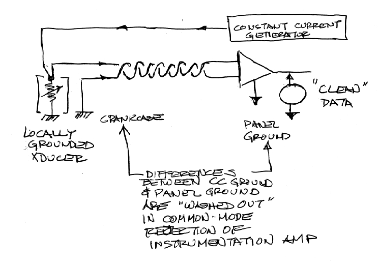

I like it that Z15-3.1 shows not only the right way, but also the wrong way to ground devices. I understand that earphones and microphones should not be grounded locally, but should only be grounded at the panel end (intercom or radio).
I am a little confused with the engine sensors. Grounding might be different for different types of sensors and their display (EMS or steam gauge). Some sensors are grounded automatically by nature of their construction and mounting. But for sensors that have isolated ground, I assume that the ground wire should terminate at the EMS or display device and not at the engine case. Of course always follow the manufactures installation instructions.
Joe

Yes. Many oil pressure, oil temperature, CHT, EGT sensors are
guilty of 'local grounding' . . . and for the manner in which they
were originally intended to be used . . . it didnt' matter.
Oh, absolutely. But absent a end-to-end design goal,
one has to play the DIY integration game. One useful
way to deal with a locally grounded signal source
looks like this:
[img]cid:.0[/img]
There are low cost integrated circuits that do the
task of making remote voltage measurements across
hostile environments. Alternatively, one can take all
grounds for the instrument to the crankcase. The same
game is played in audio systems. I did the specification
for design of an intercom system on the Lears that
coupled all stations together by way of a transformer
coupled, twisted pair . . . Intercoms scattered about
the airplane could be grounded locally for power and
control without the worry of noises on the ground-
differences finding their way into the audio.
 Filesize:  123.9 KB
 Viewed:  8962 Time(s)

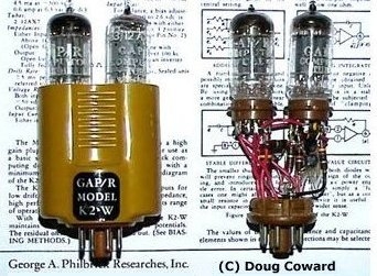

bob.verwey(at)gmail.com
PostPosted: Mon Nov 11, 2013 11:44 pm    Post subject: Minimizing audio interference Reply with quote
Bob N, for us neophytes, please enlighten us on the triangular device in your sketch.
Best...
Bob Verwey
   looks like this:
[img]cid:.0[/img]

The op-amp comes in many flavors and sizes tailored
to a constellation of tasks. I cut my op-amp teeth about
1962 on this vacuum tube version that sold for a couple hundred
dollars in 2013 money . . .
[img]cid:.0[/img]
I doubt that there were more than a few dozen
products available.
