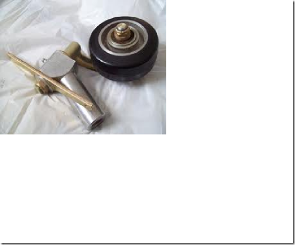

is this the tail wheel you are having trouble turning right?
[img]cid:9D2DD9D74D6F4CCD928710FFF260BAEF(at)BYoungHP[/img]
and did you mention the wheel turns easy till the actuating bar is bolted on the top?
if all above is true,,,,, there may be a missing washer under the actuating bar,,,,, or the housing may be a bit too tall.
this is the wheel I am using now and wish I had changed from the pizza cutter wheel much sooner. I love it. and even more so since I put in better bearings.
boyd young

I like that. Do you know the inside diameter? I'd like to see if that will fit onto the male shaft coming from my rear boom. What does that one cost? Travis at Kolb told me the new tail wheel with 1" wide wheel is $300+ dollars but he said it's a whole new one that needs to be put on the boom. The one in your picture looks like it might slide right on my shaft. Thanks for the picture, I can finally see one!

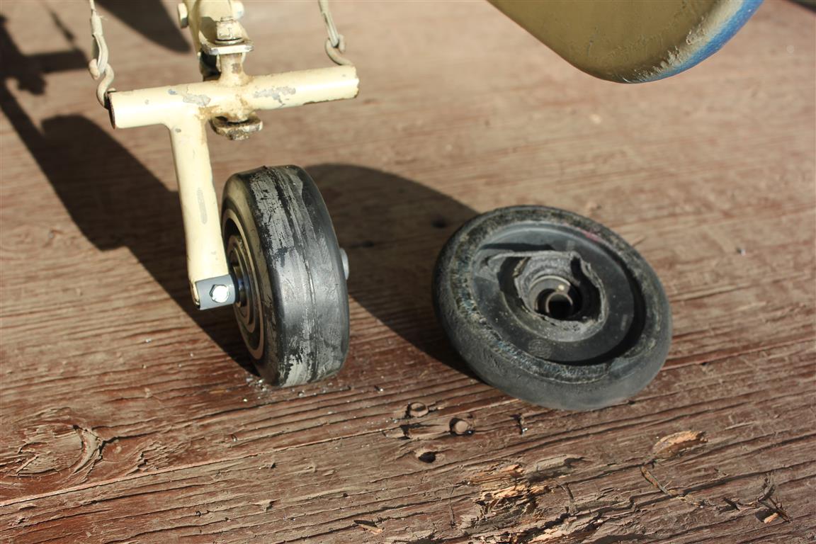

I mounted one of those wider tail wheels really easily on my FireStar. The inside diameter of the bearing is 5/8" and the original shaft on the assembly is 1/2", so just needed a short length of 5/8" tubing with a wall thickness such that it would slide over the original shaft. Found that in the offcuts from someone else's building project. Notched out one end so it would fit over the support tubing, then a 3/16" bolt to secure it. Could weld it if you had access to a welder. Works a heck of a lot better than that pizza cutter which finally collapsed.... The new tail wheel is Aircraft Spruce part #06-03500 $23.85.

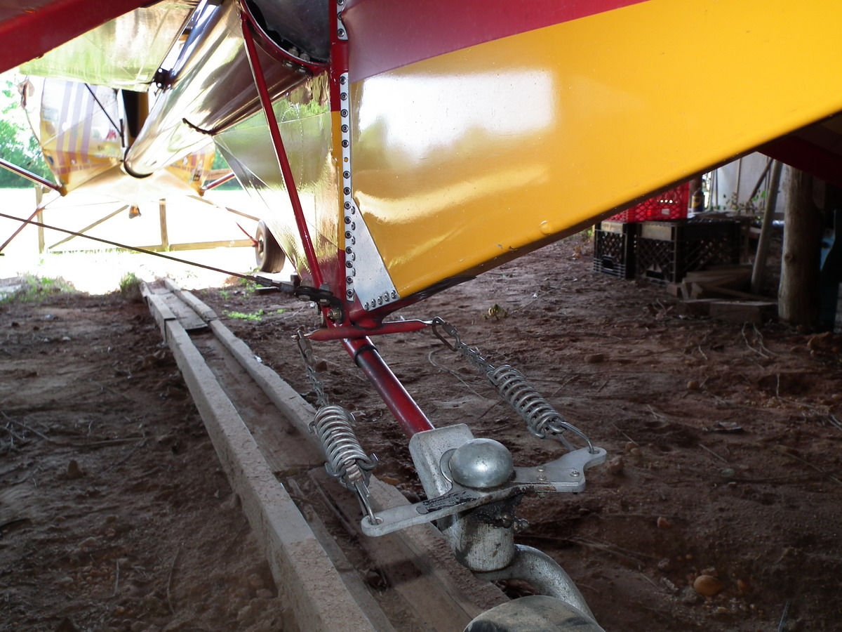

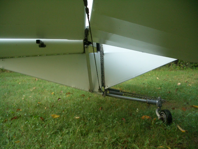

JG/Kolbers: First…attaching photos. Don't know how others do it, but I copy the photo(s), the paste them to the email. We lucked out and I found a photo of my tail wheel and springs. I used some very small carabineers to attach the compression springs to the rudder and tail wheel.

I use compression springs like John uses. I think I got them at Aircraft Spruce. I use four of the attachment things (technical term) to attach my springs. They look like the rear ones that John shows in the photo, seems like I got then at the same place. They install like the safety rings but are much stronger and don't come off in deep grass. I installed them as tight as I could but they still have a bit droop to the chains. The compression springs allow the tail wheel to snap to the direction of landing roll when I touch down without stressing the rudder assembly but allow for MUCH more positive control in cross winds.
Rick Neilsen
Redrive VW Powered MKIIIC

Didn't look at my photo long enough before I sent it.
I used carabineers to attach to the rudder and "normal" tail wheel spring clips to attach to the tail wheel.
One could easily bend up to strong "s" hooks to do the same job for nothing.
