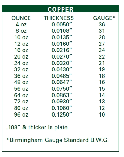

I've had some direct emails asking about the selection
of copper sheet for fabrication of bus bars. It seems
that copper is sold in a market that adopted the Birmingham
guage system as opposed to the Brown and Sharp tables
common to the brass and aluminum markets. Then there's
the stainless steel guys who have their own tables
. . . sigh . . .
This excerpt from a copper sheet gauge table
illustrates the reason why our calculated weight
earlier this morning was a bit different than
the cited weight in the Ebay ad. The "48 oz"
copper being offered was indeed a couple mils
thicker than 1/16" thus explaining the difference.
[img]cid:.0[/img]

This little exercise suggests that .065" copper in 1/2"
wide strips is just fine behind the panel . . . and 1"
strips is okay between contactors, probably no more
marginal for heat rejection than the starter itself. A
piece of 1/8" copper would drop the 50C rise to 25C at
200A in 10AWG wire equivalents . . . MUCH more headroom.
