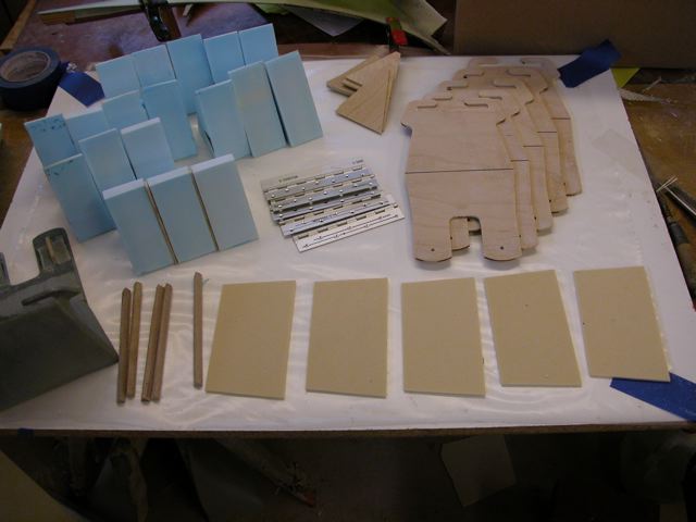

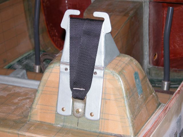

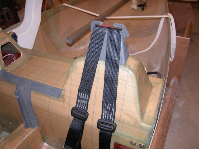

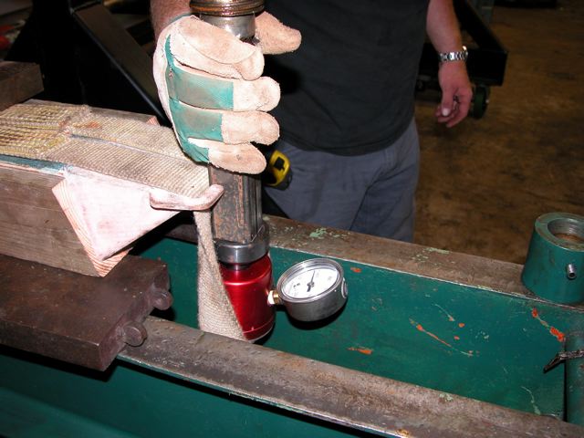

PostPosted: Sun Oct 27, 2013 7:40 am    Post subject: Seatbelt mount Reply with quote
On Oct 27, 2013, at 3:11 AM, Bob Harrison wrote:
It is just a pity that someone has to go through the expense of engineering PROOF LOADING and design procedure and finish up with needing to pay for a damn mod. to put it into practice.
Bob...I couldn't agree w/ you more...and...there are both positives and negatives to the regs and different approaches used by the people-who-are-paid-to-worry in the UK and the US.
In my circumstances, I was the only person I had to satisfy...and I was able to do so by imposing a 1500# compression load on my little riser using a hydraulic press and very heavy duty cargo strap...but the net effect was but a conscientious effort to ensure that the orientation of the imposed loads was accurate and the load path into the airframe did not change...nonetheless, a far cry from engineering proof loading.
Fred

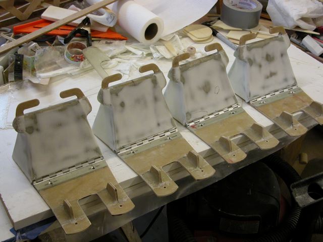

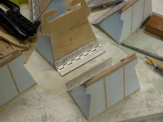

PostPosted: Sun Oct 27, 2013 8:04 am    Post subject: Seatbelt mount Reply with quote
On Oct 27, 2013, at 12:56 AM, <markandrhonda(at)harveyfarm.net.au (markandrhonda(at)harveyfarm.net.au)> <markandrhonda(at)harveyfarm.net.au (markandrhonda(at)harveyfarm.net.au)> wrote:

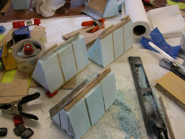

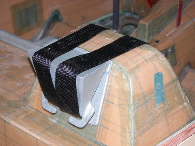

What material have you used to build the extension blocks and how much higher than the head rest are they?
Mark...foam was hot-wired...pixs below are self explanatory...bottom was contoured to mate w/ the top of the CM w/ a bed of resin/flox...I'll see if I can digitize a drawing...F.
[img]cid:90C52754-9A7B-4306-94EB-163EC06E0CEB[/img]b
[img]cid:7F1C6B7F-2CDF-4A76-9FFE-5AD703D01854[/img]
[img]cid:C1C6A7C0-1F0A-447D-BF87-55F95697A342[/img]
[img]cid:AEFF19C2-EE8A-43C1-98C6-ABE1ACB18F88[/img]
<DSCN2133.jpg>b
<DSCN2135.jpg>
<DSCN2136.jpg>
<DSCN2205.jpg>
Fred Klein

PostPosted: Sun Oct 27, 2013 8:56 am    Post subject: Seatbelt mount Reply with quote
On Oct 27, 2013, at 9:24 AM, Pete wrote:
Nice job Fred, Better the seat back and mod get crushed than ones spine!
Thanks Pete...I'm repeatedly surprised by the strength of foam & glass composites...F.

Nice neat job and they look very strong Fred

Mark...I wrapped 3 layers of BID around the ends up to the 1/8" plywood stiffener...then wrapped another 3 layers over the entire front and back faces and thru the ears including the hinge plates....Fred
