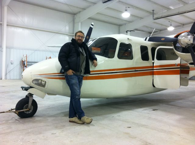

So, pre-buy with Morris is done and showing no real surprises. Pretty good shape for her age. She will need a bit of TLC - some of it I will have to take care of straight out of the gate, some can wait until the annual in June and some can wait indefinitely.
Main things need taking care of, I think:
- Three brake pads need replacing. The seller has some, but he said they might be "homemade" by the previous owner, so not spec. I didn't get to see them.
- There's also a small hydraulic leak in the right gear lock down mechanism. Probably just a seal.
- Ailerons are over tightened and have the wrong bolts. This I think should be addressed swiftly in case they start chafing or causing other damages.
- Fuel, hydraulic and vacuum hoses dry and brittle in engine compartments. Needs swift fix.
- Pushrod tube seals leaking oil.
My aim is to fly her back to California beginning of Feb.
Morris was a huge help and after he flew back, I got to spend some time with the machine. I'm very excited and she seems like a lovely, snubnosed friendly plane. I'm looking forward to many years of flying with her.
