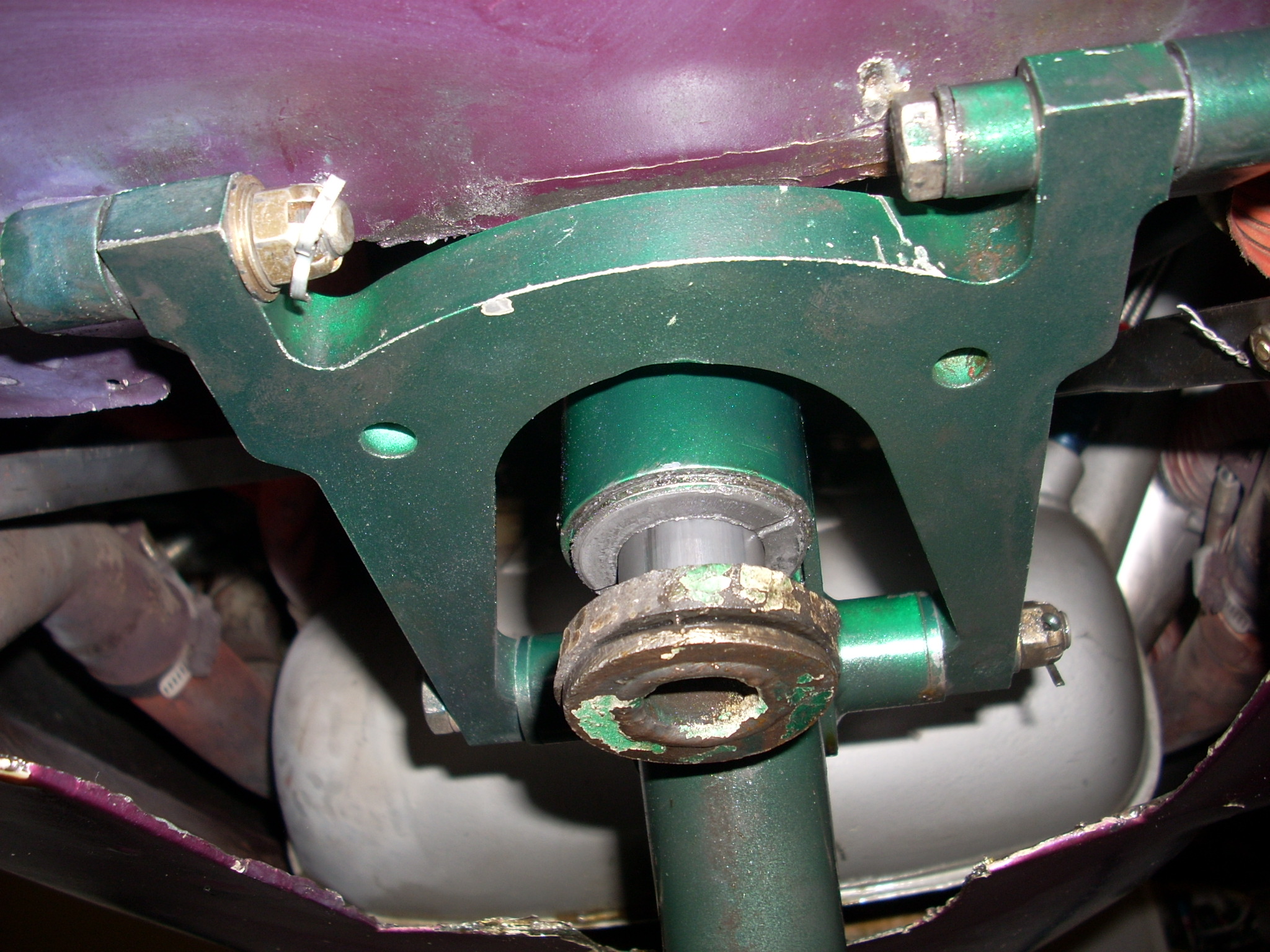

Hello Galin, You wrote: “I am also contemplating having the new pin made
from steel instead of aluminum even with the dissimilar metal corrosion
issue.�
I would not accept an aluminum pin in such a high stress location. I am
surprised that such material was used in the first place.
As for dissimilar metal corrosion here is some information on that issue:
http://www.galvanizeit.org/design-and-fabrication/design-considerations/dissimilar-metals-in-contact
http://en.wikipedia.org/wiki/Galvanic_corrosion
I would like to stress the factor of current flow being the cause of such
corrosion and the much reduced factor of current flow when the two metals
are frequently moving against each other, instead of having a static
connection, and the further reduction of current flow by some intervening
substance such as grease. See here:
“Ensure there is no contact with an electrolyte. This can be done by using
water-repellent compounds such as greases, or by coating the metals with an
impermeable protective layer, such as a suitable paint, varnish, or
plastic.�
It may take a bit of searching around, but you may even find a single long
AN bolt that could replace the pin. Or, as has been already mentioned, use
two shorter AN bolts. In addition to any grease involved these bolts would
also have the initial protection against corrosion because of the cadmium
plating.
OC
From: Galin Hernandez
Sent: Friday, August 01, 2014 11:03 AM
To: kis-list(at)matronics.com
Subject: Re: N819PR Nose Gear Failure
On Jul 31, 2014, at 10:38 PM, Galin Hernandez <galinhdz(at)gmail.com> wrote:
I contacted CATTO Props today but they are all at OSH so if somebody gets to
talk to them ask about a 3 bladed composite for a KIS4 with Lycoming O360
180HP engine. Smile
Now for the ongoing nose gear saga:
It turns out the rear pin on the nose gear assembly sheared which caused the
gear to collapse. The shear was clean and it was obvious (corrosion) the pin
had started breaking well before the failure. It sheared right where the "H"
bracket meets the firewall bracket and this explains why the visual
inspection done during the annual did not find it. To see the problem
happening you have to remove the pin there is no other way to inspect the
area. I recommend everyone pull and check their rear "H" bracket pin to see
if they are experiencing the same issue or not. If you do please let us know
what your find, good or bad, so if there is a trend we can identify it.
I plan to pull and inspect the new pin after 50hr or 50 landing (whichever
comes first) and at the annual. If I experience a bad shimmy at any time
(due to over grease or lack of friction) I will pull and inspect the pin
since this places a lot of stress on that specific part of that pin. After a
few inspections I will decide if it needs to be inspected on a continuous
basis or I just got a bad pin. I am also contemplating having the new pin
made from steel instead of aluminum even with the dissimilar metal corrosion
issue. Steel or aluminum I will do the above inspections no matter what the
pin is eventually made from.

I never liked the idea of the pins in the nose gear so i replaced them with
cad plated bolts and grease them up each annual .
In addition to being stronger than the pins they also take up a lot of
side movements .
here is a picture :
(See attached file: DSCN0225.JPG)
180HP engine. Smile

Bob; The pin, fuselage brackets and the "H" brackets are all new. I have to
verify with the mechanic working on this but it is possible that the rear
pin is stainless steel not aluminum but I am not sure. This would make a
big difference in shear strength. I could have just gotten a bad pin. Feces
occurs.
however, I need to insure the two fuselage brackets are properly aligned
because if not this can put a different stress on that pin it isn't
designed to take. But either way I am going to follow Al Rosa and Keith
Miller's lead by using aircraft bolts instead of a long pin. I think it
would be a wise thing for everyone to do.

I am fairly sure that this pin as originally designed was steel. Could the builder have changed this from the steel to aluminum at some time? Do others have an aluminum pin or steel?
Mark
PostPosted: Wed Aug 06, 2014 7:09 pm    Post subject: N819PR Nose Gear Failure Reply with quote
I checked with the mechanic and the pin is stainless steel, not aluminum.
My mistake.
After talking with Lyle Hendricks, he said the assemblies have been
shipping with AN bolts, not pins, for years now. He also told me that using
the "eye bolts" on the "H" bracket instead of just drilling a hole provides
a measure of compensation in case the firewall brackets are not perfectly
aligned. He said the bolts are rated at some 30,000lbs so the aluminum
firewall brackets or the aluminum "H" bracket will fail long before the
"eye bolts" do.

Hello Mark, The pin in kit #116, my KIS TR-1, was steel. I think that
aluminum would be entirely unsuitable for this use.

Al; Here is a photo of the "H" bracket where you can see the rear aluminum
pin just underneath the fuselage. Can you send a photo of your set up? I
wonder if they changed the design and now use 2 steel bolts instead of one
aluminum pin. This would really strengthen the point where the "H" bracket
connect to the firewall brackets which is what I was thinking with my idea
of a steel pin.
