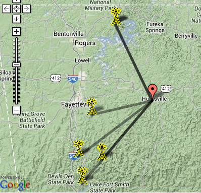

PostPosted: Mon Jun 17, 2013 6:37 am    Post subject: Hanger Antenna Reply with quote
Hmmm... Huntsville, AR
Here's where your TV stations are with respect to the airport. They are all a good distance away but not on one common mountain top. All of them except the PBS station (which is on a high VHF channel) are on UHF.
[img]cid:part1.00070702.04050307(at)wwpc.com[/img]
It doesn't look like there are a lot of strong signals so overload of an amplified antenna shouldn't be a problem. I don't think a single antenna is going to do everything for you though.
I'd look at RV amplified TV antennas for the TV. They're usually a disk shaped thing that will have some sort of mounting that can be done to the roof of your hangar. I usually don't like these antennas because in hilly areas they can compromise reception because of multipath (receiving bounces that are slightly out of time with the main signal). In the old analog TV days this would show up as ghosting. Now with digital it degrades the signal because of (apparent) jitter. But they are easy to install and use.
The AM/FM and Air radios can all work off a garden variety car radio antenna. All of this will have to work with radios and TV sets that have antenna connectors that you can attach the antenna's to.
Bill

PostPosted: Mon Jun 17, 2013 6:59 am    Post subject: Hanger Antenna Reply with quote
Thank Bill -
I will look into those.
M. Haught
On Jun 17, 2013, at 9:36 AM, Bill Putney wrote:
[quote] Hmmm... Huntsville, AR
<Screen Shot 2013-06-17 at 7.14.05 AM.png>
Bill

PostPosted: Mon Jun 17, 2013 9:10 am    Post subject: Hanger Antenna Reply with quote
At 09:59 AM 6/17/2013, you wrote:
Thank Bill -
M. Haught
Bill brings up some important points that should be
considered in this discussion about unobtrusive antennas.
The 'active', omni-directional, untuned antenna for
UHF/VHF is never capable competition for directional
antennas specific to a frequency.
My impression of design goals for the beginnings
of this thread suggested that signals of interest
were adequate to used on a hand held transceiver,
a portable FM receiver or perhaps a portable TV
receiver EACH OF WHICH uses some form of attached,
whisker antenna.
In other words, the task was to work around the
shielding qualities of a steel building. The reasons
for adding transistors to the base of an antenna
is two-fold (1) allow a VERY high impedance, non-resonant
whisker to drive a relatively low impedance coax feed line
and (2) add some gain which tends to overcome (a)
losses in the feed line and (b) augment a marginal
signal.
If you stand on the roof of your hangar (or other
RF unfriendly building) and experience useable
performance from the hand-held, then the active
antenna I've suggested will EXTEND that usefulness
into the building.
Adding gain to burrow into atmospheric noise
is another game entirely . . . a game that can
be played by specifically tailored active antennas.
Just be aware that the laws of physics are inviolate
and the act of adding some transistors to the
base of your antenna is not a universal solution
for weak, noisy or otherwise over-the-horizon signals.
So to watch that station in Fayetteville from
Huntsville is a hop of 22 miles. No big deal IF
you can 'see' the transmitter from the top of
your hangar. If you can take a hand-held up and
get adequate performance on this signal source, then
the simple active antenna has a high probability of
meeting your needs. Otherwise, plan-B is called
for . . . have you considered Netflix? We dumped
cable a couple years ago and never missed it.
handainc(at)madisoncounty
