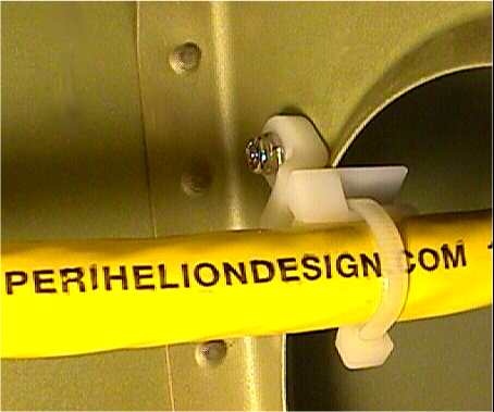

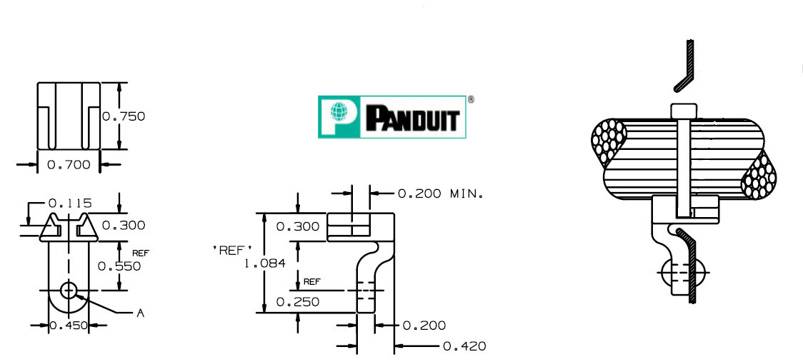

I find it remarkable that I am the only dinosaur who remembers these. There are very specific parts used to thread wires through lightening holes: Panduit Lightening Hole Mounting System, LHMS is what they are called. I used to sell them until Digikey started to.
http://hqwww.panduit.com/panduit/groups/MPM-GAWA/documents/PartDrawing/086887.pdf
They are really worth getting.

Pix of Panduit LHMSs. These really are better than what you can make.
