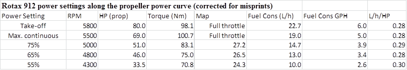

Numbers are not 100 % correct on 2nd
chart
the litre to gal.hour conversion alone does not look correct

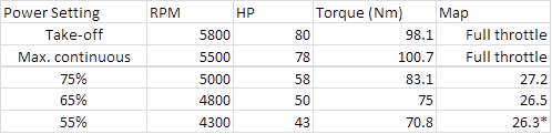

<![if !supportLists]>- <![endif]>The Operators manual (Ed 3, Rev. 0, September 01/2012) has a table on page 5-3 of recommended RPM/MAP settings for the 912 engines with variable pitch propellers which I’ve reproduced here:
* It looks like the MAP of 26.3 for 4300 RPM is wrong in the above table. If I check the graph in Fig. 2 on page 5-2, for 4300 RPM I read off 24.3, so I guess there’s a misprint there. The other numbers look ok and appear to make sense.
<![if !supportLists]>- <![endif]>In my case, I don’t have space for a MAP gauge on my panel, but I already have a Floscan fuel monitor/gauge. I’m wondering if that could be substituted for the MAP gauge? After all, fuel burn tells me how much energy I’m feeding into the engine, so it should be very closely correlated to power developed. And my fuel return line goes back to the gascolator (downstream of the fuel flow sensor), so the fuel slow sensor should be measuring net fuel consumption. I’m just not sure how accurate/responsive it is to changes. Anyway, I’ve used the fuel consumption (Fig 2 on page 5-2) of the Operators manual and derived the following table. Here, I’ve reported the power requirement of the propeller rather than the max engine output, since the former is what is almost perfectly proportional to fuel flow, as can be verified by the fact that the last column (giving fuel consumption in L/h per HP developed) is almost constant. Data is from pages 5-2 & 5-3 of the operator manual (corrected for the misprint I mentioned above)
The fuel consumption numbers appear to make sense and to be similar to what e.g. Stan was reporting.

Seems ok to me, am using 3.785 L/US Gal, then having Excel round to the first decimal place.   Which number seems wrong?

my mistake --
