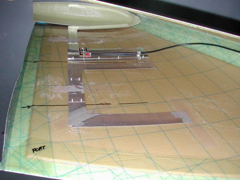

Speaking of Bob Archer and his antennas…
I was able to connect my new Red Dot analyzer into the line between my MicroAir 760 and the Bob Archer antenna I have mounted in the vertical stab of the Europa.
Here's a picture of the antenna installation:
[img]cid:B603EF70-0DC9-43CF-A07D-FB0FD0A47F79[/img]
The coax termination to antenna is as per Archer's instructions. Crimp eyelets on to the central conductor and onto a braid made from the shield wire. Apply some shrink tube on the braid and coax for insulation and support. Then attach the eyelets to the antenna with nuts & lock washers over the screw posts.
Always looked pretty crude to me, but those were the instructions so I that's what I did.
Measured SWR 1:1.2 Not bad at all.

PostPosted: Thu Mar 01, 2012 2:51 pm    Post subject: Dipole antenna fabrication Reply with quote
Not surprised. I suspect that Bob's fabrication of
the gamma-match and associated capacitor are designed
to tune out much of the reactance added by the bare,
non-coaxial lead wires. The wide geometry of the
radiating elements do doubt contributes to a wider
performance band-width.
