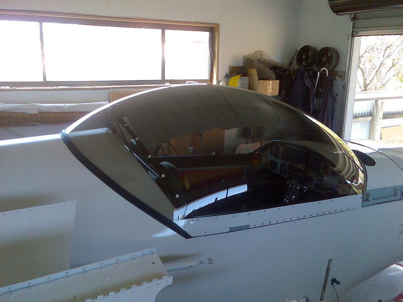

How have you guys dealt with riveting on the canopy? The sides of the front and rear canopy would need to be riveted but after my past experiences cracking the canopy I am really reluctant to do anything.
Now having learnt from the thread I will use the recommended drill bit and techniques but I am still worried that the pressure generated by the rivet on the canopy will cause the canopy to crack.
Any recommendations and practical experience would be gratefully received.

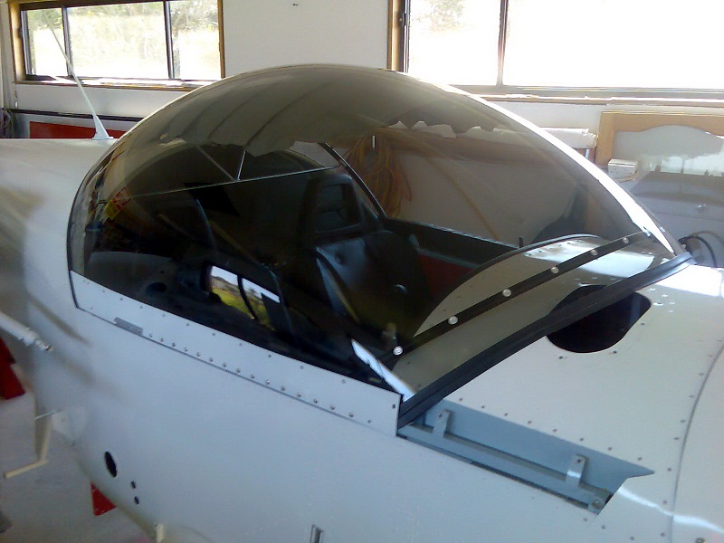

PostPosted: Fri Dec 30, 2011 2:45 am    Post subject: Cracked Canopy Reply with quote
I didn't do any riveting on the canopy. All of the points where the
canopy gets fasteners I used screws with tinnerman washers.
Paul

Thanks Paul, and in the places where you have to go first through an aluminum piece and then into the canopy did you just make a large size hole in both the canopy material and the aluminum skin with the washer seated over the top of the two?
J

I used the same screws and tinnerman washers at all locations where a
fastener goes through the plastic canopy. I'm afraid riveting through
the plastic will surely cause cracks.
Again I must claim lack of clear memory of exactly what the screws
attached to. The way the screws work they have a tinnerman washer on
the outside and a solid piece of metal (either aluminum or steel) on the
inside with the plastic canopy captured in the middle. I think the self
tapping screws easily go into either steel or aluminum when you have a
proper sized pilot hole in the metal.
I'm not sure, but I think some of the screws go into the thin wall
square tubing that makes up the basic structure of the canopy base.
Paul

I am thinking of lining the inside 20mm edge of the rear canopy with the
Slap Stix product Jerry Latimer recommended after pre-drilling for a rivet.
Then I will carefully pull the rivets by hand.
Anyone else have any ideas?

I'm not familiar with the two-piece canopy but I would not recommend installing rivets into acrylic. I would think you would want to use a flashing strip to attach the rear canopy. Then glue the acrylic to the flashing. The flashing would be riveted to the fuselage.
3M double sided molding tape also works very well for attaching flashing to acrylic. The vinyl foam tape seals the gap and holds the pieces together. I used this tape on the front flashing on my 601XL, I've had no problem with it. I used it to attach the fog lights to the bumper of my old ford pickup and they never came loose in the 4 years I owned it.

I ended up using large headed [1/2 long x 1/8Dia] self taping screws on the bottom steel RHS tubes.On the hinge cover panel I put in anchor nuts .I also cut the sides of the canopy less, so that they extend past the fuselage [by 1/8"] for weather proofing,and a very soft rubber seal under the steel RHS tubes so that the canopy locks down with only a little downward pressure.I also drilled a 3/8" hole on each side [on the inside] so you can see the locking mechanism [spring tang] engage properly and positively [put a bit of red paint on the tangs]. All holes drilled either 1/4" or bigger thru the plastic canopy [Todds canopy]using a step drill with NO cracking so far. Cheers Alan
