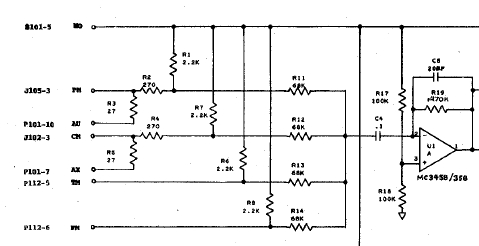

I've dug out the internal schematics for the RST
intercom and discovered that this is an INTERCOM
with no integration-friendly features for tying
it to one or more radios.
As an intercom, I'm mystified as to the installation
instructions that recommend opening the mic audio
leads to each mic along with the PTT signal. I.e.
a spring loaded, 2-pole, normally open push-button
DPST OFF-(ON).
If one adheres to this configuration, then it seems
that the value of an adjustable silencing
system (VOX, squelch, etc) is negated . . . the
existence of these switches in the mic audio leads
makes it a Push-to-Talk Intercom . . . not a VOX
intercom.
A study of the microphone input circuits to the
intercom shows that power to run the microphone's
electronics is provided internally to the intercom via
the 2.2K resistors tied to the mic leads from the
8v supply.
http://www.aeroelectric.com/Installation_Data/RST/RST-442.pdf

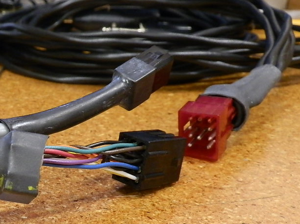

It would be helpful to know the style of connector
depicted in the RST drawing as "P101". A close-up photo
would be useful. I think Jim was fond of the
Molex mini nylon connectors back then but I
need to confirm this.

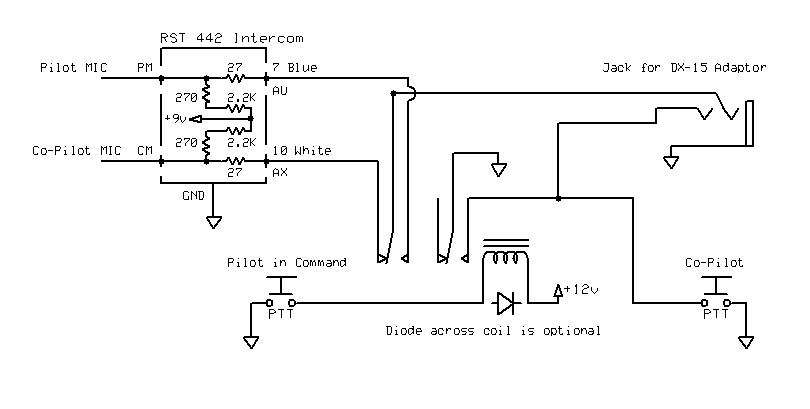

Attached is a schematic that I drew of a single relay interface between RST-442 & Com radio. Only one MIC can be connected to the radio at a time. I do not know if having the co-pilot MIC always connected to the radio hurts anything. What do you think?
Joe

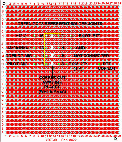

See attached picture that shows how a perf board with copper strips can be used to make a project without having to acid etch a copper clad PC board. While not suitable for complex circuits, simple circuits can be crafted by adding jumpers to the component side of the board.
Joe

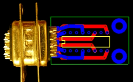

Another options to consider . . .
[img]cid:.0[/img]
You could lay out a board like that shown above (actually, the
layout is already done) and order them from Express PCB.
Minimum order yields 18 boards in 3 days for about $69.
This board would accept a solder-cup D-sub along one
edge and mate to 9-pin de-sub of your choice. The board
is supported at one end on the mating connector. The other
end with a screw and spacer. Alternatively, one could
downsize the d-sub connectors like I did here
http://www.aeroelectric.com/articles/macservo/macservo.html
. . . and finish off the installation with a simple, over-all
cover of heat shrink where the relay assembly is simply tied
to a wire bundle.
In this instance, I think I'd solder the relay to the board
as opposed to setting it in a socket. This process would
yield a very compact relay assembly with robust construction,
very low assembly time and stone simple (d-sub) interface

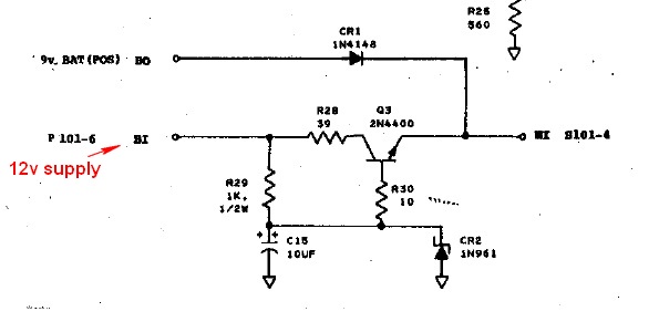

I've ordered the relay and continuous bus perfboard. I'll post some pics when I get it assembled.
I also was wondering about the power supply. I'll wire the a/c 12v supply to the wire connected to the BI terminal on the intercom circuit board. There is also an option to add a 9v battery for backup, connected to the BO terminal. I have a 1.2 Ah 12v battery that is used for my EFIS backup supply and wonder if I could wire this to the BO terminal in place of the 9v. Would I need a resistor between my 12v backup battery and the BO terminal, to drop it down to 9v? If so, how do I figure the size?
How would I know the intercom is drawing current from the main 12v supply (BI) and not the backup (BO)? Even though the small 12v backup battery gets recharged by the main a/c 12v supply, seems I'd want the a/c 12v supply to provide power for the intercom.
 Filesize:  23.33 KB
 Viewed:  13284 Time(s)
