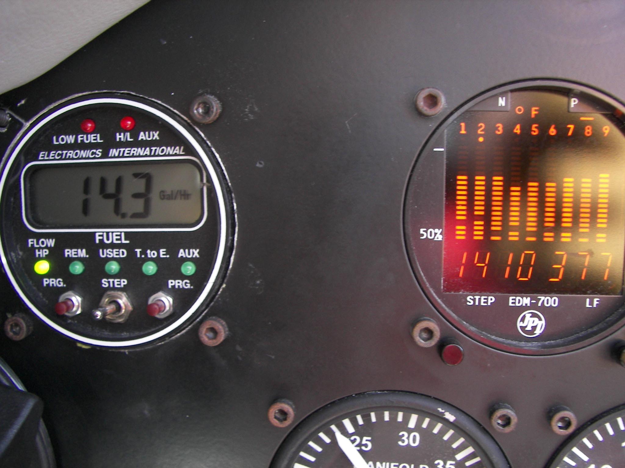

PostPosted: Wed Jun 24, 2009 8:55 am    Post subject: Re: M14P magneto Reply with quote
barryhancock wrote:
Hey Milt,
What kind of real performance are you seeing with the RR? Also, when you shove both levers in the corner, what's your IAS?
Thanks!
Barry
I usually run 28/1800, my plane has the PF engine and I have replaced the pressure carb with an airflow performance throttle body with manual mixture control and run a MT 98" 3 blade prop.
At at these settings fully loaded I see (192IAS) 205KTS TAS (at)14GPH and CHTs averaging 380deg F
When I shove everything forward I can get (210IAS) 235KTS TAS at 50+ GPH.
IAS and TAS are with a Blue Mountain EFIS Sport G4 and correlate well with ground speed given winds.
VNE is 250 KTS IAS
Milt

n395v
Posts: 450
PostPosted: Thu Jun 25, 2009 4:11 am    Post subject: Re: M14P magneto Reply with quote
barryhancock wrote:
Thanks, Milt. Impressive performance numbers. Those CHT numbers are hot for cruise. I'd expect them in the 310-340 range. Are your running LOP?
A PF with the Airflow system should net some serious HP.
What altitudes are you seeing those numbers at? Also, what does a typical climb profile look like?
Barry
With the single point fuel injection (throttle body) I cannot get it to go lean of peak.
I am seeing 380 deg F because that is where I lean to. It keeps me about 100deg ROP (EGT) on the 1st cylinder to peak.
Usually fly between 7 and 9000 feet. I have a problem with vapor lock above 10,000 feet that I need to resolve.
Climb on a cool day at sea level, 1 passenger and 60 Gal fuel is 4000fpm+ with 2 pax full fuel(90gal) and some baggage it drops to 2500fpm.
I will usually cruise climb at 130-140KTS at 35" and 2700RPM this gives about 1200fpm.
I have no idea what the AFP adds to the horsepower.
My only point of reference for performance is the factory prototype with the 360HP carbureted engine and I can walk away from them in every parameter.
Empty weight is only 1640 pounds .
Cruise speed is very weight sensitive fully loaded costs about 8KTS TAS.
It has fairly high wing loading.
I have added a fuel return line to the fuel system and encased the firewall forward fuel lines in a blast tube to prevent the vapor lock and am in the process of extending the wings 3 feet for better high altitude performance and hopefully decreasing the speed sensitivity to weight.
