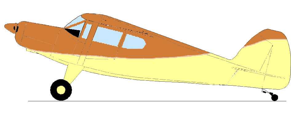

PostPosted: Thu Oct 18, 2007 3:16 pm    Post subject: Instrument panel beginner Reply with quote
Bret -
Enjoyed your site, and wanted to to know I am adapting your paint scheme to a Bearhawk (file attached- dark color is a bright,deep orange over a complimentary yellow shade - used for visibility in the bush). I like the simplicity and I think it lends itself well to the Bearhawk lines.
Using your ideas for instrumentation, what are your thoughts on instrumentation for a VFR airplane, that might occasionally, file special VFR to get out of a low ceiling situation flying into clear air?
M. Haught
[img]cid:part1.09060701.07010404(at)madisoncounty.net[/img]
