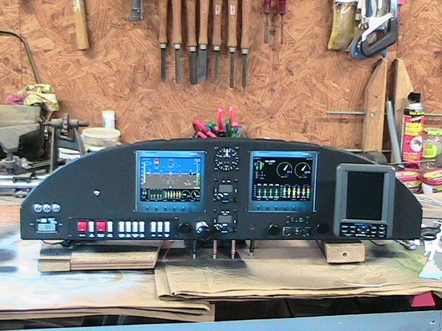

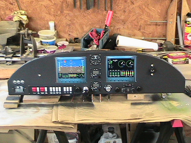

These photos are low-res but will suffice. Nope, haven't made a list yet.... the mental one that keeps popping up in annoying me enough. Having worked on an RV7-A, I agree about the strength of the design. It's a beast alright. I haven't hung the engine or fitted the wings to the fuselage yet due to lack of room. Once my hangar is finished (2 months?) I'll move the project out there and continue. Oh yeah..... that light at the end of the tunnel? It turned out to be a train. (grinning)
Good luck on yours. It's a wonderful plane but a heck of a lot of work.
Ed

n787xl(at)aol.com
PostPosted: Thu Jun 07, 2007 6:42 am    Post subject: GPS Recommendation Reply with quote
Ed
What are the 3 instruments in the center of the consol?
I'm laying out my panel and wondering how you have choose yours.
James S
601XL, Jab
&RV6 flying
dredmoody(at)cox.net
PostPosted: Thu Jun 07, 2007 7:23 am    Post subject: GPS Recommendation Reply with quote
---- n787xl(at)aol.com wrote:
The top one is a backup ASI steam gauge. The next under that is a Becker transceiver. The bottom one is a Becker transponder. They are fit 2.25" round gauge holes . I chose the Becker units based on their small size and decent customer satisfaction reports. The x-ponder is reputed to handle frequent interrogation in a dense traffic area better than the similar Microair unit.
Since I don't have first hand experience using them yet, there remains the chance that my choice was a bad one. We'll see.
Ed
Ed
