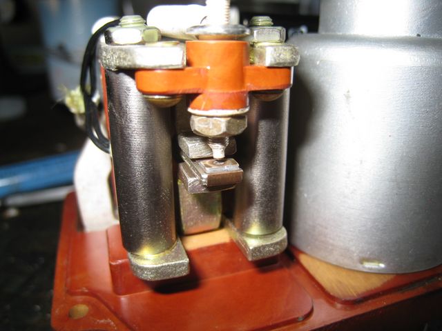

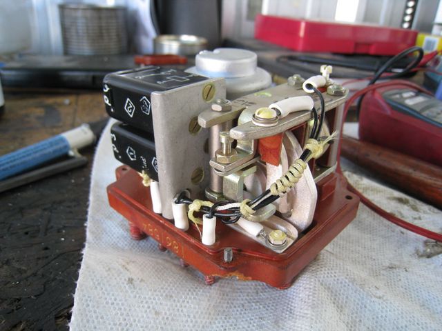

Thank you. Since then, I have seen confirmation that there are two types
of polarization relays.. if not more... since I have taken a second 200D
apart. The one I have in the one I am invesitagating now is almost the same
constuction, but it clearly has a large bus bar type arrangement that
surrounds the lever arm and clearly is a current operated device. It is
possible that the first one I had, which is now back in my airplane, had
something LIKE that that might have been buried under the material that
mounted the relay. I find it hard to believe there are two different
designs... two different relays, sure.. .but not two different designs.
Without a shadow of a doubt, this second one has a large current operated
magnetic field influencing the lever arm.
I agree with you. It is clear that the one mis-statement is the part that
says: "Two windings on the same core". I have a clear definition of what a
"core" is. Others may understand that term in a different way. What is
true regardless, is that neither the first or second polarization relay I
have examined have two systems on the same core. BOTH have a standard coil
on core arrangement that is normal for "typical relays". I am assuming that
this is the shunt winding. The series arrangment on the second example uses
bar bar material to influence the magnetic field of the first standard
winding and this I assume to be the series array.
>>RR I found & translated the (attached) DMR-200D drawing which provides a basic
cross-section of the differential relay, highlighting the various points we've discussed;
- the latching mechanism appears to be the permanent magnets used to polarise the operation (there's also a spring)
- the differential action across / between the shunt & series "windings" (sic) tips the see-saw armature
- there is an adjustment screw shown
Unfortunately the accompanying description was the same as the YAK ops handbook, which is even less informative than the Sukhoi info.
Hmm... I could not find your attachment... but I am pretty sure it is the
same device. I looked at a 52, and it was the same part in that aircraft.
I did not open that one up though.
>>RR I'll resend the marked up photo of the installed DMR-200D to your private email (c.300Kb), together with a
revised Russian / English alphabet mapping ... simplified & now includes all 31 Cyrillic chars used in modern Russian.
I'll put up a new "alphabet" thread on the YAK-List too with this PDF file to see if it's of wider use / interest.
Btw - could not verify that I'd correctly labelled the "-" connection from my photo, ditto could not locate connection "A" ... can you confirm please, if you still have a DMR-200D to hand?
The relay in question [TKE1R2D] has an A & B coil contact terminal on the 200D. B
goes to the terminal marked negative on the 200D , and A goes to terminal V
on the 200D. The relay contacts themselves... there are three of them..
unusual in itself. Contact marked number one on the relay itself feeds
two relay "arms". These two arms are common to each other. A wire goes
from relay terminal contact 1 and connects to the main generator input
terminal, which by the way is also connected to the "+" terminal on the 200D
with another internal connection, again as per the diagram.
On this same relay, there is a solder contact point 2 AND 3. The diagram I sent just shows them both marked as "3", but in reality they are marked on the relay itself as 2 and 3. These are both normally open contacts that
BOTH get connected to relay terminal 1 when the relay energizes. Terminal contact 2 goes to the Polarization relay contact terminal as shown in the diagram. Terminal contact 3 feeds to the normally closed contacts of relay TKE210B as per the diagram.
>>RR from your description it seems there are two sets of contacts with the inputs paralleled from the generator feed; one output side feeds the external signalling relay, the other feeds the series connection of the differential polarised relay

THEY SURPRISED ME BY TRIPPING AT A MUCH LOWER VOLTAGE THAN SUSPECTED.
My interest lies in seeing how the whole DMR-200D interacts as the generator
voltage increases post start-up.
WITH A 24 VOLT BATTERY IN THE AIRCRAFT, THE 200D MAIN CONTACTOR CLOSED AT 18
VOLTS.
RR>> Was there much of load on the battery just before the contactor closed ... as presume the generator voltage needed to be just larger than the bus before the shunt polarised relay would operate?
HOWEVER, THE TEST CIRCUIT DID NOT ALLOW REVERSE CURRENT FLOW! IN
THE AIRCRAFT, AS THE ENGINE RPM DECREASED, YOU CAN CLEARLY SEE WHERE CURRENT
STARTS FLOWING IN REVERSE TO THE GENERATOR AS YOU WATCH THE AIRCRAFTS
AMMETER. IT HAPPENS VERY QUICKLY, BUT I SAW AT LEAST 7-10 AMPS OF REVERSE
CURRENT FLOW AND THEN THE CONTACTOR KICKED OPEN AND THE GENERATOR LIGHT CAME
ON.
Logically the TKE1R2D activates first (at what voltage?),
APPARENTLY AT A PRETTY DARN LOW VOLTAGE.
allowing the
TKE210B to do so next until the differential between the generator & the
battery becomes too small (at what voltage?) & it releases, thereby arming
the polarised shunt relay when the generator voltage just exceeds that of
the battery.
"APPARENTLY" IS THE CORRECT TERM. I CAN VERIFY THAT FROM TODAYS ENGINE
TESTS (REAL WORLD) THAT WHEN THE GENERATOR LIGHT WENT OUT, AS IN... THE MAIN
CONTACTOR CLOSING, WHICH THUS MEANS TOO WHEN THE POLARIZATION RELAY CLOSED,
THAT I OBSERVED ZERO... I REPEAT *NO* REVERSE CURRENT. AS SOON AS THE
GENERATOR CAME ON LINE, THERE WAS A POSITIVE CHARGE THE BATTERIES, WHICH
CONFIRMS THE NOTE THAT SAYS THAT GEN VOLTAGE MUST BE HIGHER THAN BAT VOLTAGE
TO CLOSE THE CONTACTOR. I TESTED THIS AT LEAST 10 TIMES. ON THE OTHER
HAND, WHEN ENGINE RPM WAS SLOWED UNTIL THE GEN LIGHT CAME ON, THE REVERSE
CURRENT SURGED..... REPEAT ... SURGED AND THEN THE CONTACTOR IMMEDIATELY
OPENED. THESE OBSERVED EVENTS TEND TO VERIFY THEORY OF OPERATION.
>>RR There seems to be a tipping point at (34% rpm) where the shunt wound generator creates a load in its own right through becoming a battery driven DC motor ... which could well be the surge you saw before the polarised relay isolated it. From searching the net I also found a reference to a WWII era aircraft that was prone to having the reverse current relay stick causing the battery to quickly run flat, unless overidden by the "generator switch" (that would deactivate the TKE1R2D in our case).
What happens when the battery is less than its rated voltage might be
interesting to see as well, with the above trigger voltages being the key ..
hence the interest.
THERE IS INDEED A NOTE ON THAT. THE 200D WILL CLOSE AND PROVIDE BUS POWER
AT NO LOWER THAN 20 VOLTS WITH A DEAD BATTERY.
>>RR Wondered about this 20 volt statement (hence the above queries on relay operating voltages) ... need to think on this some more as to why it stabilises at greater than 20 volts. From a practical perspective I guess it's not a good idea to have the generator charge a heavily discharged battery anyway, especially if you're using Valve Regulated Lead Acid (VRLA) batteries as these can be damaged by charging them over c.1/4 (4-6 amps) of their rated capacity ... aside from the safety issues.

My generator has not been tripping off correctly at low RPM (Reverse Current). I installed a new Carbon Pile Regulator with no change.
Installed a spare DMR-200D (S/n: 1361243) "Combined Device" and the problem actually got worse, where the battery would dead short at shut down. (Thanks a lot Bill!)
I opened my original Combined Device (S/n: 1861584) and cleaned the points which looked grody. Also started messing with the adjustments.
See the Reverse Polarization relay here:
http://www.youtube.com/watch?v=Nou8dcJAA7s
There are 2 adjustments on the "Teter-Toter". One to adjust the relative position of the contacts, the other I have no idea but it would be convenient if it adjusted the thing that doesn't work.
The "Contacts Screw"
 Filesize:  54.8 KB
 Viewed:  502 Time(s)
The "Adjustmet Screw" (Specs?)
 Filesize:  66.17 KB
 Viewed:  542 Time(s)
