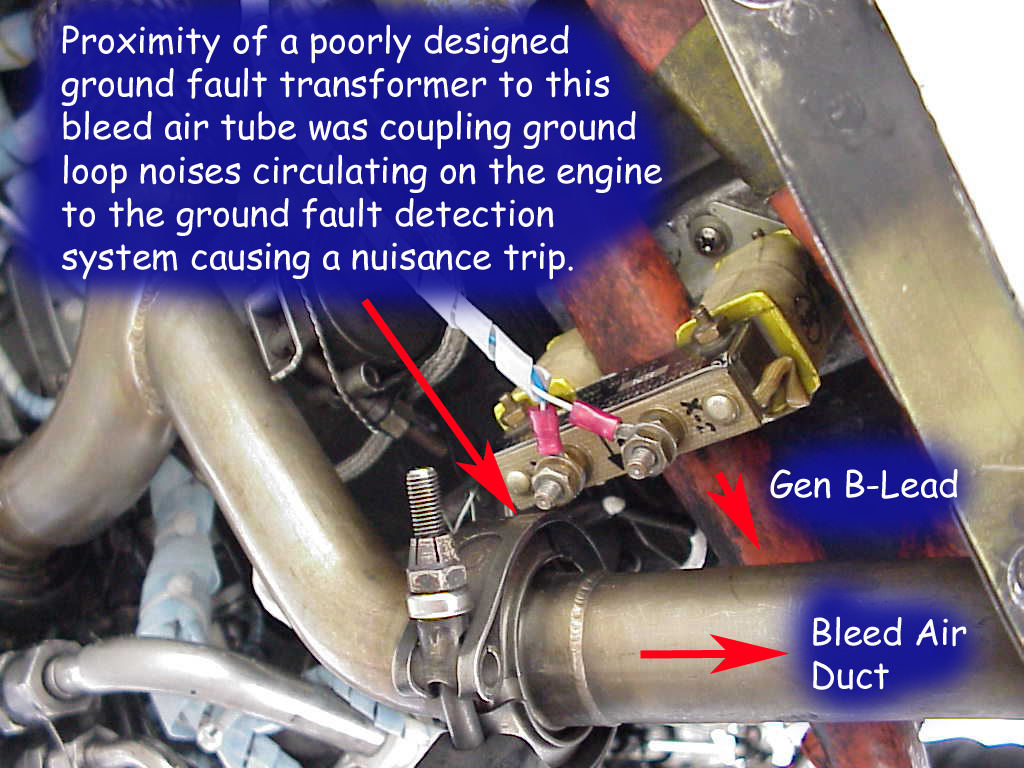

cause is indicted . . . and not easy. I've had
occasion to chase down two such events; one on
a Europa and the other on a Beechjet. The first
one was fairly easy, the last one cost mucho
Kilobux before root cause was located and
remedied. After more than a month of diligent
attention from field service, I instrumented
the fault detection circuitry in the generator
control unit and conducted a bunch of tests
that eventually pointed to the ground fault
transformer as the source of the antagonistic
signal. The signal cropped up on this aging
airplane as ever increasing ground path
resistance rose with time. Built a sheet metal
bracket to relocate the transformer 1 inch further
away and the noise disappeared!

test. I'll be we 'tripped' that Beechjet 20+ times
before we found the problem.

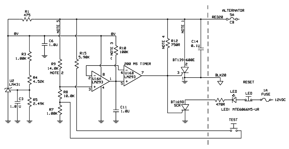

Eric: My 2nd question is resolved by Rev P3 but I'm still curious about questions 1, 3 and 4.
Ach!!! Sorry 'bout that!

1. Absolute maximum cathode-to-anode voltage on the LM431 is 37V (see TI and onsemi datasheets). A significant OV event could exceed that limit until the crowbar brings bus voltage under control. This might not be an issue with a lead-acid battery, but the OV behavior of the BMS in lithium batteries is unknown. If a lithium BMS disconnects pronto, bus voltage could rise farther and more quickly than with lead-acid on the job.
Q: Should there be a 33V Zener in parallel to protect the LM431?
The LM431 IS a zener. It's biased up thru
392 ohm R1. So the 10V Vcc rail is rigid.
If anything is at-risk from a bus voltage
excursion, it's probably R1.
2. The recommended maximum voltage on LM293 inputs is Vcc minus 2V (see table 6.2 in the TI datasheet). In this case Vcc is 8V, so the max input voltage is 6V.
- The 7V reference exceeds 6V on the inverting inputs of both comparators.
- Any bus voltage >13.64V will exceed 6V on the non-inverting input of U16A.
- Timing capacitor C11 on the non-inverting input of U16B will charge to 8V.
Yeah, raised Vcc to 10V. Changed trip reference to 2.5V.
The Non inverting input to U16B will not exceed 8V 'cause
that's where the SCR trips.
Q: Should the comparator reference be adjusted downward (perhaps delete R4, adjust R3/R5, and use the LM431's 2.5V reference for the comparators)?
Yup.
Q: Should the non-inverting inputs be protected with 5.1V Zeners?
Nope . . .
3. In recent discussion of the OVM task you mentioned your intent to make the trip delay 500mS +/- 50mS. This schematic provides ~200mS.
Q: Have you reconsidered the 500mS trip delay?
Not necessarily. Legacy OVM management devices were oblivious
to the 20V for 1 second qualification requirements under DO160.
Powers that be were fond of the 50mS value for step response from
14.2 to 20V. I think I mentioned having offered a very
similar configuration and running the delay out further.
Early days solid-state latches for OV management were plagued
with nuisance trips very short, low energy noises on the
bus that would do a dv/dt trigger of the scr. Ultimately
managed with the 0.1 uF cap right across the SCR combined
with low value resistor gate to cathode (which drives
up required trigger current).
This design now ties the gate to ground through the open
collector output of U11B. I'm anticipating dv/dt issues
to be irrelevant.
AS to selection of time delay certainly much longer than
50mS and much smaller than 1 second. 500mS seems like a
happy medium but given the self-resetting nature of the
comparator/timer, 200mS is probably comfortable too. Either
value honors design guidance of DO160/Mil-Std-704
The current proposal offers a way to select ov trip,
maintenance trip and trip delay values with a simple
adjustment of resistors.
4. Schematic Note 1 contemplates a crowbar current of 100-200A DC for 25mS. The BT139-600E SCR datasheet shows a peak non-repetitive on-state current of 155A, but that specification assumes an initial junction temperature of 25degC (unlikely under an engine cowling), a pulse duration ≤20mS and a full-sine-wave AC pulse, not DC.
Those have been proven conservative . . . especially
in later years of SCR offerings. Beech had a qualification
requirement to effect 50 shutdowns in a row, each
about 2 seconds apart, with the 51st still in spec.
That protocol arose from the fact that the weakest
link in contemporary ov RELAY designs was relay
CONTACTS failing to break the inductively stabilized
ARC. Powers that be assumed that no airplane would
every experience 50 OV events, hence the BIG HAMMER
test.

Q: Can the BT139-600E handle this crowbar task? If not, could you swap U16B's inputs and interpose a P-FET to trigger a beefier SCR?
Don't think this will be necessary. All of our OVM-14
versions used SCR's with rather benign single cycle
ratings. But just for grins and in honor of Jack Thurman's
skeptical testing protocols, I'll do the 50x test at 100A.
I'll go rescue my environmental chamber from a
lab in Wichita so I can test it at temperature . . .
say -20 to +150F.

Wow! Thanks, Bob. That was WAY more than I expected. Sometimes
I feel like I should be making student loan payments for what I learn
on this forum.
nuckolls.bob(at)aeroelect wrote:
The LM431 IS a zener. It's biased up thru 392 ohm R1. So the 10V
Vcc rail is rigid. If anything is at-risk from a bus voltage excursion,
it's probably R1.
Ugh. That's pretty obvious when I read it and look at the schematic again.
More learning...
The Non inverting input to U16B will not exceed 8V 'cause that's where
the SCR trips.
After reading the datasheet again, I can see that protecting the non-inverting
inputs is a non-issue. The Vcc-2V figure is an operating recommendation; the
absolute maximum is 38V. In the case of your P3 schematic, it would take 247V
on the bus to exceed that limit on U16A!
AS to selection of time delay certainly much longer than 50mS and much
smaller than 1 second. 500mS seems like a happy medium but given the
self-resetting nature of the comparator/timer, 200mS is probably comfortable
too. Either value honors design guidance of DO160/Mil-Std-704.
The current proposal offers a way to select ov trip, maintenance trip and trip
delay values with a simple adjustment of resistors.
Got it. Exact delay value is unimportant, as long as it responds fast enough to
protect and slow enough to avoid nuisance trips.
...the weakest link in contemporary ov RELAY designs was relay CONTACTS
failing to break the inductively stabilized ARC.
OK, here's where I have another question. My application for OV protection is on
a Rotax 912iS, which has a built-in 450W 3-phase PM stator. Since I can't corral
a stator by blowing a breaker, I'm adapting your design to drive relays.
I've chosen an automotive relay with integral coil-suppression diode and contacts
rated for 75VDC at 40A:
https://www.digikey.com/short/n8qhp98t
Do you think that relay is likely to have any trouble breaking each leg of the
Rotax stator feed? I'm guessing not since it's an AC circuit, but guessing has
a poor track record...
-Eric
Sure . . . in terms of avoiding catastrophic effects.
It seems more righteous to design for operational robustness.
So if the device is to avoid 'going blind' then Vcc-2 is
the target. Our voltage divider factor is 0.156 so
16/0.156 yields 51 volts. Well outside the expected stresses
described in Mil-STD-704.
Yup
YES!
That will work. Those relays COULD be the
ALT ON/OFF control devices powered through a breaker
just like the field of a wound-field alternator.
The control switch would pull to ground. The
CBOVM module would tie to that supply breaker without
modification.
Not at all. Remember that relay are rated
based on laboratory tests proving service
life on the order of tens of thousands of
cycles.
Okay, suppose you fly twice a day . . . how
long would you expect the relay to last?

Hmmm, yeah, that would work too... I've got a MOSFET switching the low
side of the relay coils, and an illuminated (sorry, I'm in the blinky light
camp!) reset/isolate pushbutton on the panel that will indicate a tripped
condition and provide pilot control or reset.
Since I'm not blowing a breaker, I'm just pulling the 2nd comparator's
reference input to ground to form a latch.
Okay, suppose you fly twice a day . . . how long would you expect the relay to last?"
Well, the relay's electrical life is 100,000 cycles at rated load. If you assume
each flight is one hour in length and there will be an OV event once every
1,000 hours (wildly pessimistic), then the relays will reach end of life in
>136k years. That should be long enough!
I caution against using the normally closed contacts of your control relays
to open 2 of the three stator leads. Failure of a relay coil offers an opportunity
for a latent failure not readily pre-flight detectable.
The relays are SPST-NO type, and I was planning to use three of them in
parallel, switching all three phases of the stator's output. I won't pretend to
be knowledgeable about 3-phase AC systems; is there a better way to do this?
Assuming the regulator isn't designed to quit when one stator phase drops
offline, and it continues working from the remaining two phases, how would
one detect -- or pre-flight test for -- a single relay failure?
The only thing that comes to mind is to monitor all three phases after the
relays, and if one is missing, light a "Phase Missing" indicator. It's an
interesting problem to think about when you have no idea how much AC
voltage might be present on each phase over varying engine speed and
regulator load...
Thanks, Bob.
-Eric
That would work too. I tend to gravitate toward
a minimal parts count utilizing as much off-the-shelf
process as possible. The popped breaker is inherently
'latching' and the current state of the CBOVM should
become off-the-shelf.
Yeah . . . sometime I need to share my own
life-of-the-relay story . . .
You only need to switch two leads to completely
shut down the alternator.
Loosing one phase severely hampers alternator
output . . . although in some instances it may
not be immediately obvious. Had a Chevy Vega many
moons ago that needed an alternator change-out
due to brush wear. When I opened it up, I found
one stator phase winding was cracked and disconnected
due to arcing in the gap . . . a condition that had
to have existed for quite some time.
The car didn't have a/c and no especially heavy
loads. Turns out it functioned well on only 20
amps or so of a 60A alternator's rated output. I
might have noticed it earlier if the car had been
fitted with low voltage warning or even a battery
ammeter.
Do you plan for alternator b-lead instrumentation?
Dynamic behavior after start up will be profoundly
changed should on phase become disconnected. Also,
the rate at which the bus voltage comes up after start
will be slower. This would be a good experiment to
conduct during your fly-off.
But yeah, loss of a single phase doesn't 'kill'
the alternator. Most 3-phase regulators will function
as a single phase device . . . I've got some experiments
planned to confirm this.
regulator load...
Voltage isn't a good indicator of alternator
health; CURRENT is. If you're really interested
in a loss of phase detector three, open loop
current sensors could be set up to annunciate
zero current in the phase lead.
Your fly-off experimental measurements should
produce a more considered foundation for adding
such a feature. Unless there's a history of
failures in the particular product, this feature
may be as useful as monitoring for loose prop bolts.

Here's how I'm putting in a panel. This is the distribution panel on the right side of instrument panel.
Note top row. The "Trip" is a red LED. Top row is all about the alternator...
PDF attached

I think what drove me in that direction was the fact that I'm using fuse blocks
instead of breakers. I don't really want a lone breaker on the panel for OVM
purposes and blowing a hidden fuse creates a hassle, so the self-latching
circuit was an attractive alternative. It just added one transistor.

Hmmm, OK... I just mentioned phase monitoring as a means to detect a
failed-open OVM relay contact. I don't really need/want to measure phase
current; I thought that simply detecting whether or not each phase is active
after the relay (i.e. voltage is present) would suffice.
Hypothetically speaking, could each phase leg be half-wave rectified, filtered,
and its presence detected with reference to airframe ground? Or, does each
phase somehow have to be measured with respect to the others? Would it be
necessary to maintain any kind of isolation in a circuit like that?
