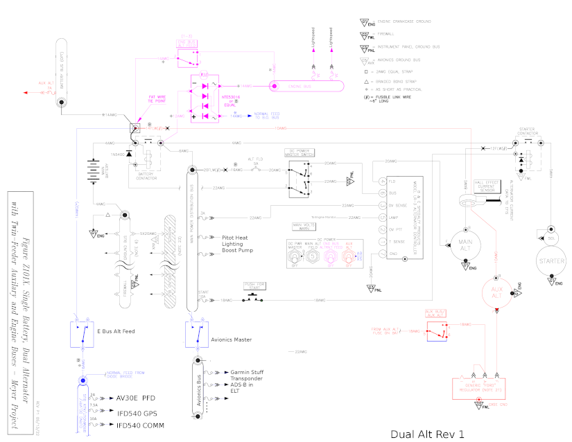

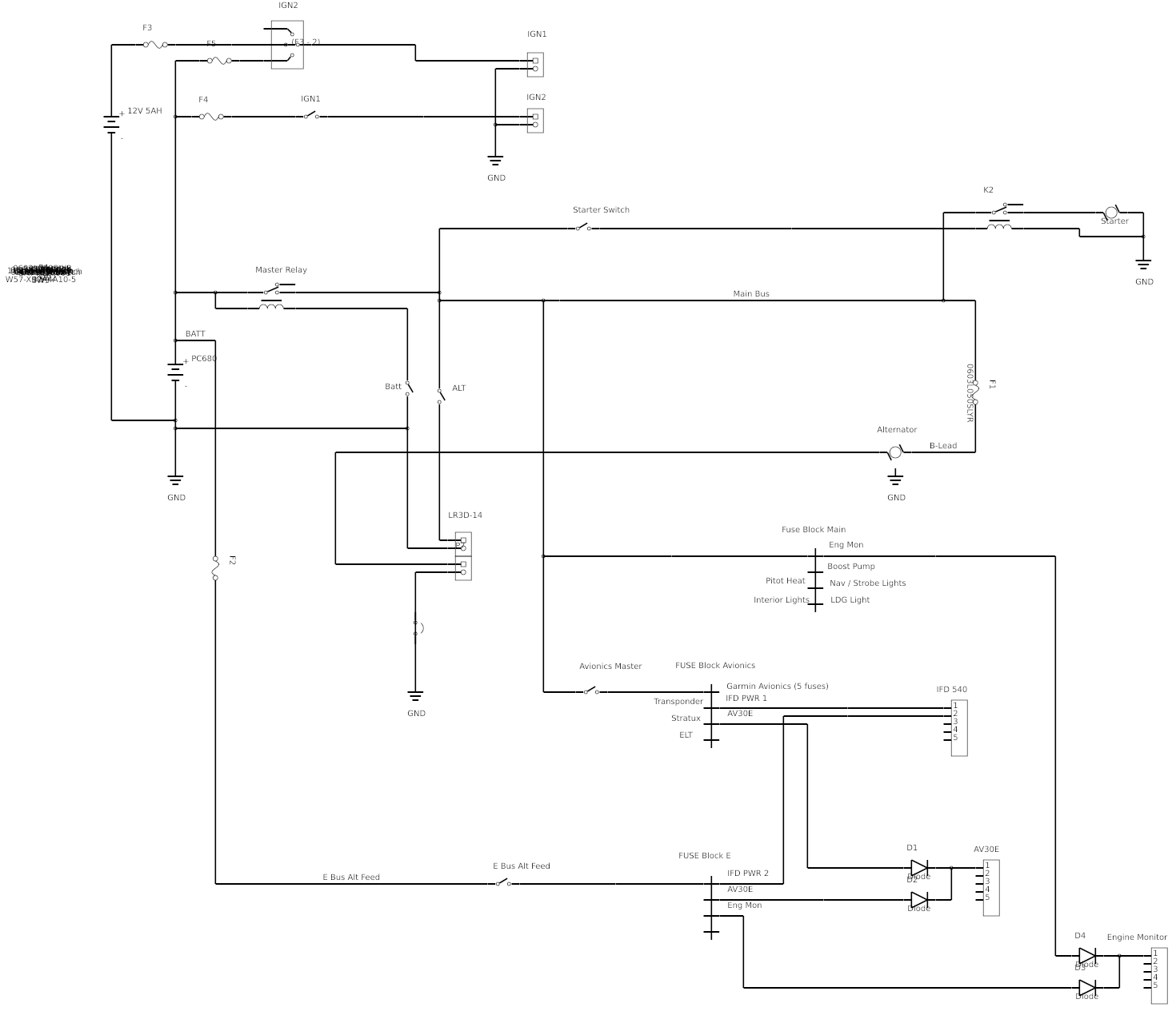

PostPosted: Tue May 10, 2022 8:04 pm    Post subject: Re: Too many Circuit breakers.... Reply with quote
Drew this up in upverter.com... Not the best for schematics, but I think this gets the idea across. Pinouts of devices aren't defined here. Fuse Blocks are the above recommended fuse blocks.
The AV30E needs at most 2 amps. (attitude indicator)
The Engine Monitor needs at most 1 amp.
The IFD GNS side - max 7.5 amps, but it's got diode OR'd inputs on the GNS side.
IFD Comm side doesn't have dual inputs for some reason. Might diode OR those externally - needs 10 amps.
If no to the diodes, what bridge rectifier is recommended?
Those are the 3 things I need to get somewhere if things go bad. Master relay craps out, etc...
Not sure if this link will get you to the source drawing, but it might... https://upverter.com/design/meyerkc135/62568e2b082ab4c7/aircraftarchitecture/
Plan is to replace the PC680 and the backup battery every 3 years.
Trying to keep it simple. Looking at what I currently have, I've got little protection from the dark and stormy, though I can (with conservative weather planning) get somewhere on one mag and the AV30 (backup battery). I'm loosing the mag for the second ignition.

PostPosted: Wed May 11, 2022 8:53 am    Post subject: Too many Circuit breakers.... Reply with quote
At 11:04 PM 5/10/2022, you wrote:
--> AeroElectric-List message posted by: "andymeyer" <meyerkc135(at)gmail.com>
What engine are you planning?
out of that stuff?"

PostPosted: Thu May 12, 2022 5:51 pm    Post subject: Too many Circuit breakers.... Reply with quote
Bob,
It's an O-235 C1C with 8.5:1 pistons and dual Lightspeed Plasma III's. Carbureted... No vacuum system or mags. She's flying right now (with 1 mag, 1 Plasma III), but our ramp shuts down for 10 weeks so I'll be doing this upgrade then.
My diagram is somewhat derived from the Z11 (might be an older version since it still had the AEC9001-1 in it - I bought your book years ago...
Why no second alternator on the vacuum pump pad?

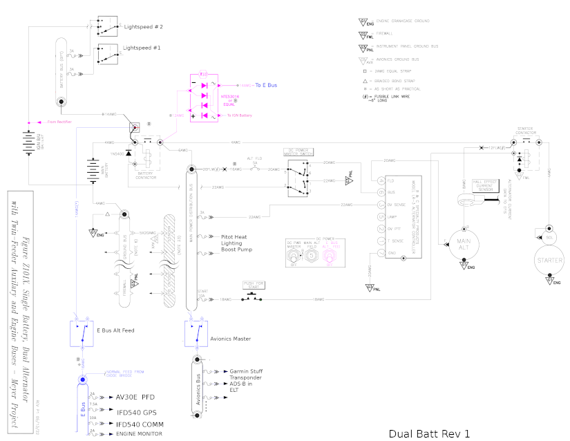

PostPosted: Thu May 12, 2022 6:08 pm    Post subject: Re: Too many Circuit breakers.... Reply with quote
Bob,
The SD-8 concerns me 'cause if I lose the electric system, I lose the engine which means I won't get enough power out of the SD8 (low RPM) to run the ignitions to restart.
Got an option that makes sense, or can you talk me into the SD8?
I still wonder about master switch failure - I think I have that covered in my design above. Engine, monitoring, attitude and GPS.
Andy

PostPosted: Fri May 13, 2022 3:17 am    Post subject: Too many Circuit breakers.... Reply with quote
Why not base the design on Bob's Z-101? Seems that you are recreating the wheel.

PostPosted: Fri May 13, 2022 8:56 am    Post subject: Too many Circuit breakers.... Reply with quote
Bob,
What is the condition(s) that would cause
you to 'loose' the electrical system?
This is what FMEA is all about. Go through
a thought exercise that considers 'what if'
for any single failure . . . switch broke . . .
wire falls off terminal . . . pump gets
asthma . . . regulator quits . . . etc. ect.
The process is pretty simple:
First deduce the ways in which the part
can fail.
Terminal falls off, regulator goes
silent, regulator goes wild, bulb
burns out, handle falls out of switch,
contactor sticks closed, etc. etc.
How will you become aware that the failure
has occurred?
Something quits working . . . something
wildly mis-behaves . . .
Is the failure pre-flight detectable?
Yes? Make sure it's on your checklist.
No? What are your periodic inspection plans
for assessing that system's airworthiness?
How does this failure affect the probable
outcome of your flight?
The vast majority of failures on airplanes
are no big deal . . . FBOs make their
living fixing no big deals . . . well . . .
it's usually a big deal to the wallet but
at lease your airplane isn't bent.
If koss of that feature poses risk to your
maintaining order in the cockpit, what are your
plan-b protocols for dealing with the failure?
Check out the PowerPoint slides for my
weekend seminars at:
http://aeroelectric.com/Reference_Docs/Seminar_PP_Slides/
. . . in particular, the packet on Failure

Just for grins, let's test the utility of Z101 for
your project. See:
https://tinyurl.com/y3yyjjqp
Let's make this a List exercise to go over the
possibilities. If you were to use the
cited drawing as is, what loads would you
assign to each bus?
Will you need brownout boosting? Are
you interested in being able to fire up
some radios in pre-flight? Let's get
all your proposed electro-whizzies
lit up on some bus.
Then let's see what might be eliminated
for simplicity/cost without sacrificing
untility.
David,
Yes - looked at the Z101 - wasn't in my old book - or at least I missed it. Modifying it to use the rectifier to support the E bus.
Bob,
The failure that comes to mind is the master switch opens or shorts and pops the fuse link for some reason (failed connection, failed relay, etc...) EBus solves this - gets me on the ground with an attitude, engine monitoring and GPS.
Alternator failure, regulator failure, OV trip, etc... that won't recover - EBus gets me on the ground.
Battery failure - very low risk . . .
But can you make it zero?
. . . but my AV30 stays alive and the second ignition battery keeps the fan spinning.
. . . yup . . . those are all FMEA bullet points
each presenting its own cause/effect/probability
factors.
Very well . . . sounds like you have a plan.
Please include ALL batteries in your periodic
airworthiness verification protocol.
Fly comfortably

Thanks! I've got other builders watching our learnings here closely so... Smile
I added the appropriate loads to where they need to go.
Main bus: (breaker size)
Pitot: 20A
Lighting: 10A
Boost pump: 5A
Starter Relay
Avionics Bus is:
Garmin stuff is 15 A (incl Audio panel)
AXP 322 + Stratux = 5A
ELT 1A
E Bus:
AV30E - 2A
Engine Monitor - 2A
IFD - 17.5A (GPX+Comm)
No need for brown-out boosting if I put the Avionics master in, Yes, if I don't. The Garmin items that I'd want brownout protection on all have internal diode or'd inputs so I can put the brownout booster on power #2 and it'll keep it awake. Same with the Avidyne IFD. AV30 will stay awake with it's internal battery. Engine monitor runs down to ~4.5 volts on the input. Okay, you just talked me into brownout boosting - booster + a few wires - simple. (Fuse to the booster, then do I also fuse each output line of the booster?
I modified the diagram to two versions - one dual alternator, one dual battery.
I was wondering why all of the relays - can we not get good switches to handle these loads, or is the relay + small switch + connections(7) more reliable than a higher power switch + connections (2) ?
Dual Alt Preflight:
Pre-flight... EBus on - check that the AV30 wakes up. Master on, EBus off.
Run up... Eng Bus Alt feed on, Master off - make sure engine keeps running. But, everything else goes dark for this check???
Aux Alt to middle position, master off, make sure things don't go dark, check voltage, Aux alt up, check voltage rise (>13, but need higher RPM with SD8), aux alt to middle, Main alt on, Aux alt off, recheck voltage > 13.0
Annually, load test battery.
Major electrical failure: (failed master, shorted master bus, loose wire to master...)
Everything goes dark and quiet except battery bus and AV30.
Aux Alt on. E Bus wakes up and starts powering up.
Mixture - cut-off. Eng Aux bus on. Mixture rich. Things get noisy again.
\n
Dual Batt pre-flight:
Run-up... Ignition - test #2 on both normal and standby power.
Annually, load test both batteries.
Everything goes dark except battery bus and AV30.
EBus alt on, IFD comes back up. monitor voltage on main battery. AV30, IFD and engine monitoring remains.
When main battery is < 6V, then move ignition #2 to middle position - #2 battery. 5Ah, ~2 hours of flight time with AV30 battery and engine monitoring. Engine monitoring dies around 4.5 volts.[/b]
 Filesize:  121.09 KB
 Viewed:  11944 Time(s)
 Filesize:  131.29 KB
PostPosted: Sat May 14, 2022 10:22 am    Post subject: Too many Circuit breakers.... Reply with quote
Bob,
Pitot: 20A
Lighting: 10A
Boost pump: 5A
Starter Relay
Avionics Bus is:
ELT 1A
E Bus:
AV30E - 2A
Engine Monitor - 2A
<snip>
Very well. I'll let you guys 'fill in the blanks'.

user9253
Joined: 28 Mar 2008
Posts: 1978
Location: Riley TWP Michigan
PostPosted: Sat May 14, 2022 12:18 pm    Post subject: Re: Too many Circuit breakers.... Reply with quote
If the battery contactor fails open, everything will NOT go dark. You probably won't even know that that it failed because the aircraft electrical system is normally powered by the alternator. You might notice some voltage instability, but won't know the cause. The voltage regulator might be failing.
One reason for using a relay is to handle current that is greater than the switch ampacity. Another reason for using relays is for remote control. The pilot should have the ability to shut off all electrical power as close to the source as possible. Suppose the plane makes a forced landing that results in leaking fuel. The pilot might not be able to exit the aircraft due to aircraft damage or pilot injuries. If the electricity is shut off at the source, there is less chance of sparking wires igniting fuel. Why not wire your plane per Z-101? I has passed peer review. Z-101 does not have an avionics switch to fail.
