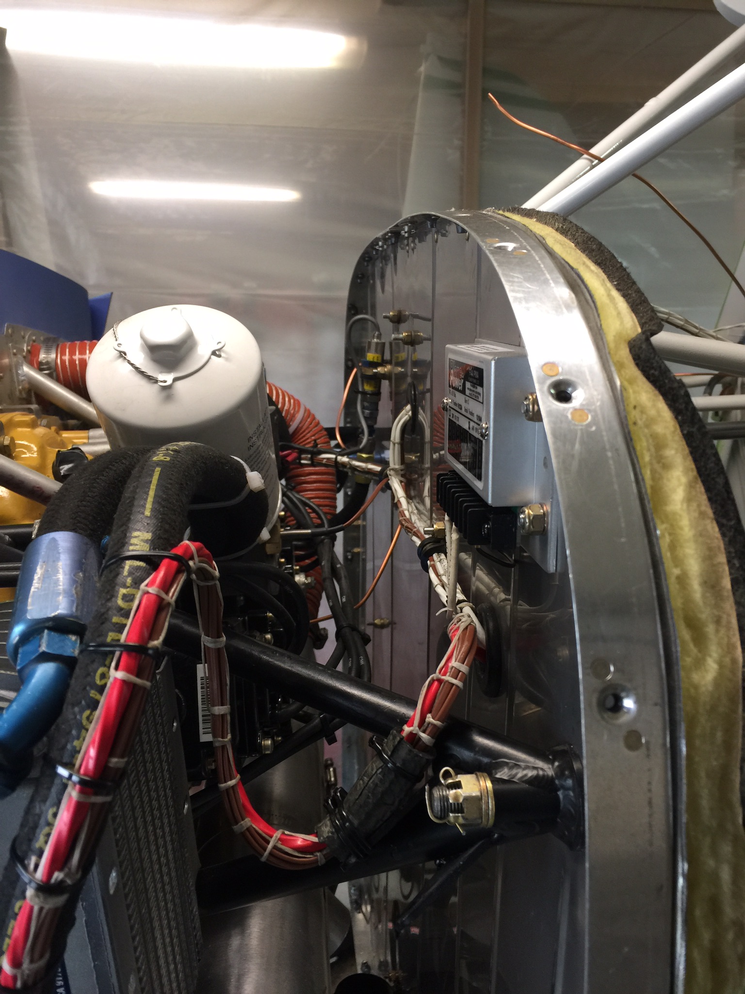

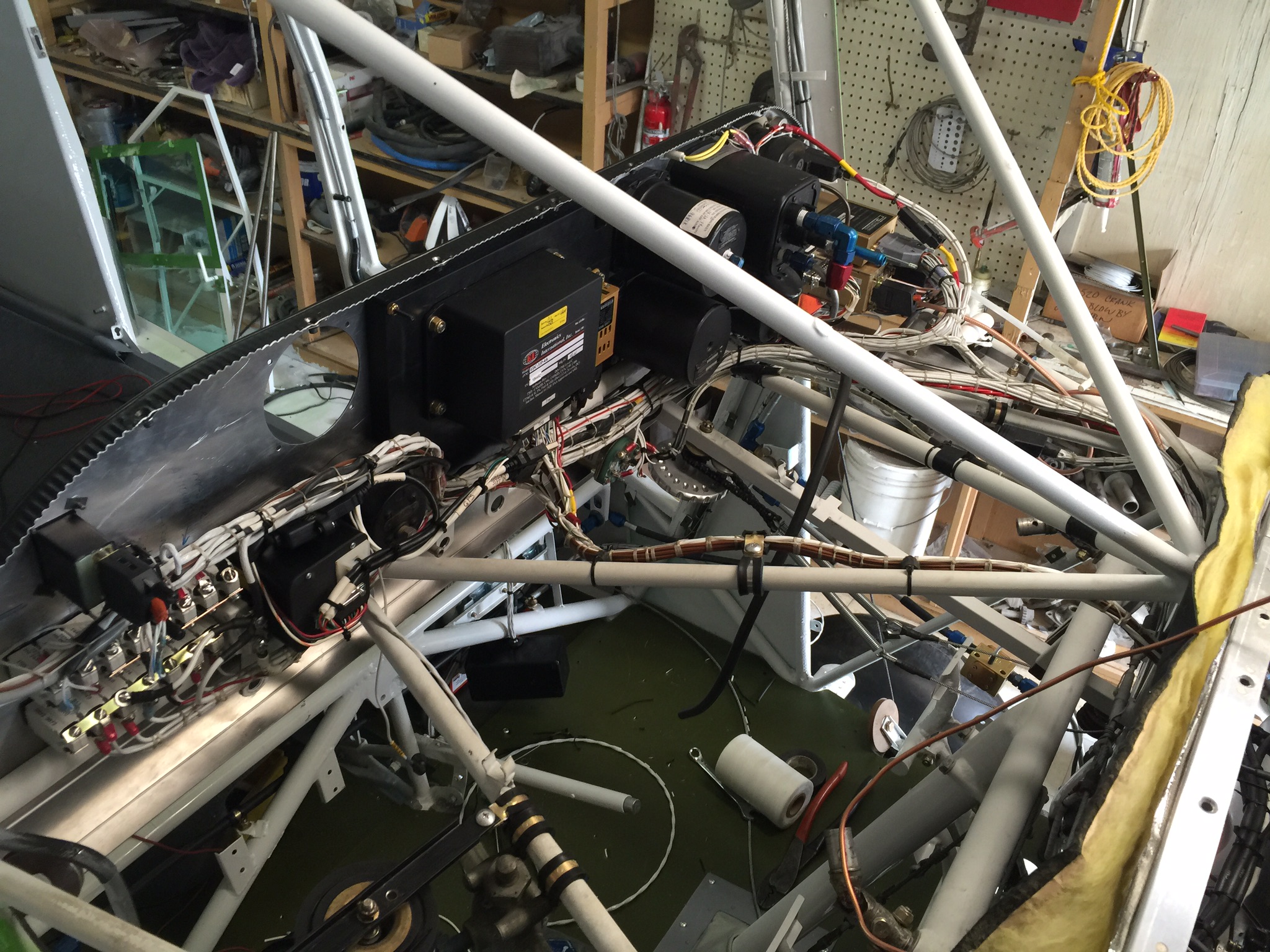

PostPosted: Mon May 10, 2021 1:52 pm    Post subject: Thread Lacing Tape Reply with quote
Laced mine...under the boot cowl and firewall forward...much nicer and less likely to cut oneself on the sharp stub from the tie wrap...if you don’t use flush cutting snips. I cut off all the tie wraps after lacing...[img]cid:7D3AC529-C16D-45B9-86A4-423219A18D4A[/img][img]cid:A3EA37F0-5C1E-468E-8541-F951E4B745E9[/img]

PostPosted: Mon May 10, 2021 3:14 pm    Post subject: Thread Lacing Tape Reply with quote
High temp cord or standard for FWF?

PostPosted: Mon May 10, 2021 4:47 pm    Post subject: Thread Lacing Tape Reply with quote
Standard lacing has worked fine for me for 15 years even when on things
that run a little over 100*C.
