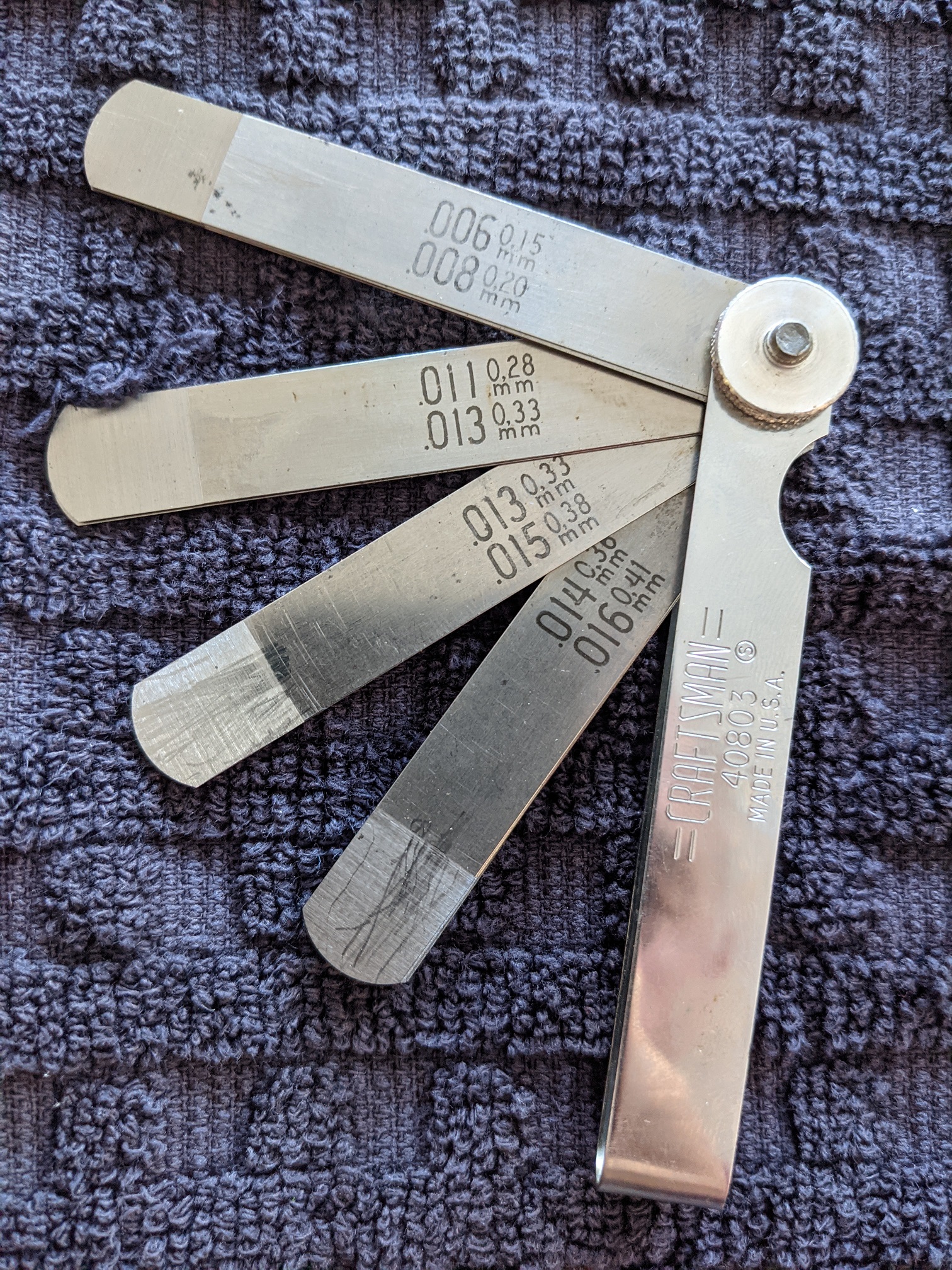

PostPosted: Fri Apr 30, 2021 1:02 pm    Post subject: Housai engine question: compression check Reply with quote
Fast question... what's the req'd torque in the rocker arms' jam nuts ?What # has everyone used?

PostPosted: Sat May 01, 2021 6:38 am    Post subject: Housai engine question: compression check Reply with quote
Justin,
As always, Walt is spot on with the advice below.
One suggestion to make this task a bit easier and more accurate is to use a step feeler gauge when setting the clearance. The thickness of each blade is reduced by 0.002 inch at the end; making it a GO / NO-GO gauge. For a 0.014 clearance, you would use the 0.013 / 0.015 blade.  Set correctly, the thinner portion of the blade will slide smoothly under the rocker arm and then stop at the thicker portion. Craftsman appears to have discontinued the set shown in the photo but Stanley Proto and others are available on Amazon.
Rich Desmond

> On Fri, Apr 30, 2021, 10:04 PM Walter Lannon <wlannon(at)shaw.ca> wrote:
>> Hi Justin;
>> I too have not seen a specific torque value for the rocker arm nuts.
>> However there are two special tools for this purpose. The wrench is an
>> open socket style with a fixed handle used in combination with a right
>> angle screw driver that is positioned through the open socket to hold your
>> adjustment position while tightening
>> The operating word is as tight as you can get it with this wrench.
>> Re-check all clearances after tightening. Technically this whole
>> operation should be done four times. With the P &W R1340 that is a must!
>> due to something called a floating cam ring. These engines do not have
>> that problem but if you If you find any significant changes do it again

I too have not seen a specific torque value for the rocker arm nuts.  However there are two special tools for this purpose.  The wrench is an open socket style with a fixed handle used in combination with a right angle screw driver that is positioned through the open socket to hold your adjustment position while tightening .
Re-check all clearances after tightening.  Technically this whole operation should be done four times.  With the P &W R1340  that is a must! due to something called a floating cam ring.  These engines do not have that problem but if you If you find any significant changes do it again.
It is a straight forward operation for the intake valve but the engine should be rotated slightly to provide clearance of the wrench for the exhaust nut.  This would apply for any socket type wrench.  If that clearance is not obtained there is a real possibility of damage to the nut.
I expect you have noticed there is a light spring pressure that closes up the valve clearance.  At first glance one may think there is no clearance.  This spring is at the opposite end of the push rod and has nothing to do with valve clearance in operation.  It’s purpose is to keep the cam roller in constant rolling contact with the cam ring to reduce wear.  You can see this spring operation by pressing the nut end of the rocker with your finger.
The feeler guage should be used at right angles across the width of the rocker box.  That will appear obvious since using in a fore & aft manner will introduce interference and likely produce errors.
I have found over the years that the exhaust valves tend to tighten over time and as a result I use 0.012” for the intake and 0.014” for the exhaust whether Huosai or M14P.
I will send you some photos of the proper tools tomorrow.  Will need your phone #.  Mine is 250-485-8698.

Ok helpful gents and engine experts-
A fruitful sunny day spent (at) hangar with the suspect cylinders.
Checked the small starting air valve: definitely in good working order and closing as appropriate.
Pulling off rocker covers and watching the rocker arm and valve springs, I see there is
no gap at TDC between the rocker arm and top of the spring /stem for cylinders #2 and #3.
Just so I'm understanding valve lash / clearance correctly:
-  the 0.010-0.014" clearance mentioned is supposed to be here at the red circle in the
attached pic, correct?  (While the stem is at its highest point of travel/valve fully seated/TDC...)
-adjusting this clearance/lash requires turning the large adjustment screw at the green arrow, correct?
Based on the air I hear escaping the exhaust stack, I suspect the exhaust valves are sticking or
otherwise remaining open.
Not sure how I went from great compression #'s last year to 0/80 psi this year, but very little surprises
me in maintenance anymore.
Thoughts gents?
Thanks-   Justin

I haven’t, but I tend to agree with Walt, the length of the wrench is a good index to what they were expecting from Atilla the Valve lash avenger👍👍
On Sat, May 1, 2021 at 10:41 AM Justin Drafts <draftsjust417(at)gmail.com (draftsjust417(at)gmail.com)> wrote:
Great tools John!Very helpful pix as well.. ages back I'd ordered a batch of poorer-quality PLAAF tools,  it's good to see better ones avail.
Btw, have you ever seen the proper torque for the rocker arm jam nuts?
(I can't find any such reference in my maint manuals...)
On Sat, May 1, 2021, 10:11 AM John Warwick <john.warwick1(at)gmail.com (john.warwick1(at)gmail.com)> wrote:
No problem at all Walt, glad to be part of the discussion 👍👍
On Sat, May 1, 2021 at 10:03 AM Walter Lannon <wlannon(at)shaw.ca (wlannon(at)shaw.ca)> wrote:
Hi John;
Please accept my apology for forgetting your superb tooling.  At 88 my memory is certainly not what it once was but will try to do better in future.
Best;
Walt
From: John Warwick (john.warwick1(at)gmail.com)
Sent: Saturday, May 01, 2021 9:07 AM
Subject: Re: Re: Housai engine question: compression check
Repro valve adjust tools available
https://www.th_Repro.html
On Sat, May 1, 2021 at 8:30 AM Justin Drafts <draftsjust417(at)gmail.com (draftsjust417(at)gmail.com)> wrote:
Hey Walt, thanks for all the details... Ya, looking at the engine yesterday, it seems like a straightforward operation, with the right tools.

On Fri, Apr 30, 2021, 10:04 PM Walter Lannon <wlannon(at)shaw.ca (wlannon(at)shaw.ca)> wrote:
Hi Justin;
Cheers;
Walt
Thoughts gents?
Thanks-   Justin

PostPosted: Thu May 13, 2021 7:51 am    Post subject: Housai engine question: compression check Reply with quote
Good morning all-
Update to the compression check, w/ good news.
Checking & resetting the valve clearances (0.3/0.4 mm) on all 9 cylinders did the trick;
the lowest # I got on all compression checks was a comfortable 73/80 psi. Latest takeoff
felt like I had a bit more giddyup as well, no surprise.
THANKS ALL for the good advice, much appreciated.
Justin
