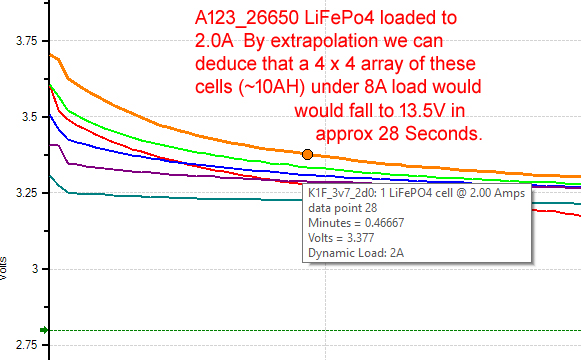

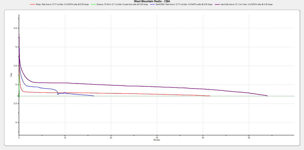

Just for grins, I plotted Time-to-12.7v
for four batteries. An AeroVolts, an
exemplar EarthX, a Miady 16AH device
and just for the heck of it, a fresh
Enersy 16AH battery. Plots attached.
I've also included a test for a A123,
26650 cell where I deduce that a 4x4
array of these cells in a 14v system
battery would fall below 13.5 volts
in about 30 seconds.
I suggest these plots show that a 13.5
volt lo volts warning threshold would
be suited to all chemistries. Note that
the SVLA falls like a rock to well under
12.7 when it looses alternator support . . .
well, it IS a 12v battery while LiFePO4
devices are generally considered to be
13.2 volt batteries (although AeroVolts
labels theirs as a 12V while the plots
show that it has the highest alternator-
out voltage of the lot).
Hence, I stand better informed and
agree that the legacy LR3 configuration
is unsuitable for lithium battery management
without (easy to do) modification as
is our AEC9005 LV Warning Module.
