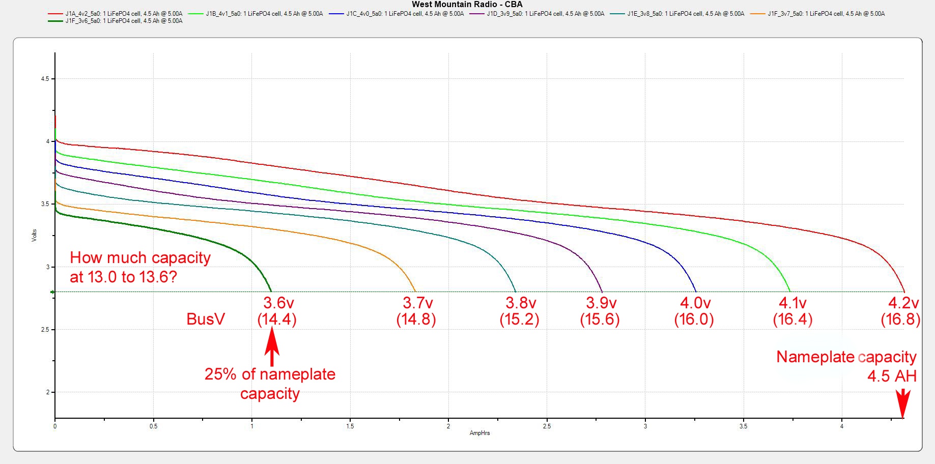

Look at the charge volts vs. capacity curves
again . . . dropping the bus to 13.4 (3.35 volts
per cell) or even 13.0 (3.25 volts per cell)
leaves you with a battery that is essentially
useless for (2) above.

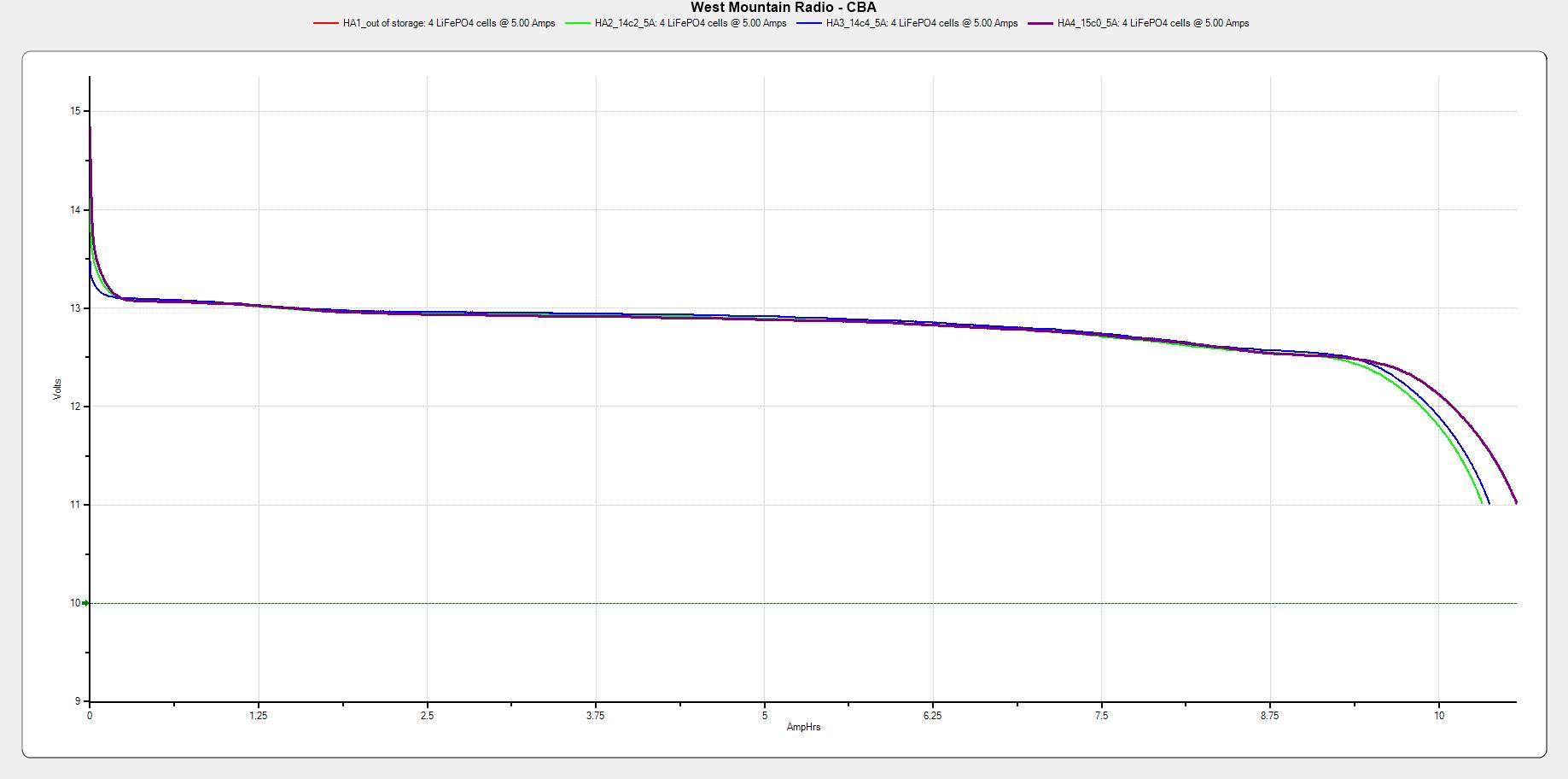

I've got EarthX and AeroVoltz batteries on
the bench now that have been getting characterized.
Based on what's been gathered so far, both products
do indeed get your engine started . . . but when
charged at 14.2-14.4 volts, their discharge curves
look very similar to the plots I've been
getting on energy-starved, individual cells.
I'm thinking that BOTH products have untapped
chemical potential that is not available for
operating an airplane during alternator out
conditions. I think this shines a spot-light
on early lithium marketing claims for "lead
acid equivalency" and "engine starting battery".
Both terms sort of hat-dance around the capacity
issues forsaken in a quest for the holy-grail
of lighter weights.

I've expanded the annotation on the charge volts
vs. energy stored plots I posted previously. These
further emphasize that when operated 'per
manufacturer's recommendations', the battery
will contain perhaps 25% of it's potential
storage for the LiFePO4 chemistry.
If anyone has information to the contrary, I'd
be pleased to know it! I'd really like to be
wrong about this . . .

OK. I'm missing something major here. Earlier you stated:
Take a peek at the capacity vs. charge voltage
plots. A 3.6 volt charge (14.4v bus) would
charge an LiFePO4 to about 25% of its
potential chemical potential capacity.
The chart you shared showed it clearly. To get to the 100% capacity on the charging plots you shared, I'd need to run a bus voltage of 16.8V (4.2V/cell).
Below, you're saying that 14.4V will be fine. I'm thinking, "How could 25% of capacity be 'fine'?" I've obviously lost the plot somewhere in here.

Yes, you missed the irony of my observations.
The plots I published so far show the voltage vs.
capacity characteristics of a single, 'barefoot'
cell. These are generally marketed as flashlight/
tool/electronics batteries. Almost without exception,
you cannot achieve the advertised capacity unless
the cell is charged to the maximum, 4.2 volts
rating . . . which translates to a bus equivalent
of 16.8 volts.

Check out the attached plots on an EarthX
ETX36D battery I've had on hand for a few years.
There are three plots where the battery was charged
at 14.2, 14.4 and 15.0 volts. Note that unlike
the plots on individual cells, these all lay
practically right on top of each other . . . all
three show a battery capacity of 10.2 to 10.6 A.H.
This tells us that the BMS is in control of how
cells in this battery are charged INDEPENDENTLY
of the charging voltage. Stepping up your alternator
output voltage with some hope of exploiting latent
battery capacity would not be fruitful . . . and
possibly harmful to other electro-whizzies in the system.
The data I've gathered so far seems to say that
cells incorporated into batteries for lead-acid
replacement are DE-rated by design of the BMS.
This doesn't mean that the lithium batteries
offered do not deliver to their nameplate ratings . . .
it simply says these batteries contain chemical
capability that cannot be exploited in
a 14 VDC system.

But three LiFePO4 cells stacked gives us a charge
(bus voltage) of 12.6V and a discharge (alternator-out)
voltage of about 11.1V. Decidedly incompatible with
the legacy lead-acid world.
Okay, cells stacked gives us a bus voltage of 16.8 and a
14.8V alternator-out voltage. Again . . . not a drop-in
replacement.
Some folks have decided to offer 4-stack batteries
with no 'smarts' and which will be charged to
3.6 volts per layer . . . a potential that does
not charge the chemistry to its latent capabilities . . .
but 'good enough' if the target users are willing
to accept compromised performance in exchange for weight
savings.
Further, it turns out that this very energetic
chemistry comes with some risks. It will produce
extra-ordinary fault currents for it's size.
Prolonged deep discharge can seriously injure
an otherwise good battery. Charging at greater
than legacy lead-acid voltages will indeed
'stuff' more energy into the battery but allowing
or recommending operations above the legacy
levels poses system wide risks that may be
hazardous to hardware. The batteries are at
greater risk for catastrophic failure to
to over-charging or hard-charging.
So, BMS enter stage-right:
A judicious collection of transistors and things
can be hammered into a 'battery management system'
that will pound our square cornered lithium
product into a round, lead-acid hole.
Hence, products like EarthX and AeroVoltz
with BMS system will FUNCTION in the lead-
acid hole with minimized risks but performance
compromises.
'Barefoot' lithium products will also
function in the lead-acid world but safeguards
offered by BMS fitted products are the
user's responsibility.

 As long as you DON'T put silicon 'smarts' between the
 energy source and the battery to be charged.
 Those plots I published for stepped increases in
 charging voltage on a single LiFePO4 cell speaks
 to the phenomenon you've cited. This is generally
 true for all the SVLA, Flooded and Gel versions
 of the Lead-Acid technology . . . because our
 vehicular DC power systems EVOLVED around the
 charge/discharge reactions of lead, sulphur, oxygen
 and hydrogen. This convention is 160+ years old.
 It also works for the new kids on the block that
 use lithium, iron, phosphorous and oxygen but with
 a big 'gotcha' . . . the differences in voltage
 for these two chemistries keep them from being
 form/fit/function interchangeable.
 Our alternators, regulators, light bulbs, legacy
 electronics, etc. etc. were optimized for function
 in a 14.2-14.4 volt world that was ESTABLISHED
 by the chemistry of the battery-of-choice for
 over a century.
 replacement.
 savings.
 compromises.
