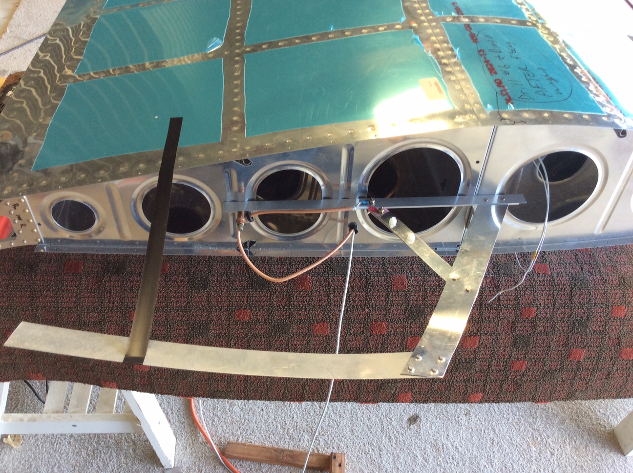

PostPosted: Mon Aug 06, 2018 7:52 am    Post subject: Antenna locations Reply with quote
Wingtip NAV antennas are only as good as the install. I make my own to optimize the available space in the wingtip, and tune the antenna using an antenna analyzer (a must have shared tool for any EAA chapter). I recommend the same for all RVs.
Performance exceeds all demands; VOR/LOC/ILS.  Following this approach, I do not believe an RV would ever need an external NAV antenna.
Photo is an antenna in the tuning process I made for an RV-14A. Notice how far it extends into the wingtip. The antenna stays mounted to the rib and the wingtip slides over it.
Carl
[img]cid:2B297A0C-9E06-42F0-8571-1CF980CEFF66[/img]

Before giving up, see if some local ham radio operator will have a look. Some things that seem okay for normal wiring definitely are not okay at these frequencies. For example:
I have seen Archer antennas installed with the ‘ground leg’ 8� away from the end rib, and connected to the rib with a single 8� long wire; I have seen one installed inverted (e.g., the radiating element attached to the rib, the ground leg free in the wingtip). Even these installations worked to some degree, with the pilots blaming poor performance on the antenna.
Look at Carl’s photo. Notice how the leading edge of the antenna is back, away from the landing light and its heat shielding foil.
Can you post a photo similar?
Another possibility is that the localizer at KAGC is at 109.1 MHz- close to the low frequency end of the nav frequencies. If your antenna is tuned to the higher end, it won’t perform as well at 109. See Carl’s post about an analyzer.
That said, I am totally perplexed as to how an antenna issue can give you a ‘fly left’ indication (ignoring the fact that the antenna is 15’ off the aircraft centerline). The receiver just looks at the relative strength of two different modulation frequencies. There is nothing in any antenna that should cause one signal to be different from the other. And if the reception is just poor, the receiver should flag. One thing you could try: my old C182 POH mentioned that sometimes, if the prop rpm was very close to the modulation frequency, it could cause some strange effects. I don’t see how a wingtip antenna could be affected, but you could try this approach again, at a 100 rpm different prop setting.
Bob Turner
RV-10 QB

PostPosted: Wed Aug 08, 2018 6:49 pm    Post subject: Antenna locations Reply with quote
This is an antenna analyzer that will do everything you need - and is the first thing I grab when someone says they have a comm or nav problem: https://www.dxengineering.com/search/product-line/mfj-259c-530-khz-230-mhz-antenna-swr-analyzers?autoview=SKU&keyword=Mfj%20antenna%20analyzer&sortby=BestKeywordMatch&sortorder=Ascending
This is something that should be in all EAA chapter shared tool box.
I do not recommend a simple copy of the Archer antenna. You want to have the arm extending into the wingtip as long as possible. This means the arm parallel to the wing rib will be shortened the same amount. If you make the antenna overall an inch or so longer you can now trim the end length to the middle of the VOR band. You also adjust the gama-match to match the 50 ohm coax. Gama-match adjustment is done by increasing/decreasing the capacitor element and/or the capacitor insulator thickness. These two adjustments are an interactive process, so trim a little at a time.
Figure 13-12 of the Aero Electric Connection book provides a good starting point. If you keep the matching triangle the same dimensions it will be easier.
This sounds hard but with the antenna analyzer takes just 10-15 minutes.
If you follow this process for a wingtip comm antenna and keep the arm extending into the wingtip as vertical as possible, it will not be quite as good as a belly antenna but more than adequate for a COMM #2 antenna.
Carl

--> RV10-List message posted by: "Bob Turner" <bobturner(at)alum.rpi.edu (bobturner(at)alum.rpi.edu)>
3. The "analyzer" is a standing wave thingy (Standing wave reflectometer) except that it also includes a low power, tunable transmitter.
4. To successfully clone the Archer you must copy as exactly as you can the coupling capacitor (the length, width, thickness, and material of the little parallel plate capacitor and the dielectric material).
Bob Turner
