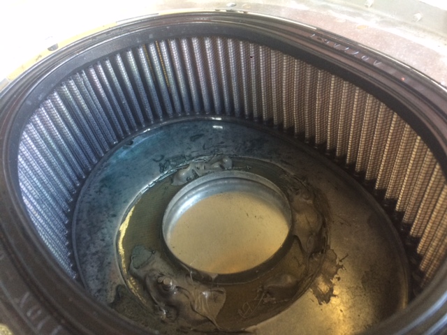

PostPosted: Sat Aug 12, 2017 9:24 am    Post subject: Before the fuel pump exchange - one last question Reply with quote
Still chasing this fluctuation and engine stumble down. I started a process today of vacuum checking fuel lines - still getting to that. But also thought I'd check induction.
Is it common to have this much fuel stain in your FAB? Wondering if something might be going on with the servo.
Blue stain is in the aft side of the filter and high up, which leads me to believe this is happening in-flight.
Phil

PostPosted: Sat Aug 12, 2017 12:32 pm    Post subject: Before the fuel pump exchange - one last question Reply with quote
I would suggest sending that photo and a description of your symptoms
to AFP, including how it behaved before the pump change and after;
-sent from the I-droid implanted in my forearm
> On Sat, Aug 12, 2017 at 10:23 AM, Phillip Perry <philperry9(at)gmail.com> wrote:
> Phil

rene(at)felker.com
PostPosted: Sat Aug 12, 2017 2:24 pm    Post subject: Before the fuel pump exchange - one last question Reply with quote
I do not have any in my fab. Just redid my air door today. 800 hours and
not stains.
>> Phil
>> Sent from my iPhone

I had some fuel there prior to the fuel pump swap. I know that because the drain line had a blue tint.
The low pressure pump runs 4-6 psi for carbureted engines.
The model number on mine is the correct model number for the IO-540. I confirmed it from multiple online sources (Tempest, Lycoming, etc.). Also confirmed the correct model number stamped on the pump prior to installing.
Frustrating......

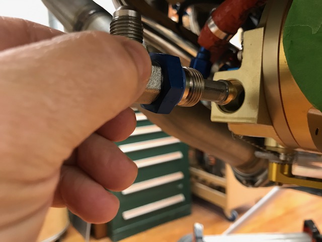

While I'm waiting on AFP to get back to me with some ideas, I bought some fittings and a vacuum pump to draw a vacuum on various parts of the fuel system in search for a leak.
I'd love to find a cracked flare or something like that and put this to bed.
Phil

Interesting...well above Lycoming's spec for the Precision RSA fuel
injection unit...but that may be an area that APF "improved" over the
certified product. I agree you have the correct part number which is
used on most 4 and 6 cylinder fuel injected Lycomings. It is supposed to
have an internal valve of some sort to limit the max pressure by
bypassing some of the output back into the inlet.

PostPosted: Sat Aug 12, 2017 5:21 pm    Post subject: Before the fuel pump exchange - one last question Reply with quote
I always have a fuel stain in the FAB. I think it comes from priming the engine before starting and the excess fuel runs down the intake pipes into the FAB. It leaves a blue stain there; never had in trouble from it.
Frustrating......
Phil
>>>> Phil

Phil, On the AFP fuel servo there is a filter screen on the input fitting. The attached photo is of the FM-200 on my rv-8.

Now with the picture.
