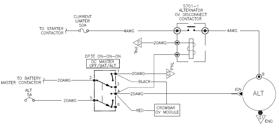

Guys,
I am installing my new CAMit 40 amp alternator on my Jabiru 3300 and the wiring diagram leaves a lot to be desired.
I would like to be able to shut it down in case the regulator goes crazy and is over charging or under charging.
It is a NipponDenso with three terminals. The two together is 12 v from the battery and a light bulb on the other. The larger terminal is for the output to the load / battery.
I am looking for a 50 amp circuit breaker to install between the alternator and the load / battery. Steinair does not show a 50 amp breaker or shunts
I also want to know if I need to switch the 12 v. sense line or the light bulb line to the alternator. We put it on a test bench at a friends auto battery / generator shop and it did not put out voltage with out the light circuit on. So I do not know if it will work with out the light circuit but I do not want to install one unless it is required.
Will the shunt that came with the firewall forward kit for the Jabiru 3300 with the 16 amp permanent magnet alternator work with the forty amp alternator.
I really could use some help on developing a working wiring diagram and the proper components. I hate to let the smoke out of more stuff.
Thanks for any help
Bobby ( age 76 )
Zodiac 601 XL "B"
Jabiru 3300 S/N 1141
Sensenich 64" x 51" Prop
Bing Carb 260 Main & 290 Needle Jet
Status - Flying  236 hrs.

At 04:23 PM 5/12/2015, you wrote:
Guys,
Consider this one . . .
[img]cid:.0[/img][/i][/b]
This will do that.
Use a 40A 'current limiter' (fat fuse) at
the BAT terminal of the starter contactor.
See http://www.bandc.biz/anlcurrentlimiters40athrough130a.aspx

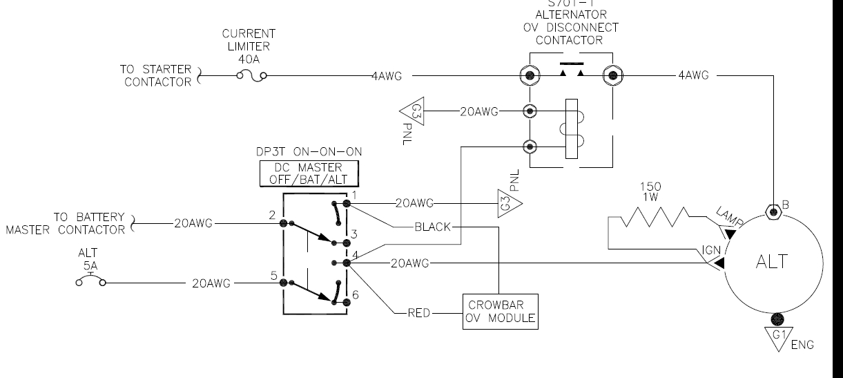

Hook the LIGHT terminal to the IGN terminal with
a 150 Ohm, 1 Watt resistor . . .
Does the shunt have any markings on it? What kind of instrument
displays current sensed by the shunt?
Bob Nuckolls
AeroElectric Connection
P.O. Box 130
Medicine Lodge, KS 67104-0130
Mobile: 316-209-7528
Web: http://aeroelectric.com
Guys,
This will do that.
Bob Nuckolls
P.O. Box 130
 Filesize:  81.5 KB
 Viewed:  11561 Time(s)
BobbyPaulk(at)comcast.net
PostPosted: Wed May 13, 2015 12:23 pm    Post subject: Alternator Reply with quote
Bob,
Thank you very much.
You answered a lot of my many questions.
I will be ordering the 40 amp current limiter and mounting base immediately.
My friend at the auto battery / generator shop said I should not shut down the alternator under load. I do not expect to do that but was wondering if it became necessary would turning off the ign line to it shut it down in an emergency?? I know I can shut it down with the solenoid but I would also loose battery power which would shut down radio, EFIS & EMS.
Any suggestions on where to purchase small quantities of aircraft grade wire ( #8 ) and a quality 150 ohm 1 watt resistor.
Many Thanks to all that responded
Bobby
nuckollsr
Joined: 24 Mar 2009
Posts: 95
Location: Medicine Lodge, KS
PostPosted: Wed May 13, 2015 3:57 pm    Post subject: Alternator Reply with quote
At 03:22 PM 5/13/2015, you wrote:
Bob,
If the alternator has been re-manufactured by a
reputable company, turning it off under load represents
no hazard. See the chapter on Engine Drive Power Sources
when you book arrives.
No, the switch I show is the B&C S700-2-10, three position
switch that emulates the split rocker switch in many TC
aircraft. You move the switch down one notch to turn off
the alternator only . . . this leaves the battery on until you
move the switch fully down.
The resistor will come with your book/cd. Did B&C fix
you up on wire? Here's an update on the alternator
wiring showing the resistor installation.
