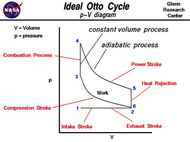

PostPosted: Thu Feb 20, 2014 9:46 am    Post subject: propeller pull through procedure Reply with quote
There seems to be a number of different methods for determining number of rotations to complete a full cycle. Mostly wrong.
The key is the Otto cycle itself. It needs two revolutions to complete and has a number of events taking place at very specific points in the cycle. If you stack a number of these cylinders together whether in a line or circle or whatever it becomes clear that there must be a specific interval for those events between cylinders.
The design itself indicates that interval is 180 degs.
To fully cycle 9 cylinders then requires a crankshaft rotation of 1620 degs. (9X180). 1620/360 = 4.5 revolutions for a direct drive engine.
For the M14P: 4.5 X 0.658 X 2 (blades) = 5.922 turns OR 1620 X 0.658 = 1065.96 X 2 = 2132.92/360 = 5.922 turns.
For the HS6A the gear ratio is 0.787. The above is for two blades. I hate three blades causes there is always one in the way to hit my head on.
Walt
