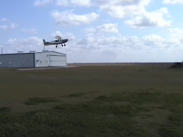

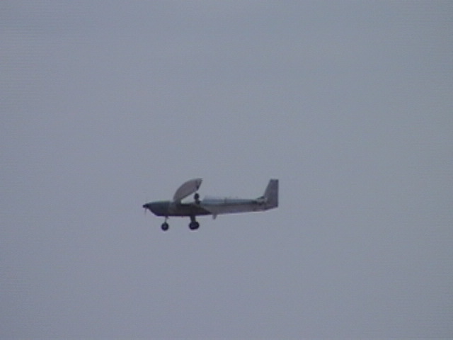

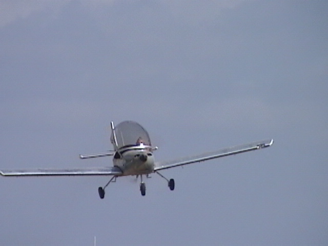

My instructor and I had the canopy open in a similar aircraft. The Evector Sportstar is a low-wing LSA with a forward-hinged canopy (although the canopy is split behind the seats). When the canopy popped I hung on its cross-bar with all my weight but could not close it. We were close to the runway and my instructor was able to land without further incident. I don’t recall if we were able to maintain altitude.
I’ve attached photos from another 601XL open canopy incident from 2006 or earlier. I don’t know much else about this incident but I think it is described in the archives (the original poster was coy about the pilot and details).
-- Craig

PostPosted: Sat Mar 30, 2013 5:38 pm    Post subject: Re: Zenith thrown out of plane Reply with quote
The pictures tell quite the story. A.) the canopy can rise dramatically and B.) the airplane is still controllable in that condition. Another great reason for adding some kind of safety latch.

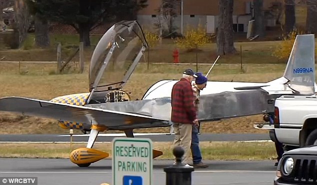

PostPosted: Sat Mar 30, 2013 6:59 pm    Post subject: Re: Zenith thrown out of plane Reply with quote
Just a guess but by the looks of where the canopy is broken he may have unfastened his seat belt to stand up and grab the canopy by the back edge and broke it while trying to close it.

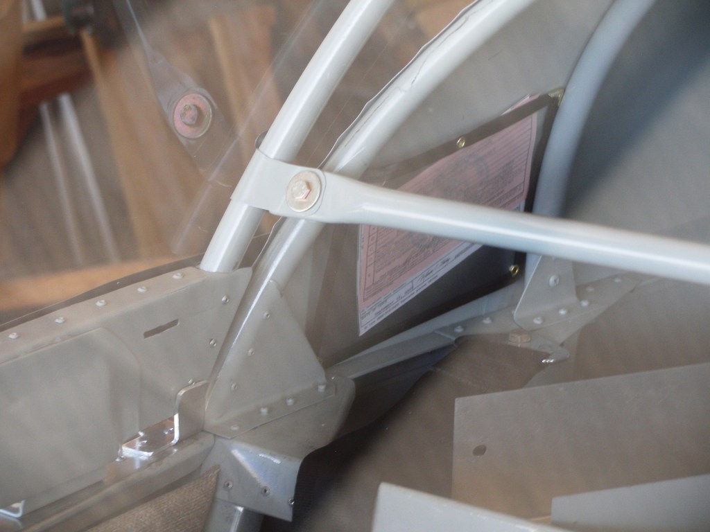

Is this what you are looking for?
I don't have any tether for the canopy, but would seriously consider building one. Alas, I really haven't thought out the best way to do this. Perhaps somebody has pictures of a neat design for a canopy safety device. Paul
