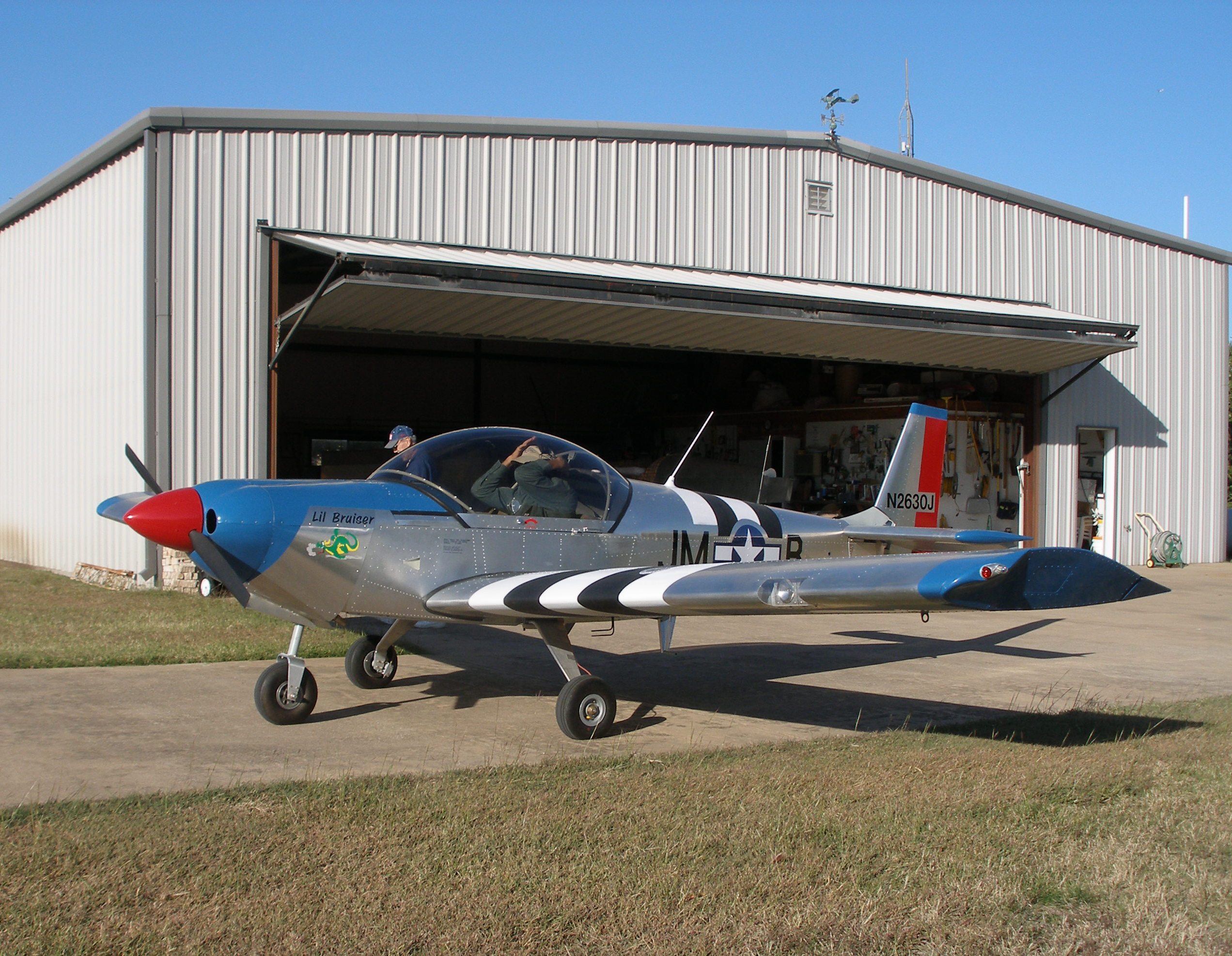

I understand that 6061-T6 is very corrosion resistant. Therefore, I only painted the fiberglass parts, invasion stripes and a little other cosmetic painting. I actually like the look of the "raw", unpolished aluminum. Judge for yourself.

The question is, what will it look like down the road, and in less than ideal conditions like you experience in Texas? You know I love the looks of your project, but you haven't experienced the snow and other crap you get in the Northern areas. I'll have to send you a picture of what my car looks like after they start applying calcium chloride this winter.

Another thought (or thoughts). Is your aircraft hangared? If so, it will be
exposed to the worst of the environment only a small portion of the year.
Look at the WWII aircraft that are still around. Assuming they were properly
cared for, how does the skin look?
I'm a bit biased, as I'm still considering minimizing the amount of paint. My
reasons are cost and weight.

Nice looking plane. I like the look as well as the minimum work. I
consider my plane to be more of a tool than anything else and the raw
aluminum looks appropriate. Have you experimented with any finish, wax or
any high tech clear protectant, on the raw aluminum?

Thanks. I too was building a flying tool, not a hanger queen nor a beauty contestant. But I did want it to be a fun thing too, thus the military look.
No I have not experimented with wax nor a clear coat. If I begin to see signs of surface corrosion, I will certainly entertain one of those. But, here in North Texas, we don't have any salty sea air nor any influence from salting snowy roads.
I finished my wings and stored them outside, on a wooden rack covered with a tarp. When I brought them inside to do the painting, I found a lot of surface corrosion. It occurred mainly where the tarp touched the metal. It took the better part of a month to get rid of it. They probably would have fared better if I had left them uncovered. I think the corrosion formed when the tarp actually kept the contact area moist. Uncovered, the moisture would have mostly run off and the rest just evaporated.

Nice looking machine in the opening post. Thought crossed my mind that if the aircraft is left bare for aesthetics-might be an idea to PAINT those portions , with aluminum colored paint......to maintain the look , and add corrosion protection.
