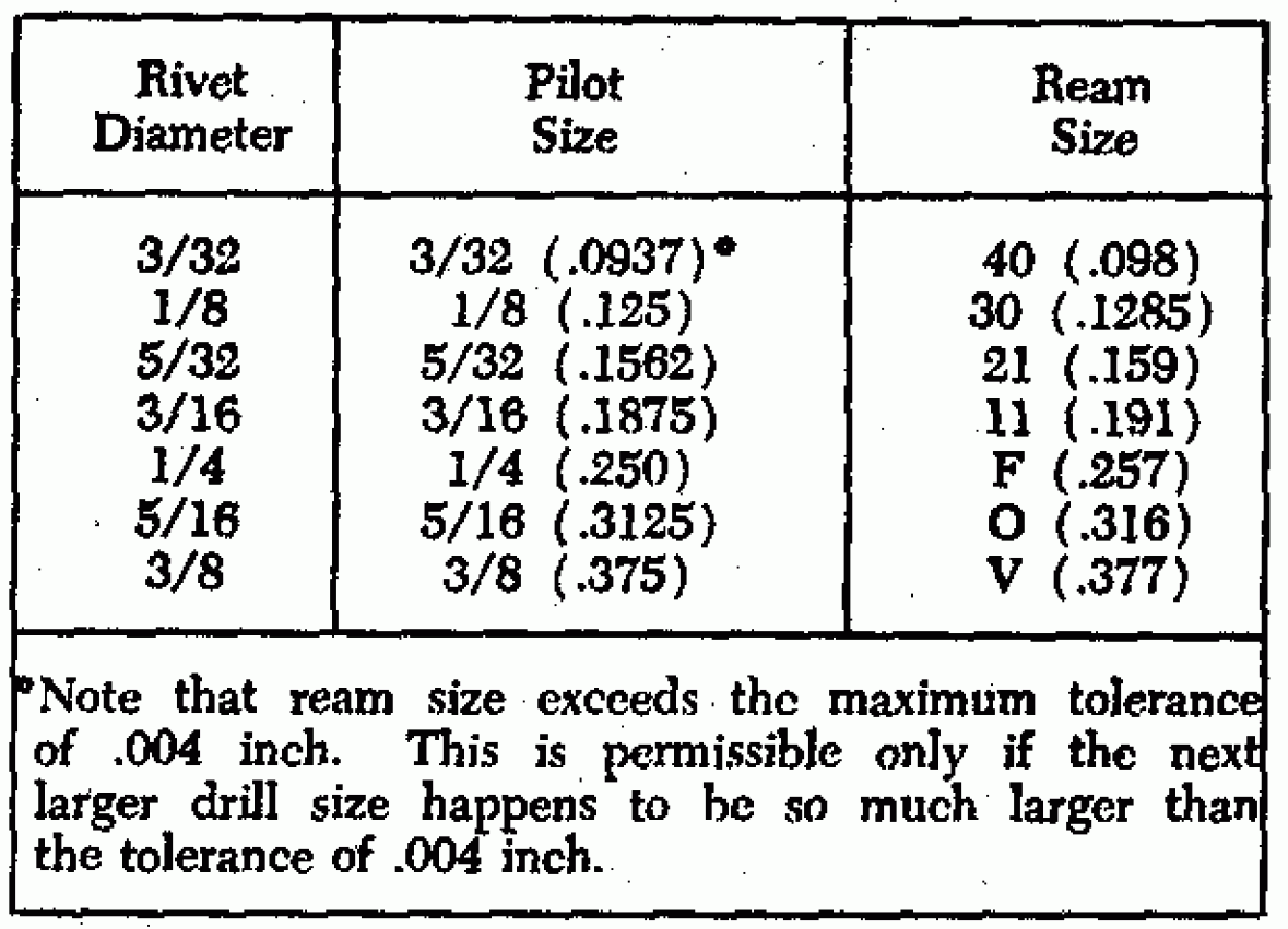

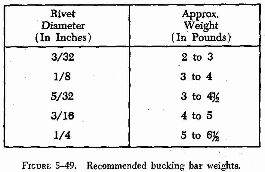

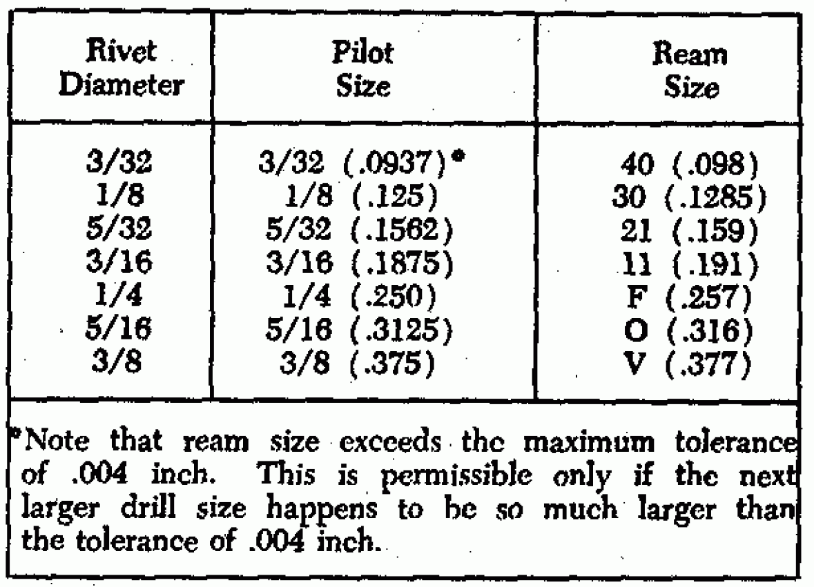

Hopefully,there was no offense taken from my comments earlier. Plese review the attached files. They were copied from the AC65-15A Airframe Handbook. These are the officially accepted hole diameter limits for the AN470AD and MS20470AD driven rivets. Since the rivets you refer to are 7/8" long we assume that the joint stack is 11/16" thick, clamped. If the hole for tat fastener were drilled with a 3/16" bit (0.188"ø) the rivet will be too long and not only will the rivet be difficult to drive with the requisite 1.5ø x 0.65d height shop head but teh strength will be somewhat substandard due to a lack of proper work hardening.
The weight for the bucking bars are also important as they directly contribute to the number of impacts needed to upset the shop head.

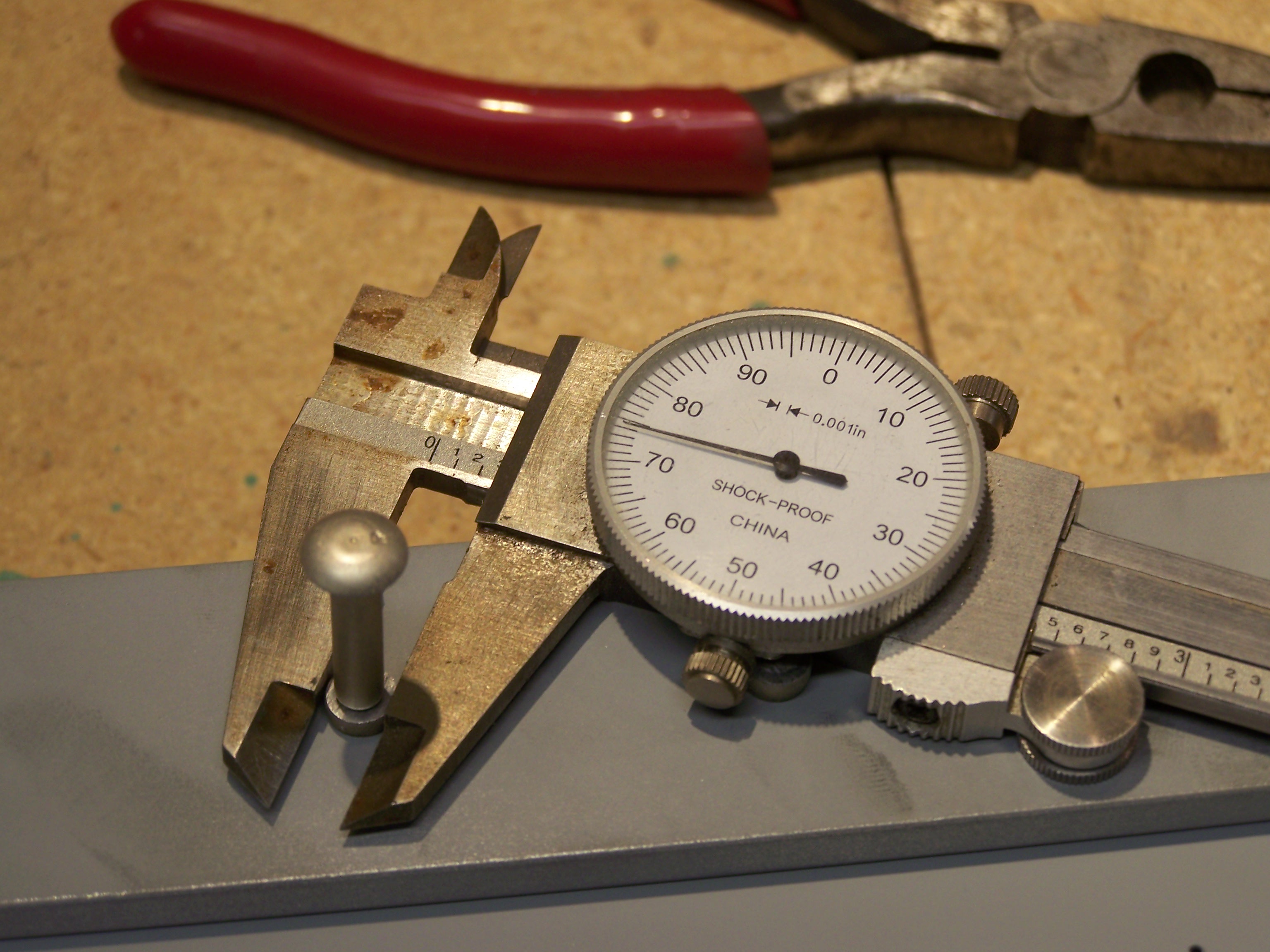

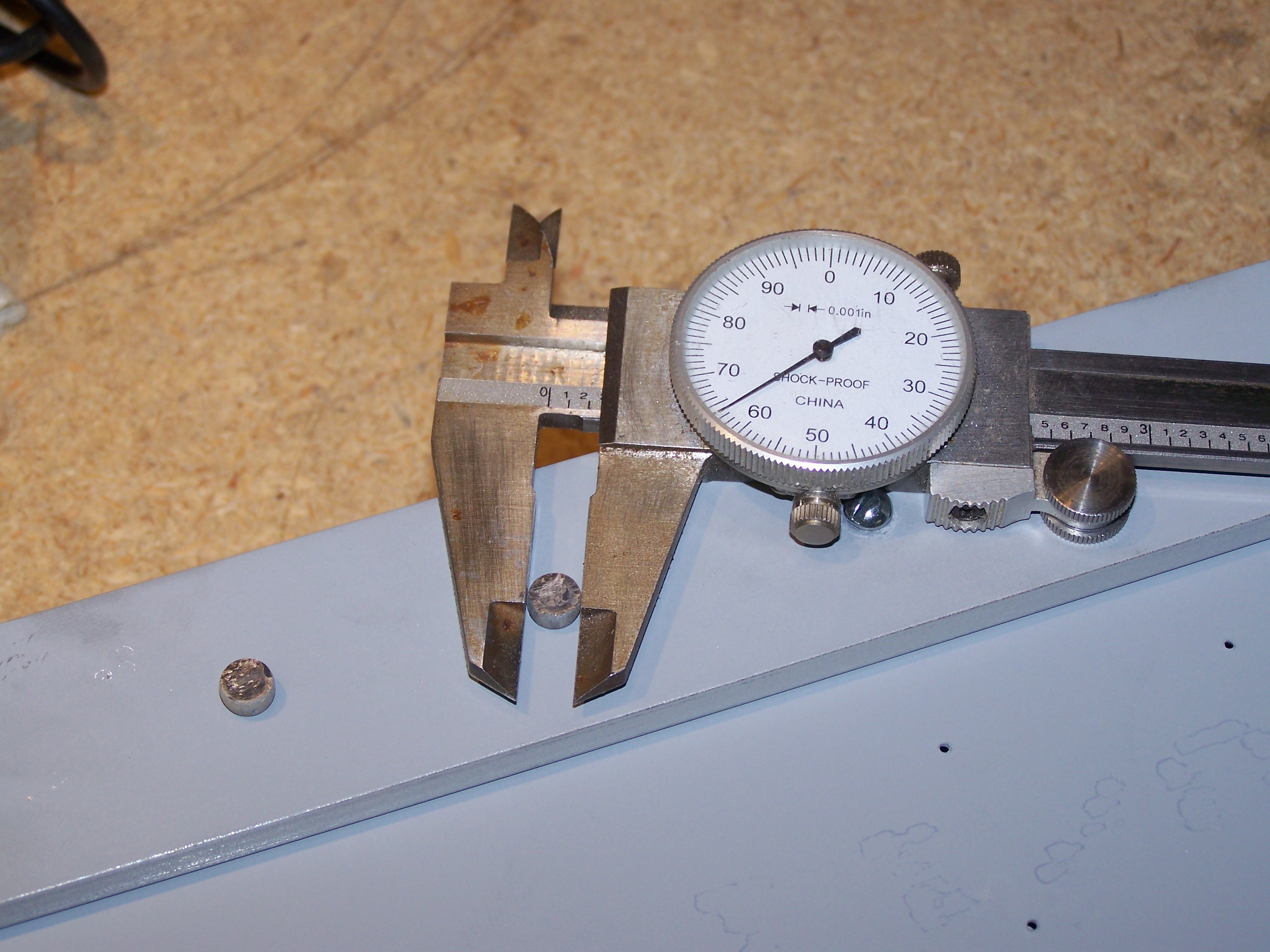

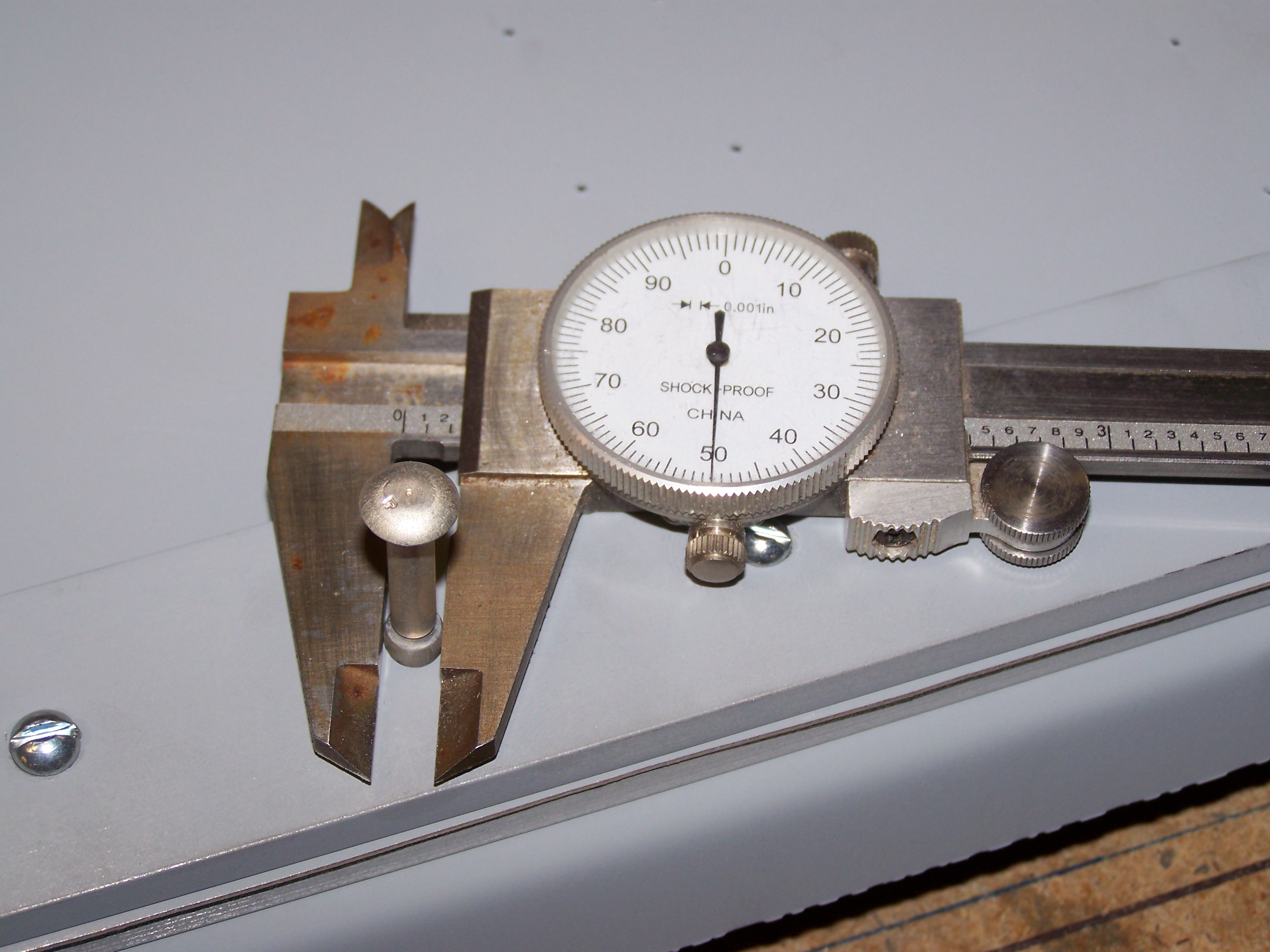

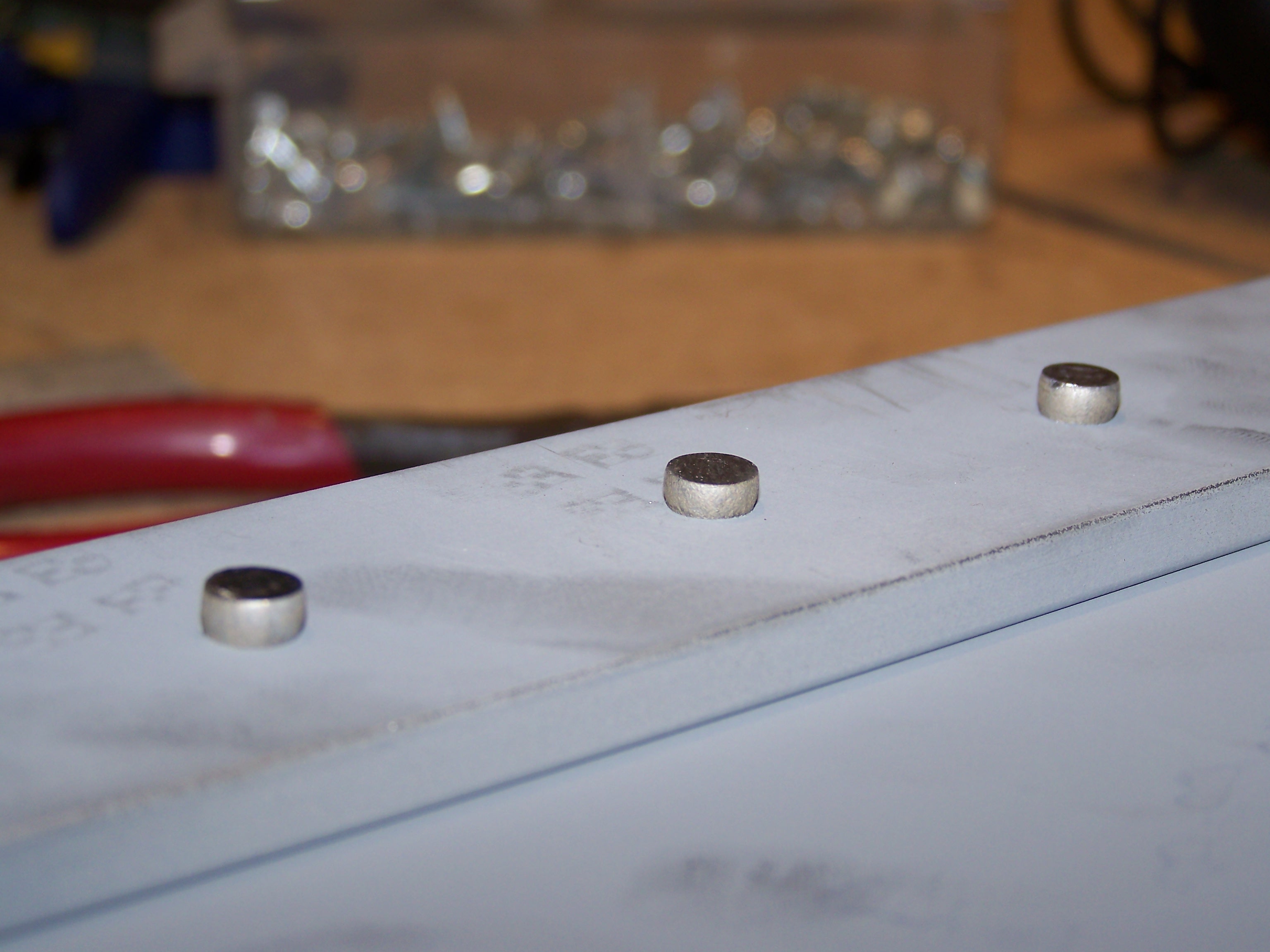

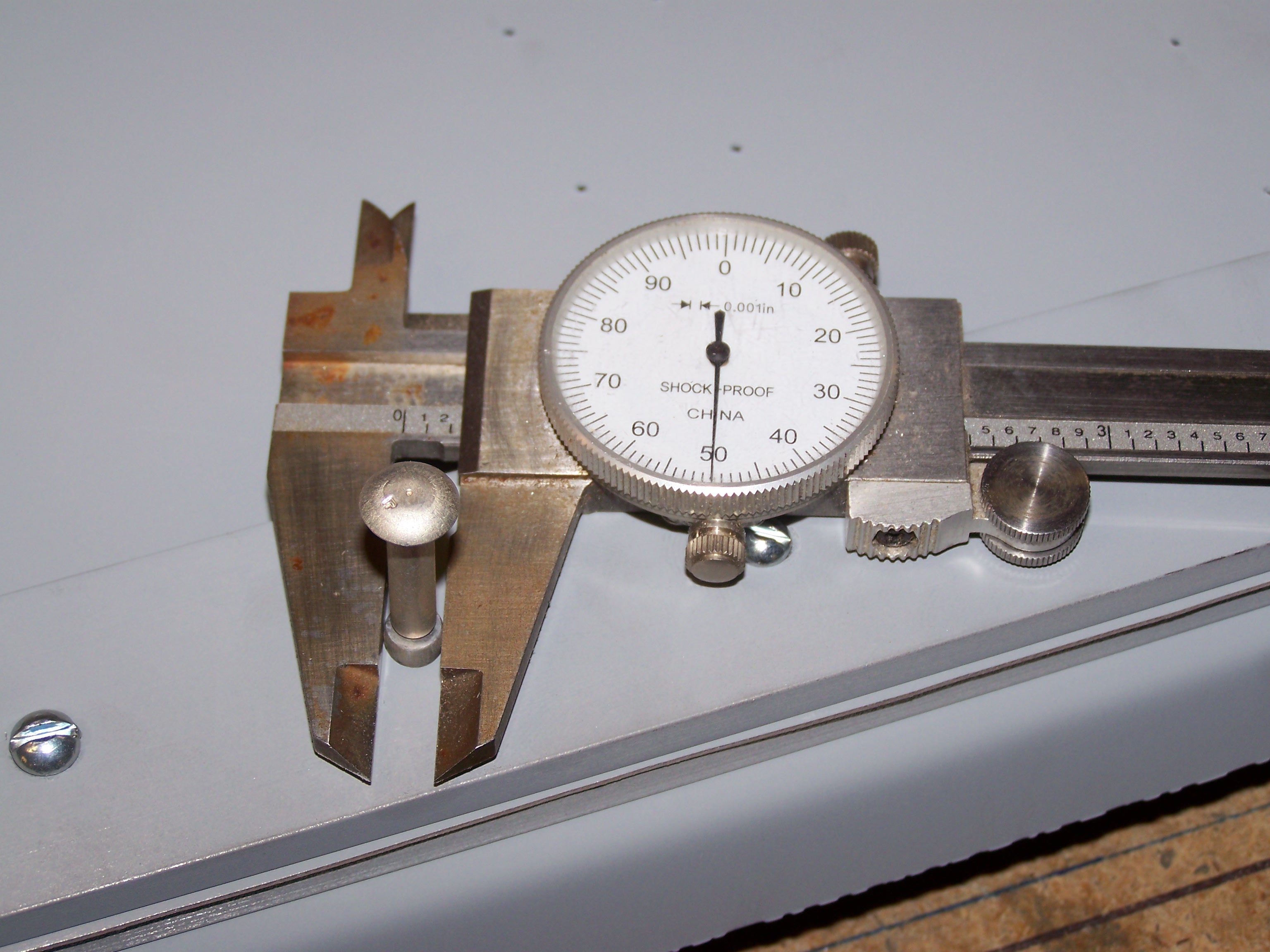

Picture's worth a thousand words. Here's a few thousand words. Most come to about .262. A few are up to .274 as seen and a picture of one of the bad ones .249, plus a side shot of the rivets for inspection of the heads. I placed a rivet on top in the pix to see the shank of the original rivet (.187). The holes have been reamed to .1895.
I can go back and try hitting the not so good rivets again, I just don't want to work harden it too much and make it weak. Is it possible to heat treat them to get rid of some of the hardness, and them hit them again?
side view of decent set rivets
not so good
average

.274 fairly good set.

They actually look good. I still suspect both of my earlier observations. The minimum hole ream size should be 0.191 for a 3/16 AD driven rivet so the slightly small bore will contribute to slightly tall shop heads.
What you have is grossly superior to the result of trying to drill out and replace the fasteners. They are probably within 5% of nominal mechanicals as is.
You can always go back and set them a little more - but they look as though you need a bigger gun or heavier bucking bar.
Keep in mind that this plane was designed to be built by amateurs - and CH is noted for making accomodations for the builders varying levels of skill.
Overall, I would not lose a lot of sleep over them. I haev seem many, many, many worse in virtually all manufacturer's products - Boeing included...
