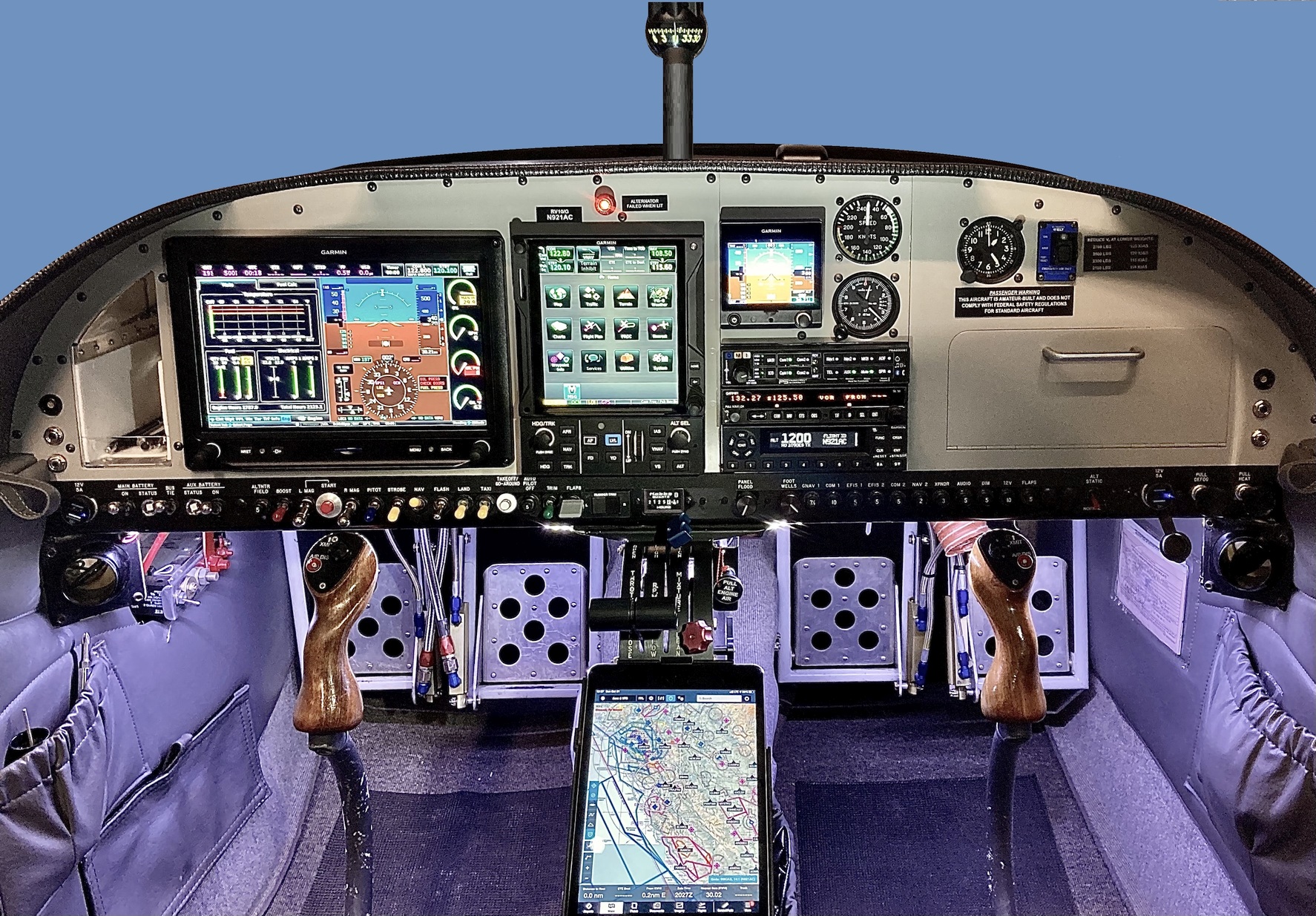

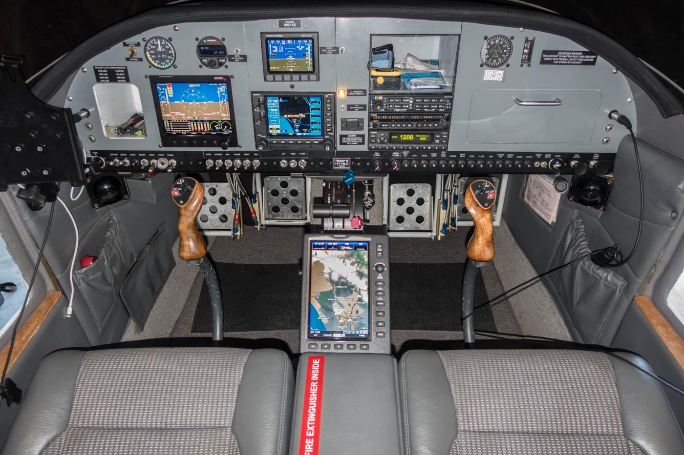

David,
I removed my original AFS EFIS, GNS530W, backup D-10A, and TruTrak AP in early 2020.
I had previously installed a GTX345 for ADS-B.  I kept the transponder and added a G3X touch, GTN750xi, GMC507, Garmin servos, and a G5 for backup.
I bought everything from Stein, including a panel face and a complete wiring harness.  I opted to assemble and install the package myself.  It was a long process but service was above and beyond. I called Stein and Garmin several times for support.  No regrets.  Both were both extremely helpful and responsive.  Stein provided a complete interconnect diagram in the form of a 4' x 6' hardcopy that adorns my hangar wall.
As Stein mentioned, Garmin has a department devoted to experimentals.  A few times, especially for the 750, they passed my questions on to the certified side but all have been answered.
While shopping it was clear that a Garmin navigator was really the only choice.  I looked at all the various systems.  It came down to how seamlessly the Garmin stuff interfaces, and the fact that they use "industry standard" depictions.  My airplane partners are airline types and they seemed to recognize what they were seeing on the Garmins better than other systems.
Another driver for the design was that we all wanted dedicated buttons and knobs.  Scrolling through menus is no fun when you're saturated.  We could have remoted the transponder and autopilot but a physical, never-changing interface is a comfort.
If you use Foreflight, it connects by bluetooth for ADS-B and to transfer flight plans to/from the panel.
I couldn't be happier with how it turned out.  Before and after pictures below.
--Dave
[img]cid:ii_kykeoy820[/img][img]cid:ii_kykerpfg1[/img]
