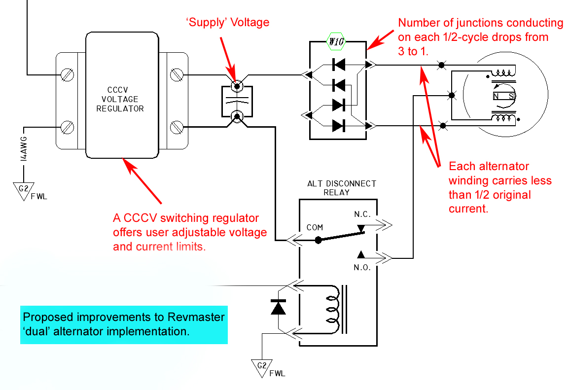

Based on the drawing that Dan supplied a few weeks
ago it seems that the designers intended that only
one of the two windings be used at the same time.
I'm guessing that this is a "normal-and-spare"
design philosophy. Therefore, any time a winding fails due
to exceedance of thermal limits, the other winding
was off line.
We don't know the internal configuration of the
recommended rectifier/regulator but it's almost
certain to included silicon controlled rectifier
and one diode in series on each conduction half-
cycle. That's 3, silicon junctions in series
that carry alternator output current.
My current hypothesis suggests that it would be
much better to use BOTH windings all the time. Reduce
the current in each winding by 50% or more. It seems
better to have one configuration that's bulletproof
than two relatively fragile configurations that 'back
each other up'.

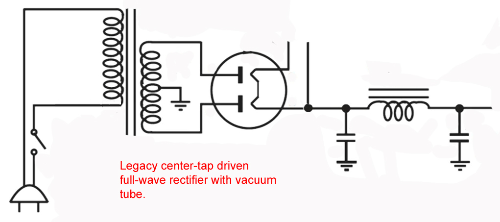

Harking back to the earliest days of my studies
in electron herding, ac rectifiers were vacuum
tubes (not junctions) and ac power sources were transformers
plugged into the wall (not spinning magnets).
Except for the systems with very low energy
requirements (table top radios), the rectifiers
were dual diodes driven from either side of a
center tapped transformer secondary. This configuration
had some profound effects in thermal management.
EACH diode carries 1/2 the total current. These
devices have considerable resistance . . . watts =
I(squared) x R so if you reduce current by 1/2,
watts goes down to 1/4. Same thing happens in the
transformer secondary . . . the secondary wire
size can be made smaller in a trade off between
energy lost and transformer size.
Refinement of process:
So take a peek at the simplified proposal diagram.
Hook the two Revmaster windings in series-aiding
and bring out the center-tap. Connect in full wave
configuration with only TWO junction rectifiers.
Feed this resulting energy off to a filter capacitor
size to be determined.
This will give us a 'supply voltage' of some value
ideally adjust to about 20VDC at cruise RPM and
alternators full load design point.
This voltage is going to be all over the place
depending on load and engine rpm . . . but that's
the nature of the PM alternator.
Now, let's power condition that energy with a constant
current, constant voltage, switch-mode regulator.
NOW we have a BIG difference in performance:
Voltage is adjustable and controlled by active electronics.
Current is adjustable and limited by active electronics.
I suggest this configuration offers
significant improvement in Revmaster's engine
driven power source. Energy being delivered
to the regulator is at significantly higher than
the output set point, CURRENT in from the alternator
will be LOWER than current delivered by the regulator.
Further, each winding works 1/2 of the time so it
follows that heating effects on each winding are much
reduced from the current configuration.
Silicon junctions in the rectifier are significantly
reduced off-setting some new losses introduced by
the electronic CCCV regulator.
It seems that we could craft an engine driven power
system that almost never fails in exchange for one
that fails too many times and for the wrong reasons.

Using both windings is a good idea.
What about the phase angle between the two windings? Do we know what it is?
Suppose the two windings are 90 degrees out of phase or some other unknown angle.
How will that affect the proposed circuit? Will the peak AC voltage be higher?
Do capacitors help very much to smooth the DC voltage in a power circuit?
It would help to have a Revmaster alternator to play with.
No . . .
Good question.
I doubt they are polyphase . . . you gotta go to a
lot of mechanical fuss to achieve it. It's a function
of stator/magnet ring geometry. They might be different
but it's doubtful. Issue 80 of Contact! magazine has
some nice pictures of the stator arrangement:
http://www.contactmagazine.com/Issue80/Issue-80L.pdf
They can . . . it's all about current/capacitance ratio
versus frequency. If a capacitor is necessary, it will
be dictated by the CCCV down converter tolerance for
ripple.
You got that right!

I like the approach and two questions come to mind:
How well the current will be equally divided by the two windings?
This is half wave rectification, right?

Actually it is desired that the two windings be 180 degrees out of phase.
That way, only one winding will conduct at a time and the output will be pulsing
DC. If the two windings are in phase, no problem, just reverse the leads on
one of the windings. Then the windings will be 180 degrees out of phase.
No, full wave . . . the current doesn't
NEED to be exactly shared . . . each winding
conduct on 1/2 cycle of the time independently
of each other. Unlike the legacy, single winding
PMA and bridge rectifier approach, this
configuration splits the two halves onto
separate windings . . . but it's still
full wave rectification.

From what I understand, the Revmaster
PMA is wound BI-FILAR meaning two strands
of wire side-by-by side. This produces
two, identical windings that COULD and
perhaps SHOULD be wired in parallel. This
would cut the current in each winding to
1/2 of the total.
I have to pull my engine once more before I start it (hopefully, yet this fall) and will examine the windings on the PMAs closely to convince myself of the phase relationship between the two halves.
The result is predictable. You have two, identical
windings sharing the same physical space
on the stator. Voltages induced by the
mechanics and magnetics are identical.
Given that the burning the 'active' winding
also burns the 'standby' winding, you do
not have redundant systems. You might as
well run the two windings in parallel
which would greatly reduce the stress on
the wires and may well drive the 'lithium'
failure rate to zero.
OK, I've convinced myself that the OEM design made use of 1/2 wave rectification. Unless I'm wrong on this, running both sides with the OEM rectifiers (which is discouraged) would have the same current (total) heat generation as this very elegant center tap as you've shown.

I think that there might be a misunderstanding of the Revmaster architecture in that I don't believe that the windings for the two generators are in tandem but are a series of 5 coils each for two generators.   I have enclosed a picture of the stator from my friend's engine.  He was running one generator at the time and you can see how severely it was destroyed.  The Phenolic base was also destroyed.  The second generator coils don't look bad but they are also ruined.  To me one of the interesting things is that the ignition coils are still functional.  My primary purpose in starting this thread was to hopefully end up with a definite fix for the problem.  Trying this or that is not practicable due to the destructive nature of the overheating.  The stator is over $500 to replace and requires pulling the engine to do so.  I'll only really know that the problem is fixed when the smoke stays in the coils.
It seems to me that the most important change will be to use the B&C AVC1 volltage regulator since it is designed for firewall forward and can be adjusted down to 13.7 v  which is the minimum voltage that will fully charge the EarthX battery.  With the voltage reduction should come current reduction.  What I don't know (and hopefully the educated on the list can explain) is whether restricting the voltage will also restrict the current.  Can the generator still create abnormal current and therefore heat. I will try and incorporate thermocouples in with the coils but I'm not sure how much advance warning they can give.
So, with the new voltage regulator set at 13.7 can the generator still pump out current based on engine speed and battery resistance or is the current capped since the voltage is restricted. I'm trying to determine if I have a good chance of success here.
Does anybody want to redesign the generator to make it more robust.
Paul
On Mon, Aug 31, 2020 at 12:25 PM Robert L. Nuckolls, III <nuckolls.bob(at)aeroelectric.com (nuckolls.bob(at)aeroelectric.com)> wrote:
--> AeroElectric-List message posted by: "user9253" <fransew(at)gmail.com (fransew(at)gmail.com)>
  No . . .
  Good question.
  ripple.
Probably not. Keep in mind that as you rotate of the
runway into the blue, there are two kinds of loads
on your alternator. Battery recharge + system running
loads. The TOTAL of these two values is exceeding
the alternator's limitations for thermal management
and has not much to do with the bus voltage set-point.
The fact that an EarthX battery seems to exacerbate
the failure rate only speaks to that battery's
lower internal resistance and willingness to accept
charge at a lower voltage than SLVA.
I.e. the LiFEPO4 battery is NOT ROOT CAUSE of the
unhappy condition . . . only a slightly greater
stress on the alternator seems to exacerbate
failure rates. Adjusting the voltage down by
exploiting the features of the AVC1 might
reduce the failure rate but I kinda doubt it.

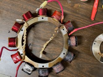

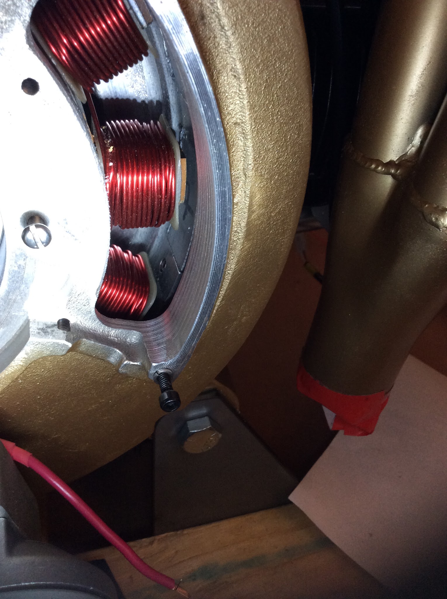

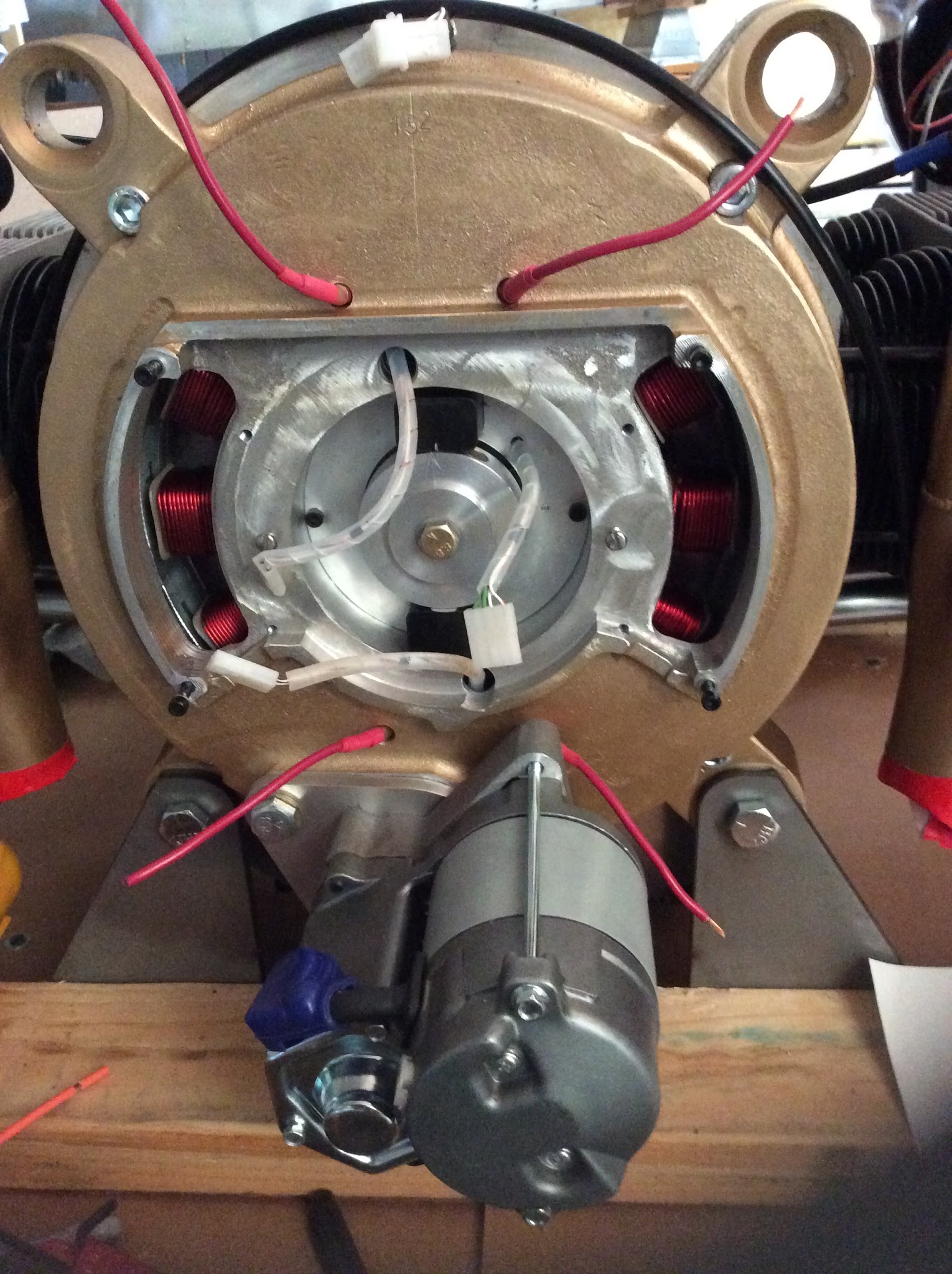

Images as attachments of the R2300 from when I first received my engine in 2017.
There are two separate stator windings, 5 coils on each stator with relatively large wires (12 AWG ?). Next time I pull the engine, I'll mic the wires on the coils.
Note, setting this up as a center tap as suggested should be straight forward. Again I have to state that I think the average current with your center tap arrangement will be the same as the OEM half wave R/R with both sides enabled.

Adding an external alternator is not obvious (to me) where it would mount but earlier versions of the engine had external alternators (I believe), so the design components could be available Revmaster. I amazed (concerned) that with the close proximity of the CDI power coils and ignition electronics that there are no reported failures of that system, related to the alternator failures. makes me want to consider returning to 2 mags and an external alternator for the R2300. Again, maybe easier said the executed but certainly a design that was once available.
One thing that puzzles me though. At least one failure of BOTH alternators, as reported by Eric or Paul, occurred with only one alternator activated. How is it possible to overheat both sides simultaneously (through heat conduction I have to assume) without damaging the ingnition coils that sit between the two alternators ??
(Molex connectors and wires in my photo from the two ignition coils and the timing signals are shown).
I have to suspect there is another heat source or cause that is contributing to these PMA failures. Engine heat?

Back of engine alternator with CDI ignition box removed

There are 4 black screws in the picture that look like they might hold a cover
on. Is it possible to pipe pressurized air into that cover to cool the coils?
If the coils were kept cool, their ampacity would be greatly increased.

Hopefully here is the image of the stator that I thought was sent previously.
Paul
>    I don't see that image . . . how did you 'enclose'
>    it?

I will try to obtain some fundamental characteristics of the alternators within the next 30 days.  (i.e. short circuit current, open circuit voltage at starter rpm, inductance...).
Let me point out the obvious,... "redesigning this system puts the builder in a situation of complete ownership of the problem as it is doubtful Revmaster will support a modified system."  The OBAM pilot takes on that responsibility (or should he/she does) regardless of the OEM support, so maybe that is not worth mentioning.
It is possible and I agree it's worth considering. I'll look at the CDI eletronics casting (which is what those screws hold in place) to see if there is a pathway to generate an inlet and egress for air. I don't have any good photos of the inside of that casting. Maybe I can pull that casting off without pulling the engine. I'll look tonight.
Thanks for the suggestion.

PostPosted: Thu Sep 10, 2020 1:21 pm    Post subject: Revmaster 'dual' alterantors Reply with quote
Paul
Excellent . . . thank you. I agree, this definitely
appears to be a PAIR of 5-pole alternators.
Good data point.
