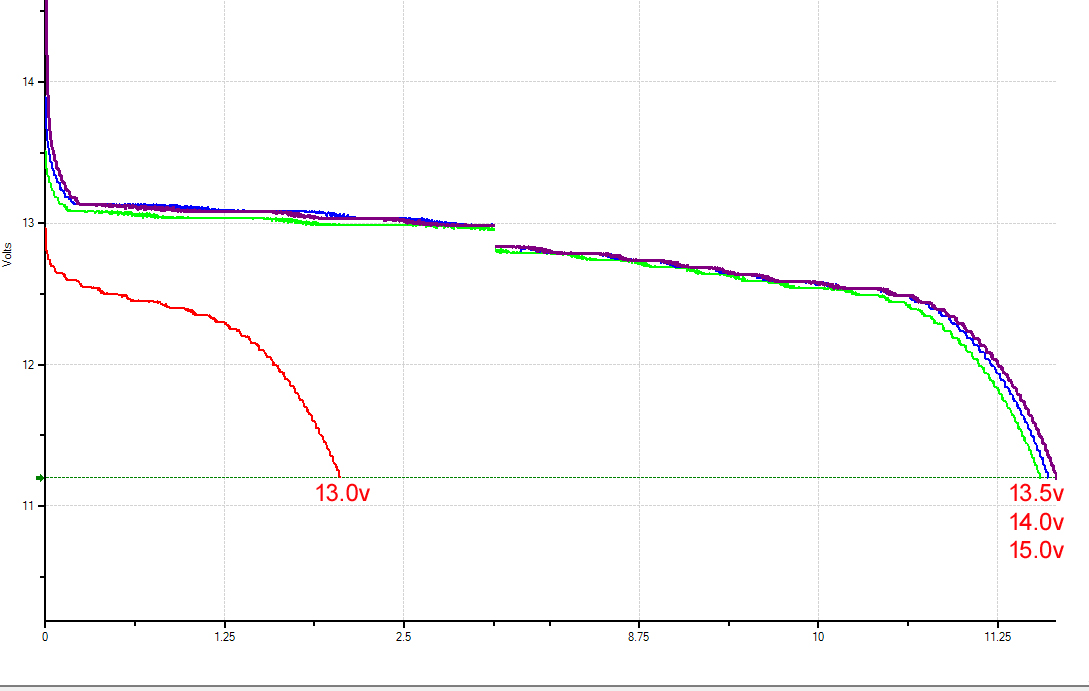

The attached plot show EarthX test data from
some years back. A bus voltage of 13.0 falls
far short of fully charging the battery . . . while
voltages of 13.5, 14.0 and 15.0 will all
fully charge the battery. The BMS takes
care of moderating any 'excess' voltage but
its design rules will allow the battery
to accept any safe level of replenishment . . .
safe for the battery. Unfortunately,
that current value is more than your
alternator/regulator combination is able
to grunt without smoking the windings.

You would want to set the bus voltage
to 13.6 +/- 0.1 volts. I'm thinking this
MIGHT do the trick.

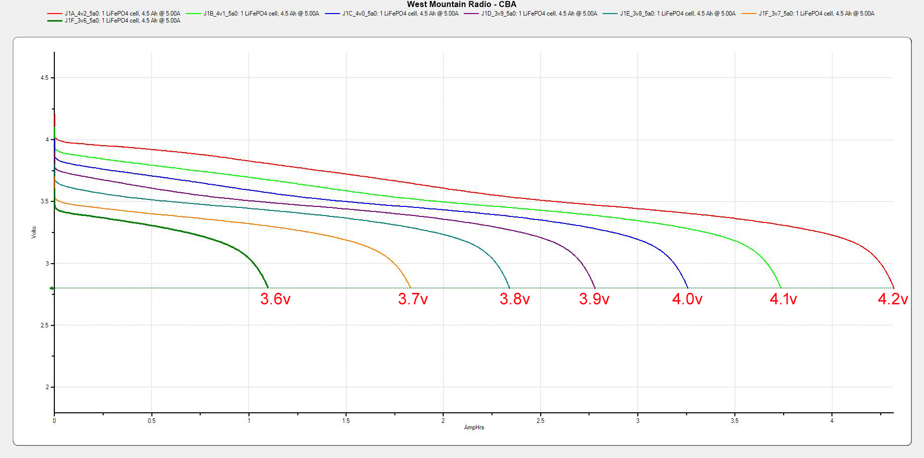

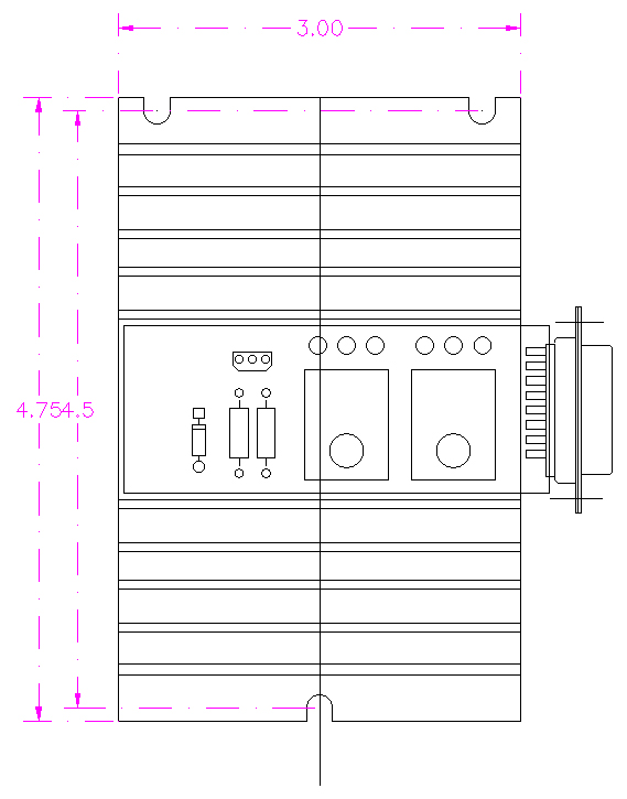

I did a little sharp pencil work on a concept.
Cartoon attached. I'll see if I can refine
it to the prototype fabrication stage.
This is FAR preferred to down-adjusting the
alternator. I'm finding that 4-cell stacks
of LiFePO4 cells are just barely charged
when floated across our legacy 14.4v bus.
A maximally charged LiFePO4 needs a 4.2
volt supply. Stack four cells in series and
you now need a 16.8v bus!
Take a peek at the capacity vs. charge voltage
plots. A 3.6 volt charge (14.4v bus) would
charge an LiFePO4 to about 25% of its
potential chemical potential capacity.
Reducing the bus voltage to mitigate battery
charge limitations on the alternator only
exacerbates the problem. Tailoring the
alternator system to the battery makes
more sense.
