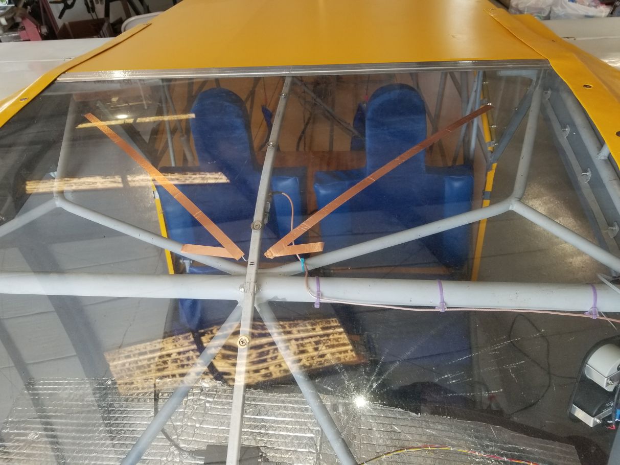

The reason I chose 5/32" tubing is that it's nearly 1" "wide". 5/32 * 2 * Pi = 0.98". I'm considering it a 1" wide strip rolled  into a 5/32" tube.
But maybe I'm understanding it wrongly and it's only 5/32" "wide".
Finn

Oops. That should be:
The reason I chose 5/32" tubing is that it's nearly 0.5" "wide". 5/32 * Pi = 0.48". I'm considering it a 0.5" wide strip rolled  into a 5/32" tube.
Finn

The NANOVNA does that and MUCH more. You just have to learn how to use it. Groups wiki and tons of video via youtube. w2aew has some excellent videos on youtube.
Using the structure as an antenna - not a good plan. Structure is great for a ground plane.
attaching photo of my NAV/ILS antenna. Used RG174 to feed.
Merle
