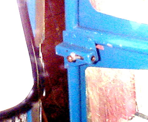

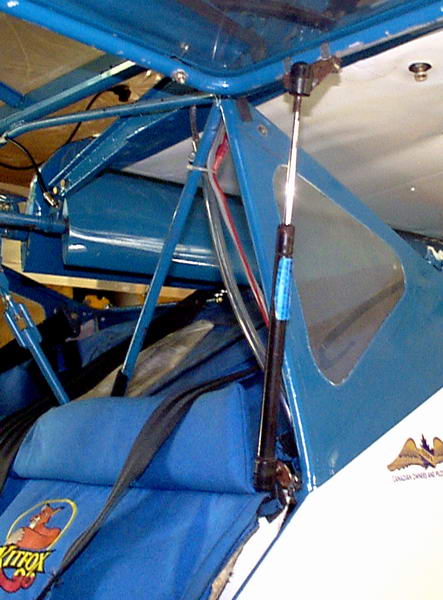

Lynn:
I just went out and checked my aircraft for the use of those nylon bushings.
| Quote: | From what I can see they will prevent some metal fatigue over a period of
years. I would say that if any one didn't install them they should consider
doing so.
I'm going to enclose a few pictures of the latching system on my plane. The
doors are the standard metal frame and the main latch is similar to what you
will find in a house. Each door also has a safety latch that I check as
part of my run up list. Last year I went to the local scrap yard and looked
through several hundred automotive gas struts . I came up with one that was
easy to install to the door and the support behind the seat. I
intentionally made part of the mount that attaches to the door with worm
clamps so the strut goes over centre to help close the door. What I've
found is that when I go to open the door in flight I actually have to push
to open it. Before installing the strut wind would open the door at least
halfway.
Noel

From: "Noel Loveys" <noelloveys(at)yahoo.ca>
Reply-To: kitfox-list(at)matronics.com
To: <kitfox-list(at)matronics.com>
Subject: RE: Re: Flying without doors
Date: Fri, 11 Aug 2006 12:03:00 -0230
Lynn:
doing so.
halfway.
Noel
