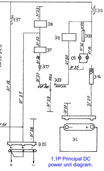

A big thanks to two members who emailed me with some of their thoughts on potential causes. My own (rough) understanding lead me to suspect a relay, which both the emails also included on the list of possible causes. To illustrate the relay position, the first pic is a snip from the wiring diagram that I have for the Yak-52. The relay in question is labelled "36" in the sketch.
With the help of the M-14P team I sourced a replacement relay, which was fitted today. It seems to have cured the problem. Holding thumbs that the problem stays cured.

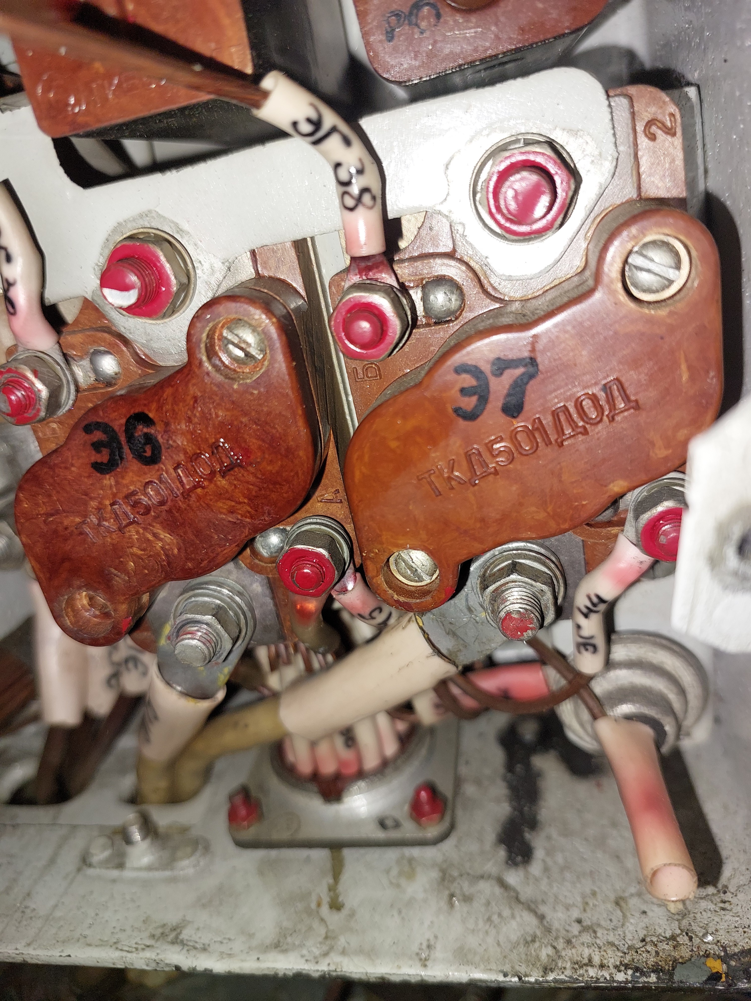

For reference, the relay is shown on the attached photo. The relay is located on the right hand side of the firewall, on the cockpit side of the bulkhead. Access is via the panel on the right hand side. Access requires removal of a cover over the fuses and realys. The pic is taken looking forward.
You'll see that the relay (36) is directly next to another one (37). Relay 37 is, according to my undertsanding, used for switching in external ground power. I'm told that the relays are identical, and that I could have considered simply swapping the two as a check. A quick check with a multimeter suggested that relay 36 was fauly, so I didn't make extra work by doing a swap. But it would have been an option, particularly because I have used external power once in the 20 years I have owned the aircraft.
