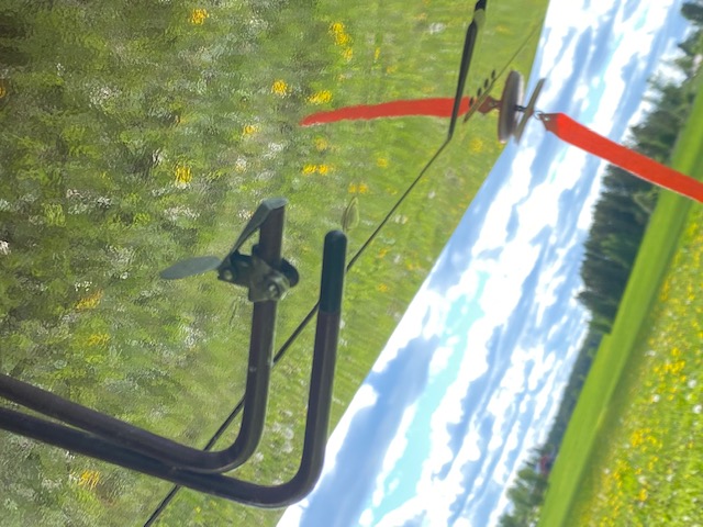

I have used a modified Cessna pitot cover over fuel vents since 2007 when parked inside or out (its not covering those little pressure holes).
Insects may cause accidents, but also if they happen to lay eggs to your tubes - a hermit wasp´s nest is also a known killer.

PostPosted: Tue May 30, 2023 5:59 am    Post subject: Filter on the fuel vent Reply with quote
Fuel vent cover
[img]cid:part1.mVUs4TOc.OFsl4ODb(at)rwm.fi[/img]
Pitot cover, opens automatic when over 20 kts

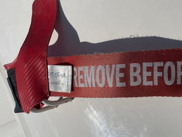

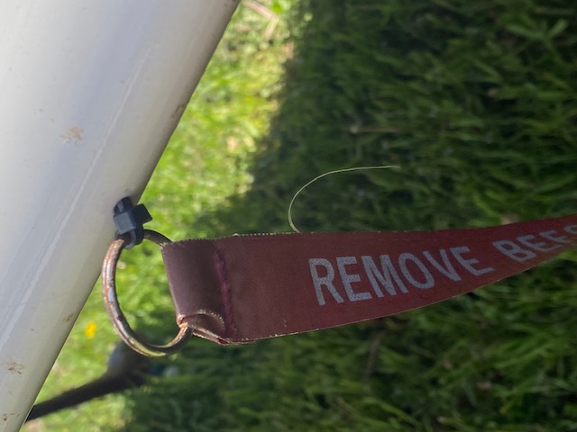

PostPosted: Tue May 30, 2023 9:36 am    Post subject: Filter on the fuel vent Reply with quote
Alan,
The POH annual Europa Inspection requiring draining and flushing of the tank should suffice per the POH checklist I would think. The fuel tank vent tube operation and FOD clearance is an issue missed by many in their preflight and periodic maintenance.
I personally went to an under-fuselage vent tube with hole under the belly that is also drilled on the aft side as per the instructions to allow over-boarding of the fuel when topped off and prevent a direct hit of a bug from completely clogging the tube in flight.
IF gas pours out of the vent when topping off as I designed it, it is therefore checked as clear if the fuel drains out.
When parked, I simply cover the vent with a "REMOVE BEFORE FLIGHT" banner cover when hangered. This is a pain if the aircraft is left tied down on the ramp as the cover I have is not as tight as it should be and blows off easily. It is my own fault for not installing a 1/4-inch vinyl hose in the sleeve of the cover for a firm grip. Same problem with the pitot/static cover. I must get around to that!
Those with vents on the top are well advised to use a loop of 1/4 inch fuel or vent line with a "REMOVE BEFORE FLIGHT" flag attached in the center. This loop of fuel line simply caps both lines on the older by the book vent system preventing clogging.
See the articles on the Europa Club website for checklist ideas. It is an experimental aircraft and frankly, as an experimental, some of us never stop experimenting or finding ways to do things differently and sometimes better.
Best Regards,

PostPosted: Tue May 30, 2023 3:18 pm    Post subject: Filter on the fuel vent Reply with quote
I had a flippy vent cover on my savannah.  Accidentally hit it with my shoulder on pre flight and didn't notice.  Since it took off at about 30mph by the time I noticed the lack of airspeed we were almost in the air so I decided to deal with the problem in the air.  I was surprised how easy it was to fly without airspeed.  Uneventful circuit to land.
So flippy covers not for me after that
