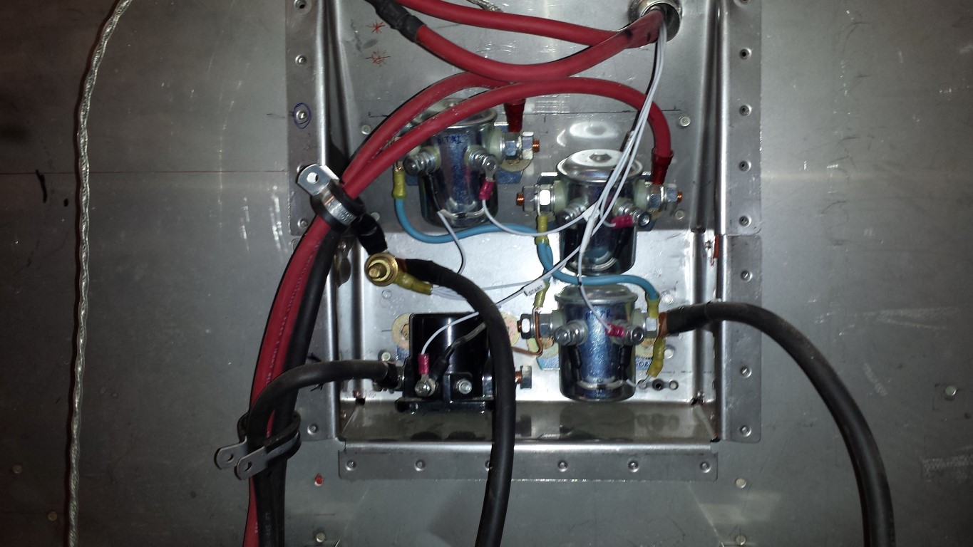

That's what I did. I confess to using a pair of off-the-shelf Denso internally regulated alternators, with the OV protection on a pair of continuous duty contactors on the firewall. The blue wires in the pic are actually 12awg fusible link wire, doing double duty as interconnects and protection for the 8awg B leads (~2 foot runs).
Needless to say, I'm a big fan of using links.
Charlie
me too . . .
