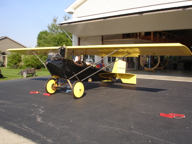

Dan Helsper's Piet has a similar dark fuselage/light wings scheme.

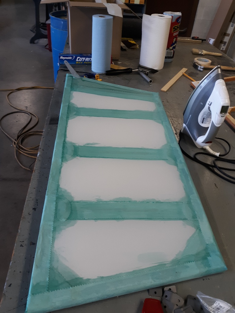

PostPosted: Thu Jun 04, 2020 4:17 pm    Post subject: Re: Ragwing Ultra-Piet Reply with quote
after a busy couple of weeks i got to spend a good part of today in the shop. I got a lot of the reinforcement patches on the horizontal stab. and did quite a bit of edge taping. I think the vertical fin is ready for paint now

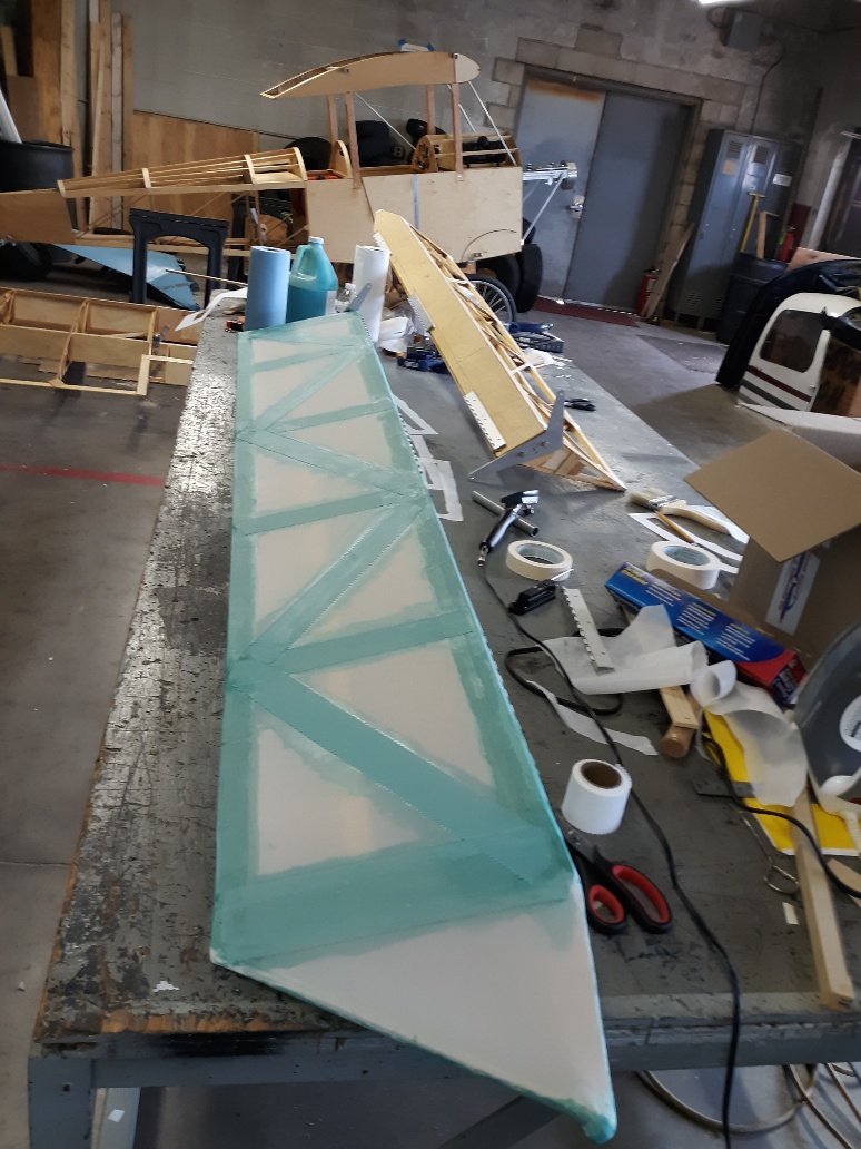

still plugging away on getting the tail feathers covered, I got fabric on one of the elevators and finished the reinforcement patches on the horizontal stab.

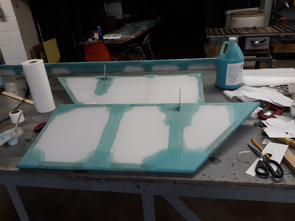

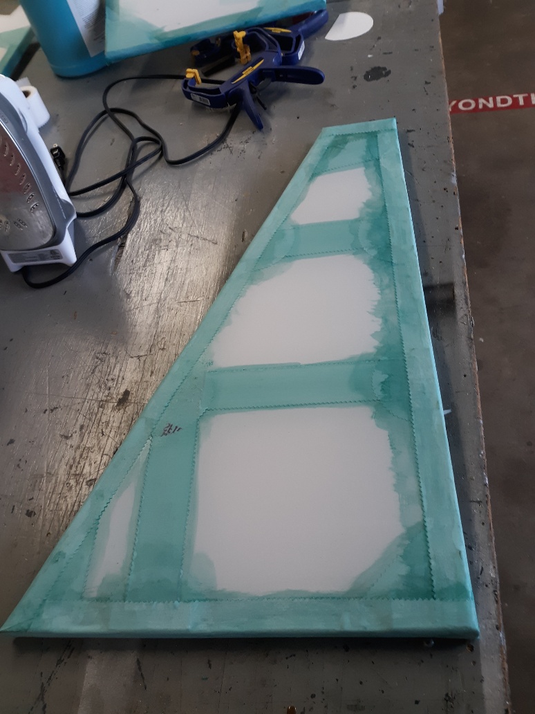

PostPosted: Tue Jun 09, 2020 6:14 pm    Post subject: Re: Ragwing Ultra-Piet Reply with quote

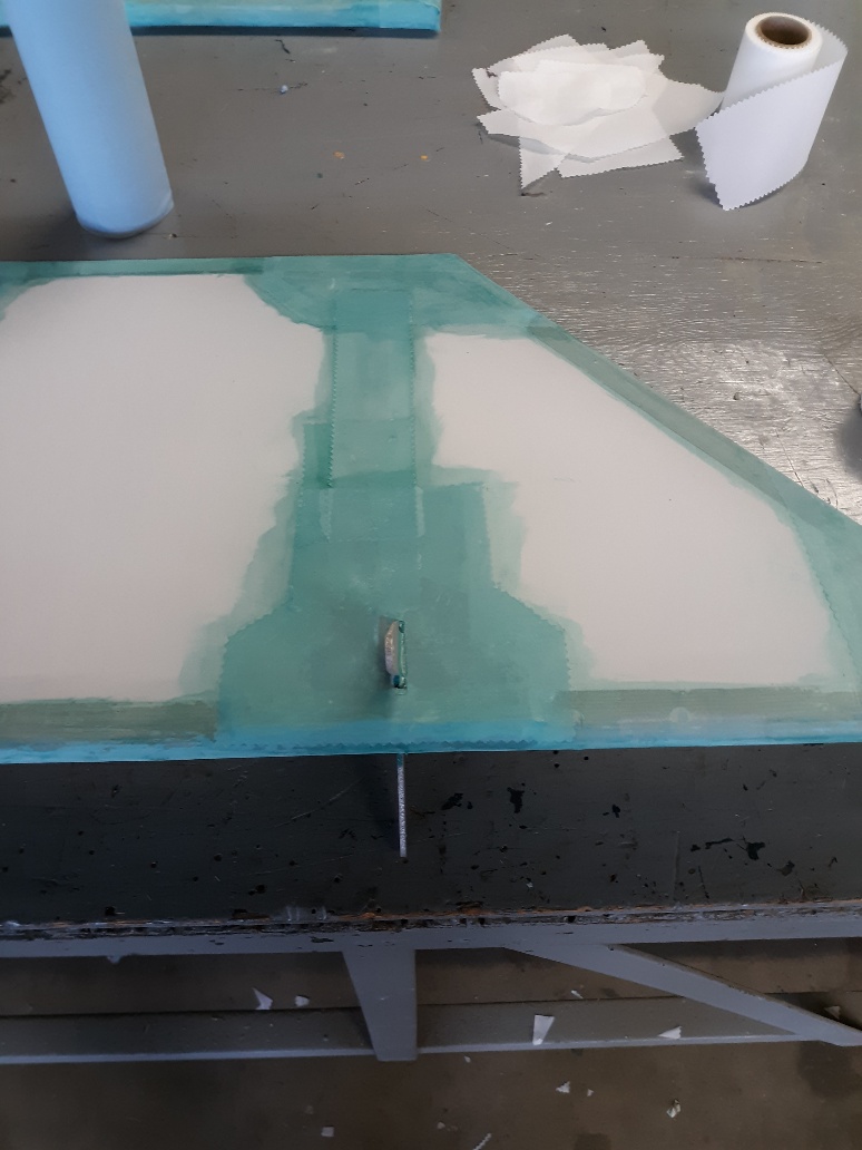

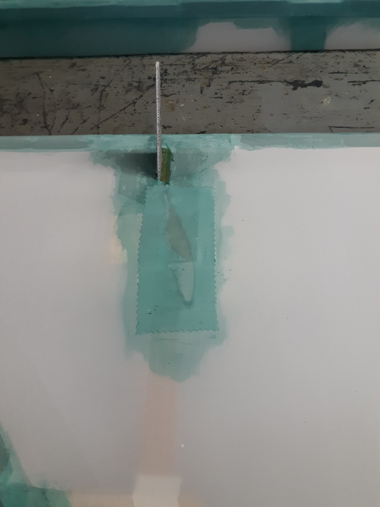

more progress on the fabric work. covered the other elevator and did more tape and reinforcement patching.
but the slit i cut for the control horn opened more when I shrunk the fabric. I patched it but undecided if I want to leave it or start over. There is another reinforcement patch that goes over that area and a tape so it may not be too bad, but it is on the top of the elevator (of course) What would you all do?

PostPosted: Tue Jun 09, 2020 7:38 pm    Post subject: Re: Ragwing Ultra-Piet Reply with quote
I think I would just apply a neat patch and keep moving.

PostPosted: Wed Jun 10, 2020 4:34 pm    Post subject: Re: Ragwing Ultra-Piet Reply with quote
I went ahead and put the tapes and patches on. It isn't too bad, I really wish it had been on the bottom instead of the top though. But it is an amateur fabric job and since it is my first attempt at doing it it isn't half bad looking. I may leave it for now and see how much fabric and ecobond I have left when the job is complete do decide if i want to redo it or not.

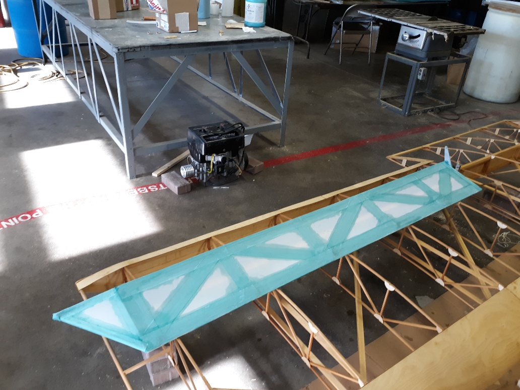

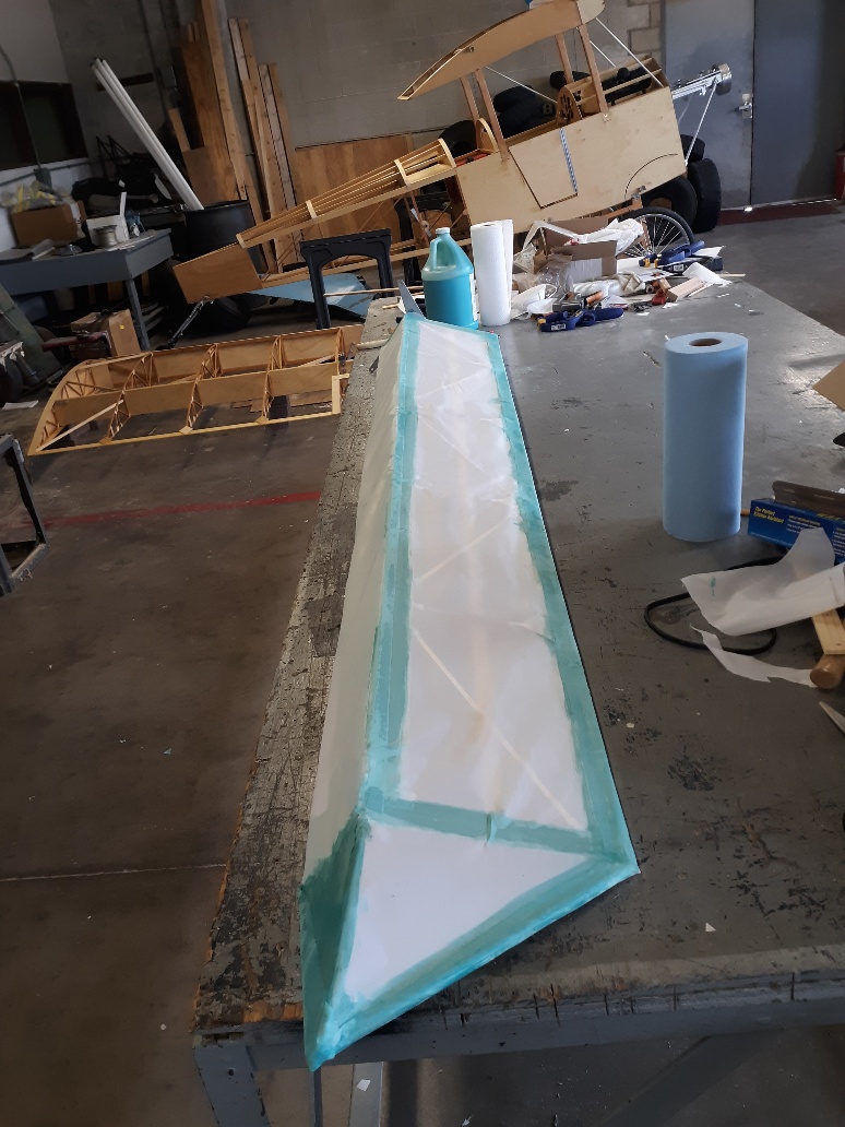

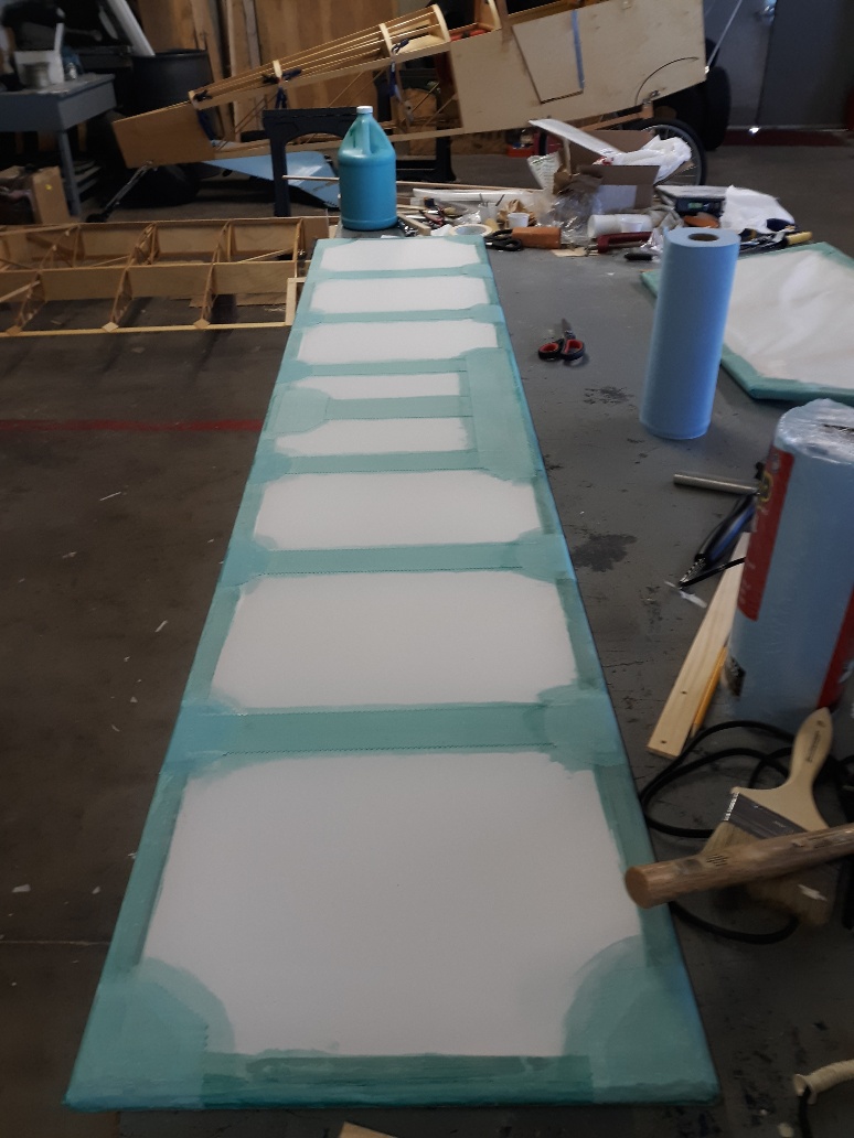

PostPosted: Fri Jul 31, 2020 6:39 pm    Post subject: Re: Ragwing Ultra-Piet Reply with quote

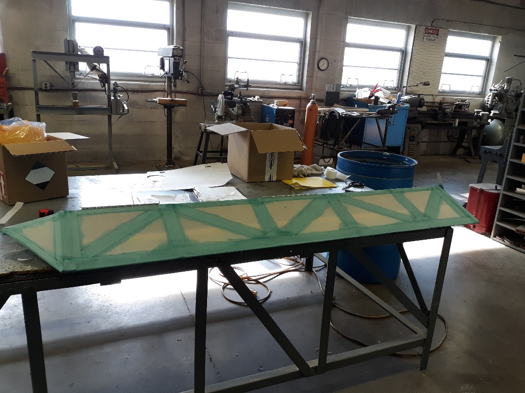

The tapes are finished on the ailerons and they are ready for painting now.
next up I will try to tackle one of the wings.
