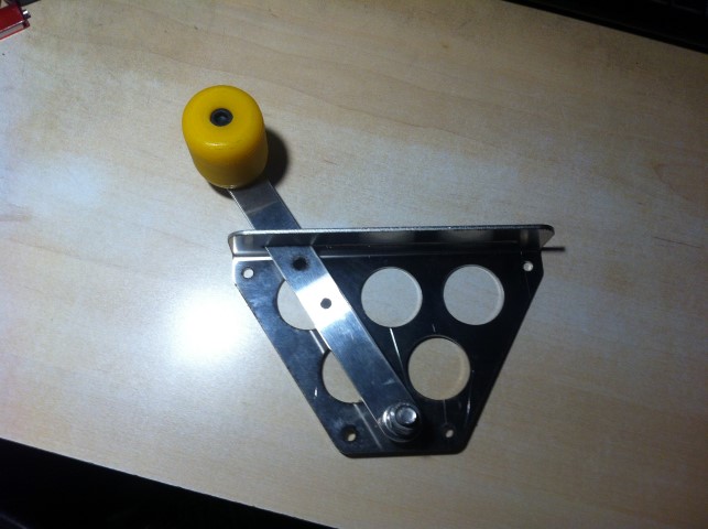

Hi Oscar
I made my throttle levers as in the picture. Front and rear are identical, connected with solid rod. A bowden cable, actually marine throttle or gearshift linkage, runs from the rear lever to the carb, inside wall of the cockpits. The size of the bowden is the same as the piper's, but since it is marine, it is all in stainless steel.
Cheers
Semih Oksay, Istanbul, Turkey (Now in Orlando,Fl)

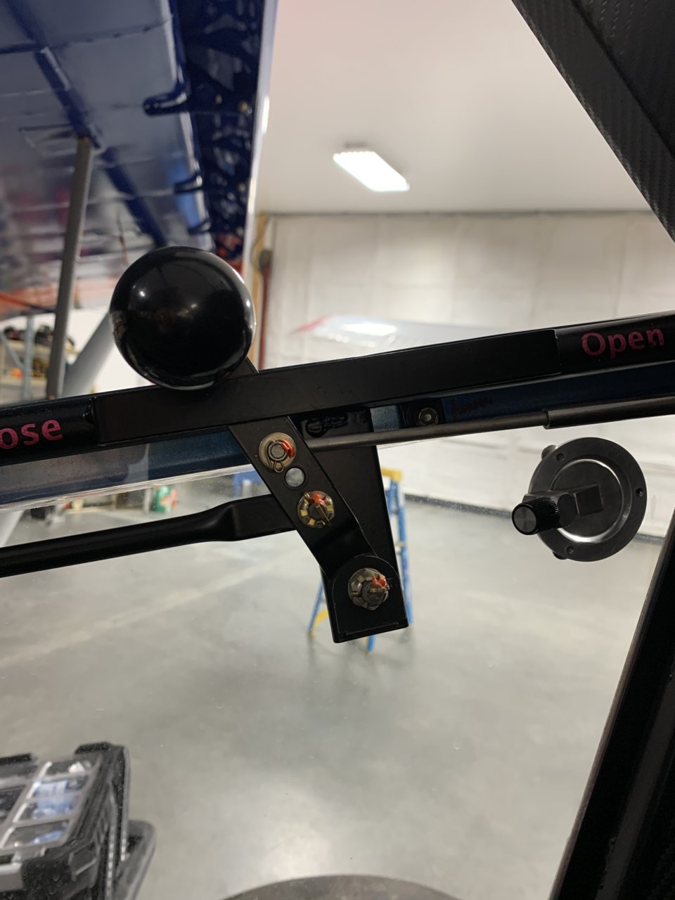

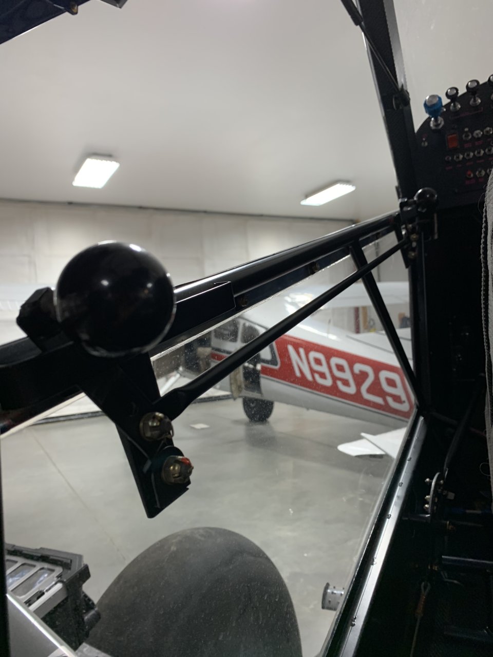

Semih, was there a particular reason you ran your Bowden cable from the rear throttle lever instead of the front lever?

PostPosted: Thu Dec 12, 2019 11:40 am    Post subject: Re: throttle setup Reply with quote
Todd,
I know that you wrote this a while back, but since nobody has answered your question, I thought that I would chime in.
If (God forbid) your throttle cable came loose from the throttle handle in the rear, what would you be able to do to control the throttle? Not easily, but I think that you stand a chance of being able to move the throttle cable enough while loose to make an emergency landing.
If it disconnects from the throttle in the front seat, what you can you do about it from the rear? Not a blessed thing.
At least that is my reasoning for attaching the cable directly to the rear throttle.

PostPosted: Thu Dec 12, 2019 8:32 pm    Post subject: Re: throttle setup Reply with quote
Well now Terry, that makes a heck of a lot of sense! It also makes it possible to disconnect (or remove) the throttle from the front cockpit along with the stick, if they are constructed to be removed, without disturbing the pilot's operation of the throttle. This is sometimes useful when you are giving rides and don't want anyone working the controls who shouldn't be, and also removes some obstacles that passengers sometimes have to work around while climbing in and out.

PostPosted: Fri Dec 13, 2019 3:51 am    Post subject: Re: throttle setup Reply with quote
Well I'm not sold on that configuration but that's the beauty of E-AB, each builder gets to decide on things like this. I much prefer the setup that most tandem seat aircraft use which is a rod linkage between the throttle levers and a cable from the front lever to the carb (and I get that most are soloed from the front seat). The attached pics are of a J3 Cub (the 2nd one is a close up of the front throttle). Using proper construction procedures I feel the risk of a disconnect as you describe is minimal. Plus trying to manipulate a broken cable as suggested and fly the plane is going to be difficult at best. I'd rather fly to a suitable airport/field, set up for an approach and kill the engine by shutting the fuel off once the landing is assured. YMMV....

PostPosted: Mon Dec 16, 2019 3:12 pm    Post subject: Re: throttle setup Reply with quote
Todd,
Your plan to kill the engine and deadstick it in is a good one - provided the cable did not come loose when you were at idle or a reduced power setting. Then your likelihood of getting to anywhere but what is directly below you is greatly diminished if you can't reach the throttle cable. I did not say that my plan was optimal, but it does give you a chance to do what you said, adjust the cable to full forward throttle, fly to a field, cutoff the engine and deadstick it in.
But as you said, it is experimental aviation, and you can build your airplane any way that you see fit. I am just encouraging you from a risk management standpoint to rethink where you will connect your throttle cable.
